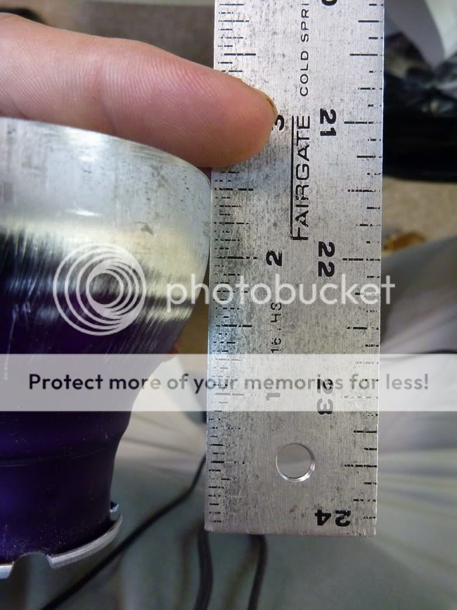

Next, I added the burner holes. The domed bottom of the bottle sits 1/2" above the surface it's on and the inverted top of the bottle sits on top of that. I decided to place the burner holes at 2" up the side of the stove. That means they are in line with the 1 1/2" mark here- not too low that alcohol dribbles out easily and not too high that they're blocked off.

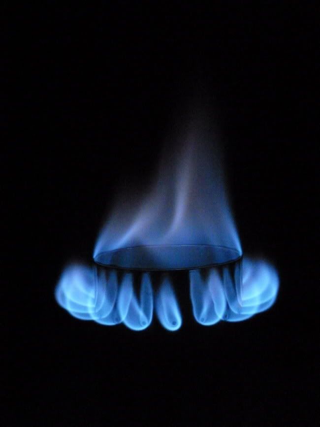

I did an inaugural burn with denatured alcohol and it bloomed wonderfully, albeit slowly. I think that I will add some fiberglass priming wick soon.
I then took it outside for some testing. Stove weight is a mere 45.2g. Ambient temperature was 59F and initial water temperature was also 59F. I fueled the stove with 2oz of SLX denatured alcohol. Once bloomed, I put on a 7" MSR blacklite pot with 3 cups of water in it and with the lid on. The water came to a rolling boil at 5:32. Total burn time was 14:29, so I had used quite some excess alcohol.
Here's another shot of a bloom once it got dark out:
