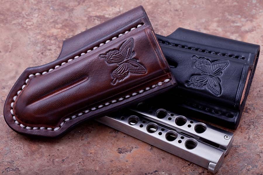

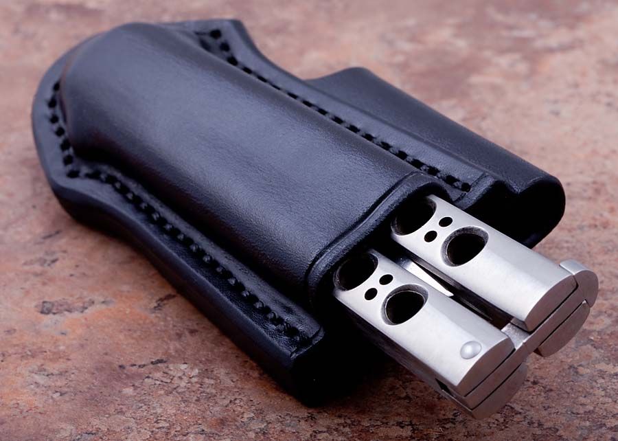

a bare top sectioned bali sheath, first one I've done like that and it does
look pretty nice plain as that too;

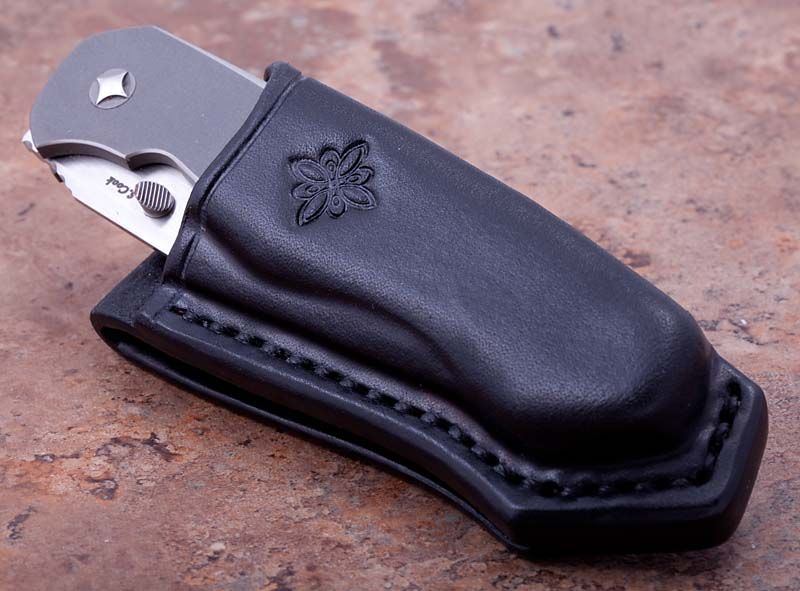

a vertical sheath for a nice Scott Cook Lochsa folder;
Made two for this one, the pivot down was causing some rub marks and the
thumbstud sticks out far and digs into the sheath, the sheath above works
quite a bit better, but you lose the lanyard portion;

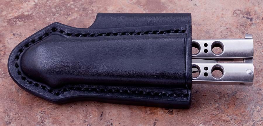

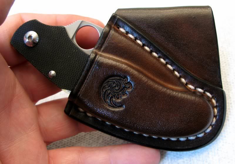

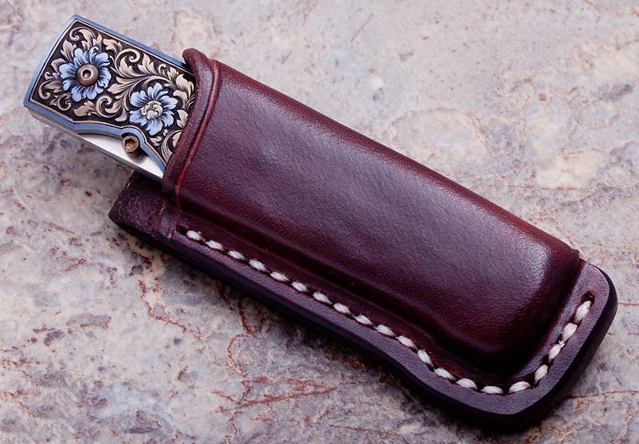

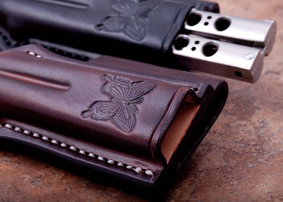

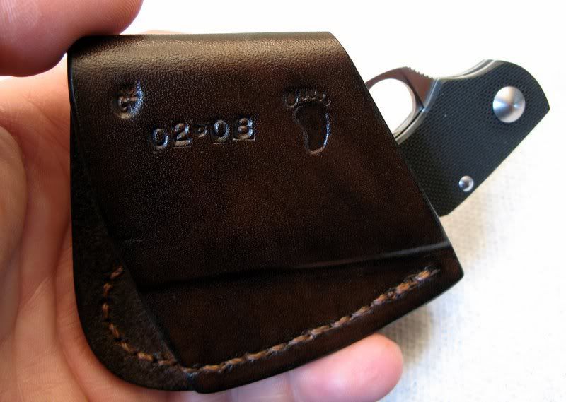

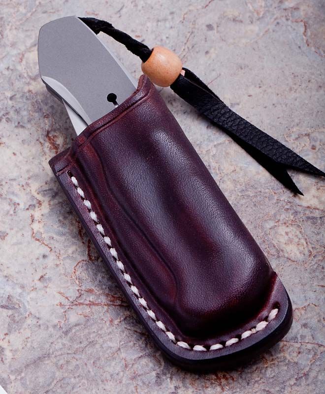

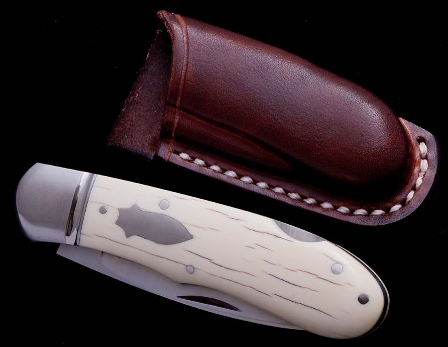

Hi Bill, those are long gone, but here is what the vertical sheaths look like
and a shot of one of the horizontals, these get an extra layer of leather between the knife
and the back section that becomes the belt loop, adds a bit of rigidity to the overall sheath.
