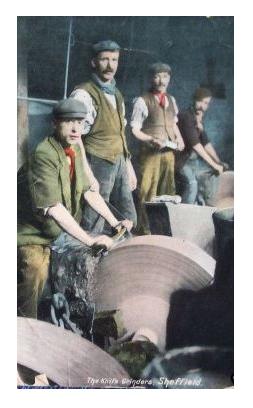

So back in the day of production slippies and waterwheels for power assuming this was before discs or belt grinders were all knives hollow ground on a large diameter wheel or if some of these oldies were flat ground how did they do it? Side of a large round waterstone? Just questions I wonder about.
Ken.
I have seen old paintings and photos of Sheffield cutlers using stones 4-5' in diameter. That would give a pretty flat arc given the width of a knife blade.
Yes, those stones were large enough that the grinders would lay forward on their chest on a platform over the stones to get into a good working position where they could more easily apply pressure to the blades against the stones. There is also the matter that the blades they were grinding were typically forged more or less to shape -- they didn't have to take off a whole lot typically (that would be wasting precious high quality steel after all). When they actually wanted to "flatten" the grind they would position the blade parallel to the wheel, rather than across the wheel (I think this sort of flattening was much more typically done with things like saws). By parallel, I still mean on the face of the wheel, just along it, not across it (not on the side of the wheel - never heard of that being used).

I think tom is right, the stones were so big that it looks like they were flat ground, I don't think they would have ground on the side of the stone.
Those stones look to be 5-6'
^^^That's a great pic Tom
In the book "Back to the Grindstone" Herbert Housley says the main grindstones were 60" in diameter, and that they lasted about 10 months.
Mick
The pic in post #6 alone was worth starting this thread!

Those grinders were pretty tough fellows, not only did they often work in wet cold conditions, live with the threat of being killed or maimed if a wheel burst/exploded, inhale dust, grit and metal particles, live to 35-40 if they were lucky, they also had to put up with the "grinders count", the numbers of articles ground for every dozen they were paid for, usually fourteen, this was said to cover wasters, but was actually an imposition of the factor upon the grinder. :(
When a grindstone wore down, it was sold on to be used by other grinders making different sorts of cutlery, when it then could be no longer used for grinding being too small, the stone was known as a "grindle cowk", and could be used for making stepping stones, river bank facings, hearths etc.
