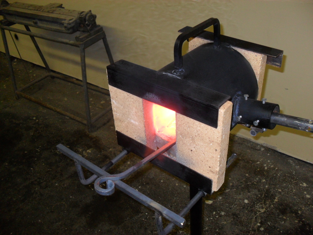

I was thinking about this one, but I read some reviews that said its design was very inefficient and lost a lot of heat out of both ends.

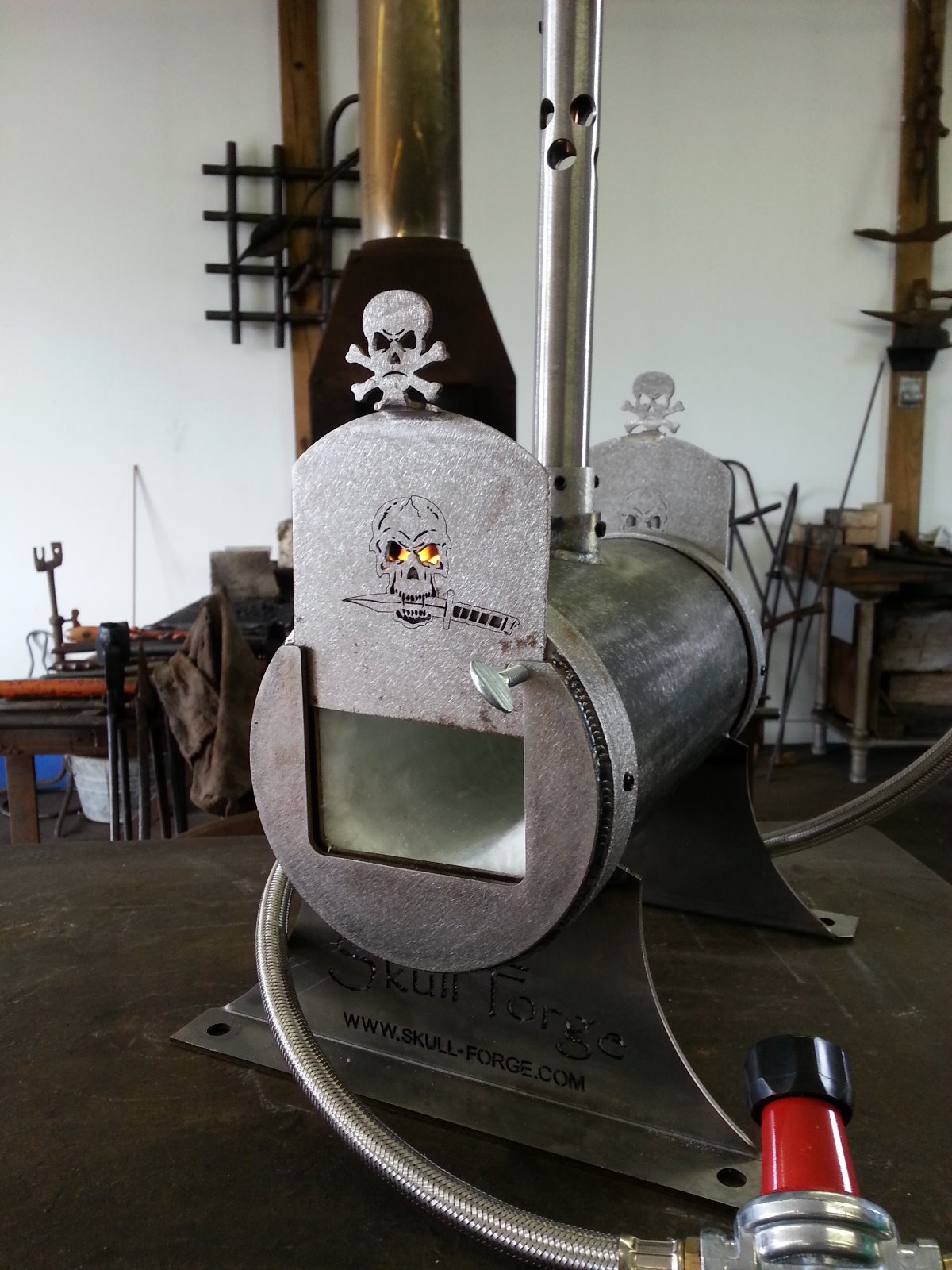

Here is the one I went with from ebay. I liked the sliding fire bricks on the end, and the fact that the body is .250 thick. Here is its picture:
One thing that isn't shown is the interior. If it is unlined, like the first one, it is not good. You need to apply a 1/4" layer of stannite over the wool, and after curing it, a thin coating of ITC-100. Running a forge with a bare wool blanket is not a good idea for several reasons.
That Skullforge appears no hard floor material ? Non insulated steel plate doors?? Energy lost & how long do they last before warping or just scaling away ?
Would need see more detail, but it might be a pita for relining too when that time comes.
