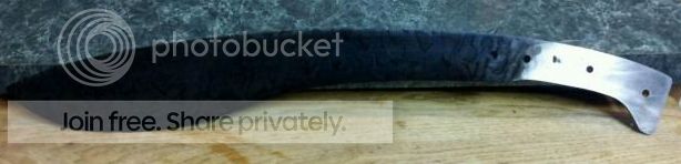

Its possible but probably not provable however I too wanted to forge out a kukri machete and after several years of forging behind me I did make one. 5160 is the way to go and I also did not want to use the trip hammer so going old school arm and hammer baby I was left with this and some wore out arms 6 hours after I started! Lots of work and had to use everything I knew to make it a success. I could not have pulled this off when I just started but that does not mean you cant. Just a little insight into whats involved.
