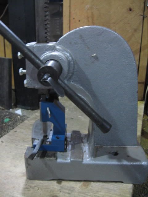

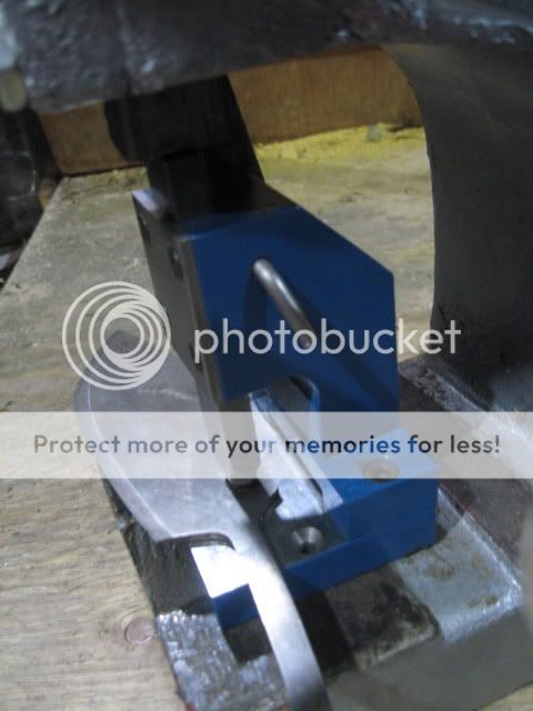

Another option that would most likely look better and be easier for you is to talk to an engraving company. They set it up and it looks good. No muss, no fuss, no double stamps!! What I did for my first knife:
If you do go with the regular stamps, I suggest an arbour press if possible to prevent bounce and double stamping. With an actual holder and arbour press it looks like this:
I know some just use the stamp, vice grips and a hammer, but I got a lot of double stamps that way so found the arbour press.
