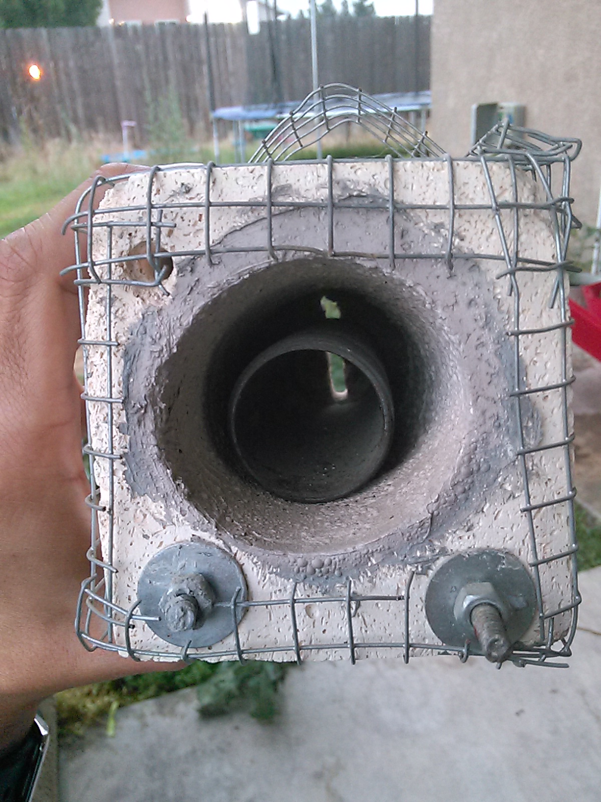

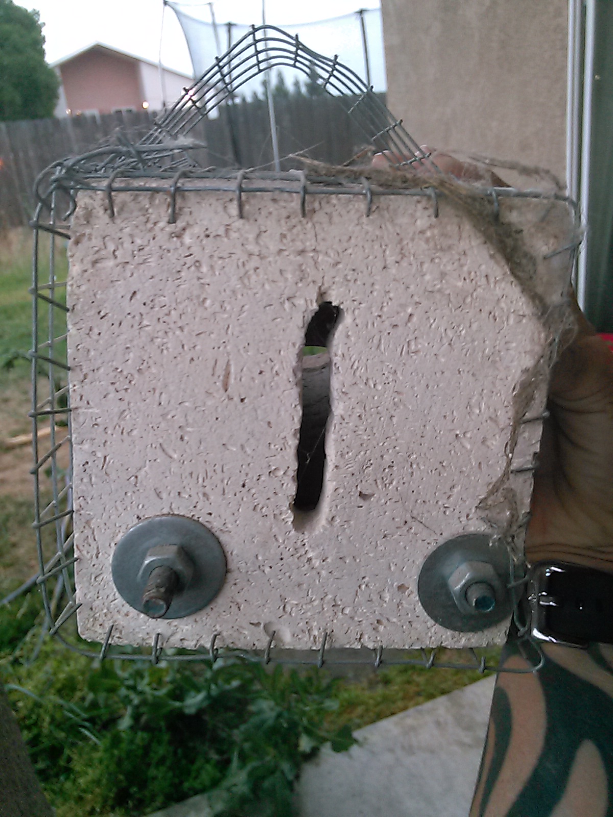

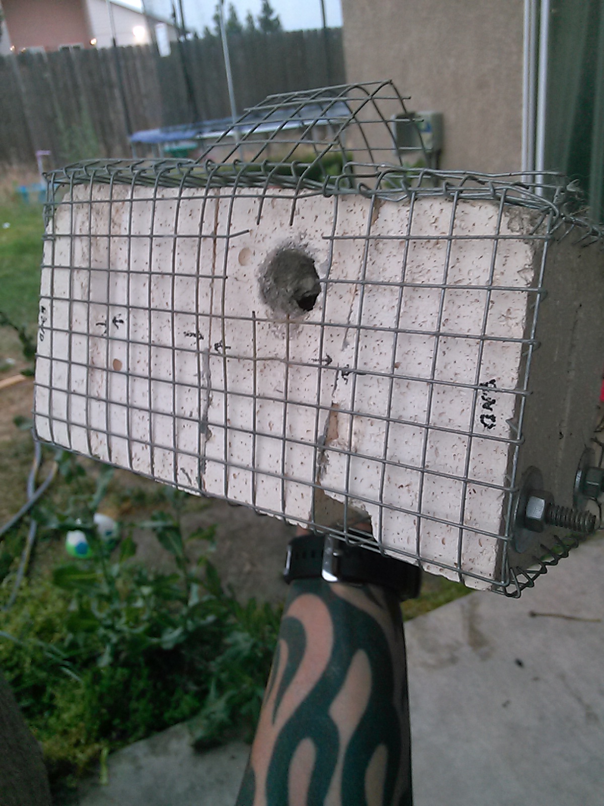

Now that you've got me all thinking about it I grabbed my forge. I'd forgotten two key things about it.
1. It's more like the crackhead cousin of the Atlas Forge.
2. Somehow I forgot that I only secured two corners.
Here you can see the pipe nipple that I use as a muffle to keep the considerable heat as evenly distributed as possible (a very good idea!).
In this pic you can see the odd brick shape and my desperate attempt to keep them mostly lined up with sharpie.
Port on the end. (I don't suggest the spider webs.)
I kept the round brick that came out of the center cuts to use as a plug, but they are entirely unnecessary with my burner.
