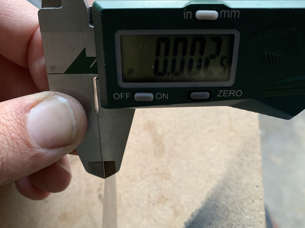

I understand if a knife is too thin BTE, the edge can be chipped when too much lateral force is applied. But I feel many folding knives currently in the market are too thick BTE, e.g., most ZTs and regular Hinderer XM-18s. I think they all can be thinner BTE while still maintaining reasonable strength. For example, the gen 3 Hinderer Eklipse Bowie that I recently picked up is an exception. The blade still has the same thickness on the spine as the regular XM-18 but the BTE thickness is about the same as that of XM-18 3.5" Skinny Slicer.
Do many people really like a thick edge on a folding knife (again I am not talking about thick spine) or is it mainly because knife manufacturers want to reduce their warranty work?
Edit: added some drawings to show while the spine thickness and blade height do not change, there could be quite different grinds of the blade and hence different slicing/cutting performance.

I don’t quite get it. You are listing the thickness of the spine of the knife as an indication of the thickness behind the edge.
This doesn’t make any sense to me. You could take 10 PM2s and grind a full flat primary grind that has a different thickness behind the edge on each one. One has nothing to do with the other.
The only way to know if they have the same thickness at the edge is to measure it, not guess at it.
