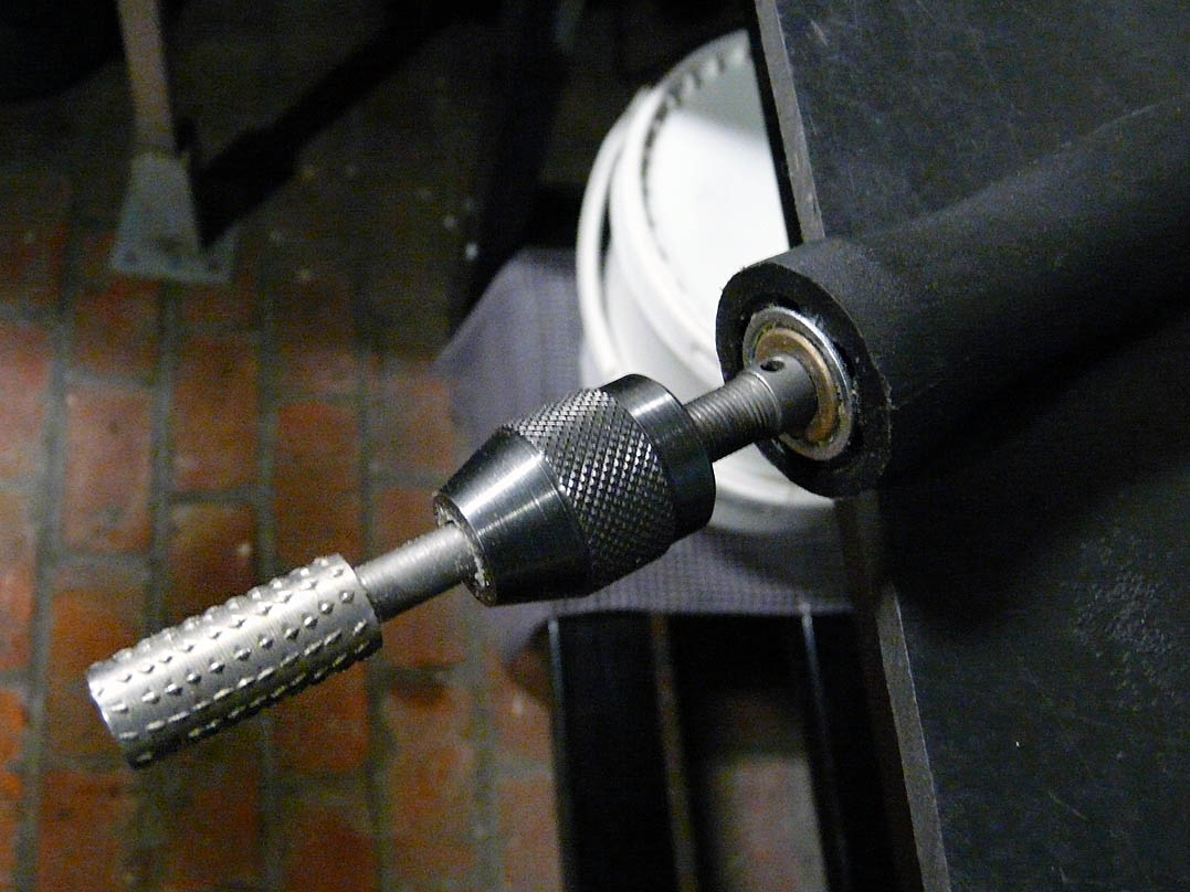

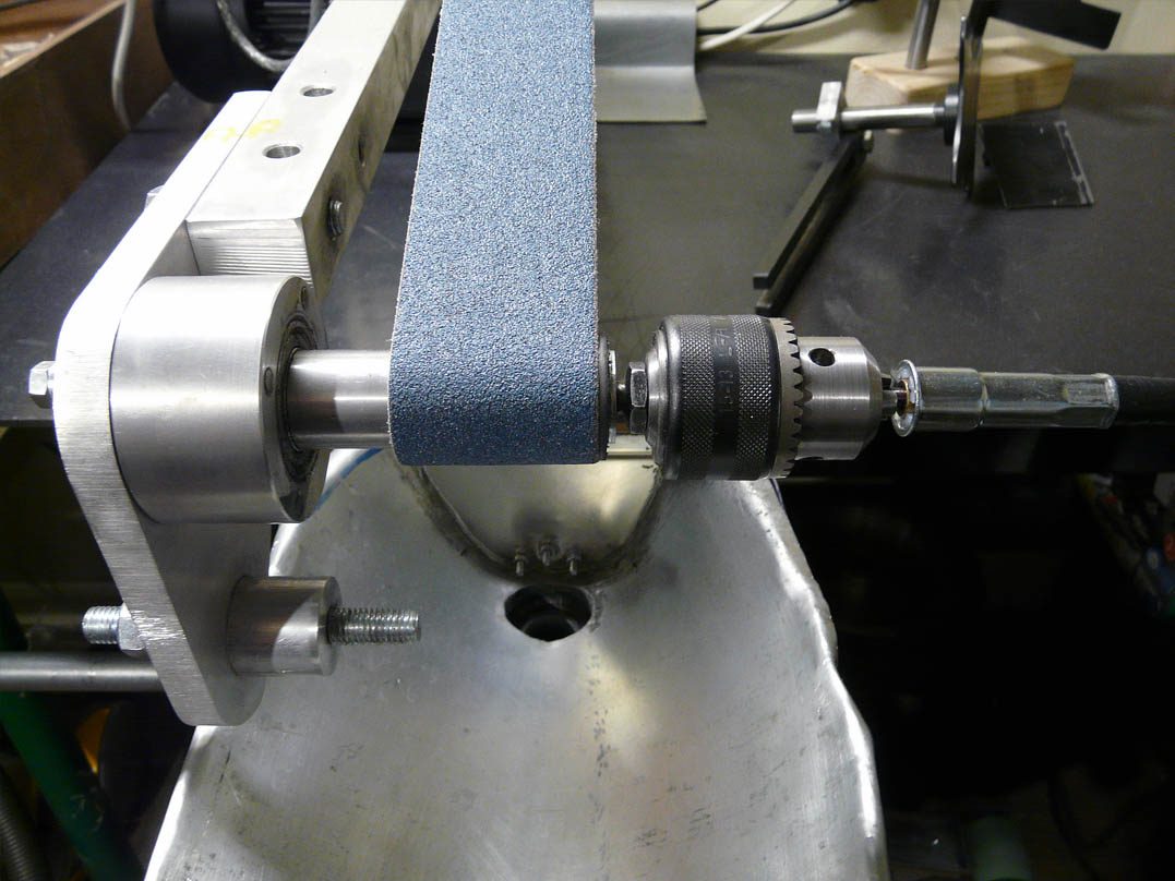

I was tired of the low power of my dremel clone, it kept stalling even with light pressure. The 100W just doesn't cut it for rougher jobs.
So I started looking for a more powerful version, but other alternatives were either expensive or still low powered.

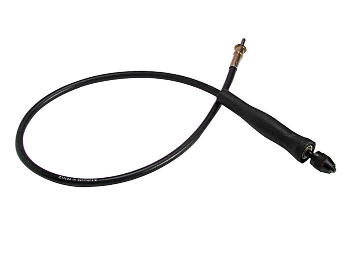

While looking around in the local DIY shop I saw a flexible drill extension and thought to myself, why don't I attach that to my belt grinder...

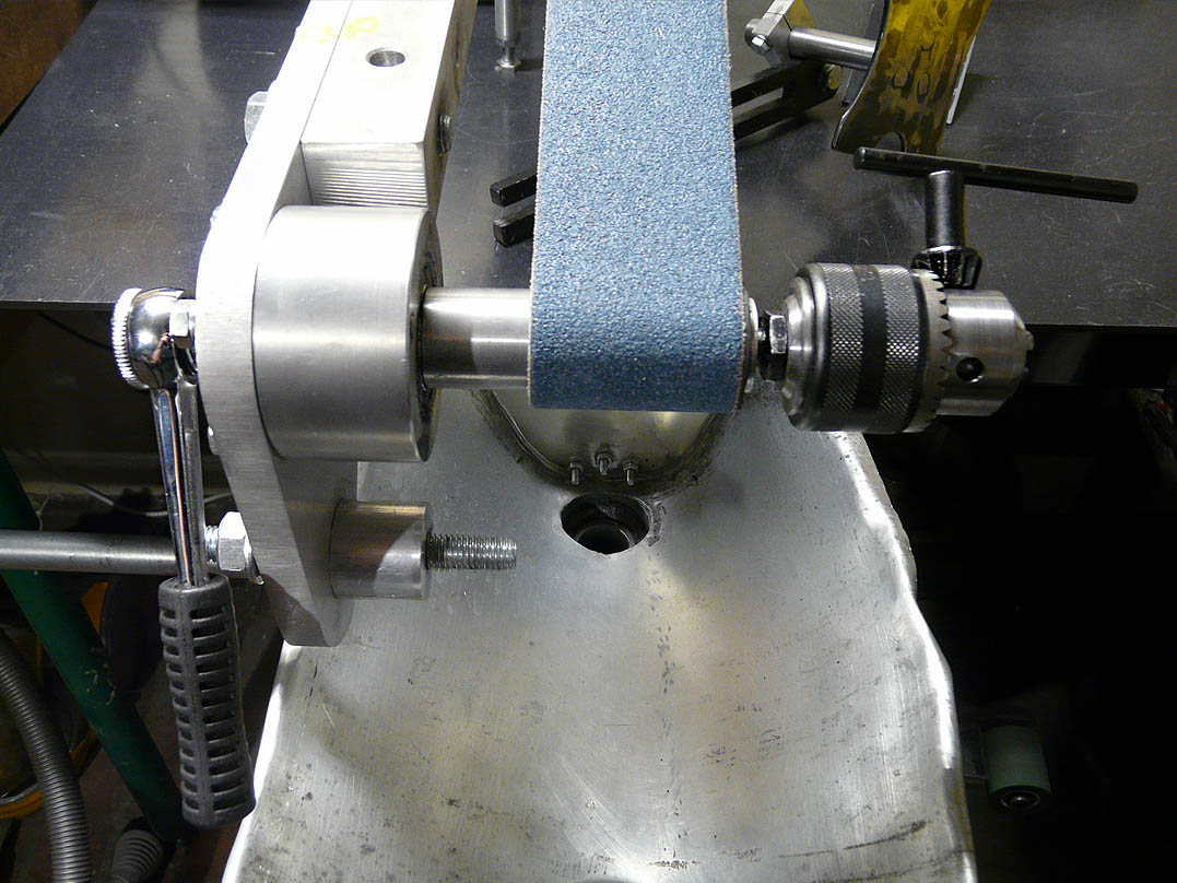

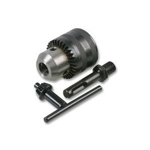

So I bought the extension and an SDS chuck so I could fit it onto my multiwheel grinding head.

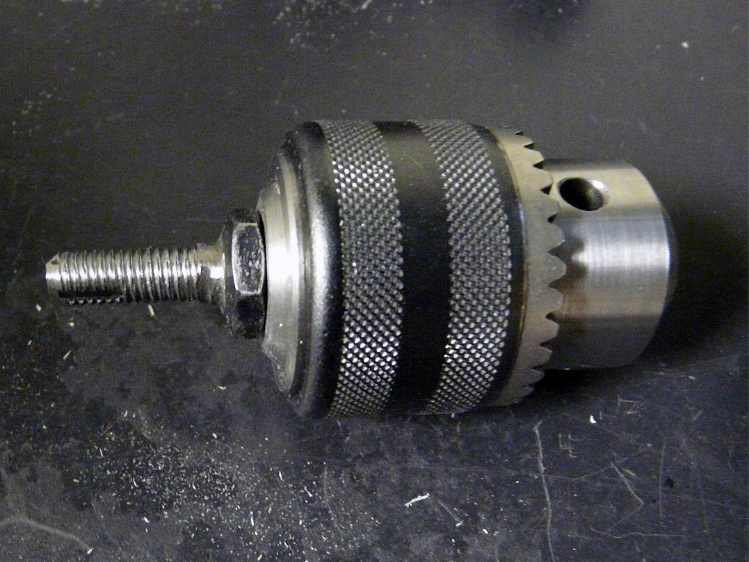

The contact wheels on the Aly maxi grinder are kept on with a small bolt roughly the imperial equivalent of a metric m8. Replacing that bolt with the SDS chuck would allow me to use the extension as a dremel flexi shaft. I didn't have an imperial tap & die set though so I tapped the hole and threaded the bolt to m8.
Next the SDS adapter needed to be m8 as well so I ground it down until it was about the same diameter as the bolt and threaded that as well. I wasn't able to get it perfectly straight unfortunately so it wobbles a bit while spinning, a lathe would have come in handy there. Putting it in the drill press would have damaged the threads on the other side, while the nut was too big to chuck up. :rolleyes:

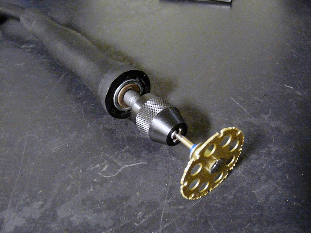

So all I needed to do now was switch the grinding head bolt for the chuck and attach the extension.
It can take shafts up to 6mm so I can use dremel bits or larger ones like a rotary rasp.

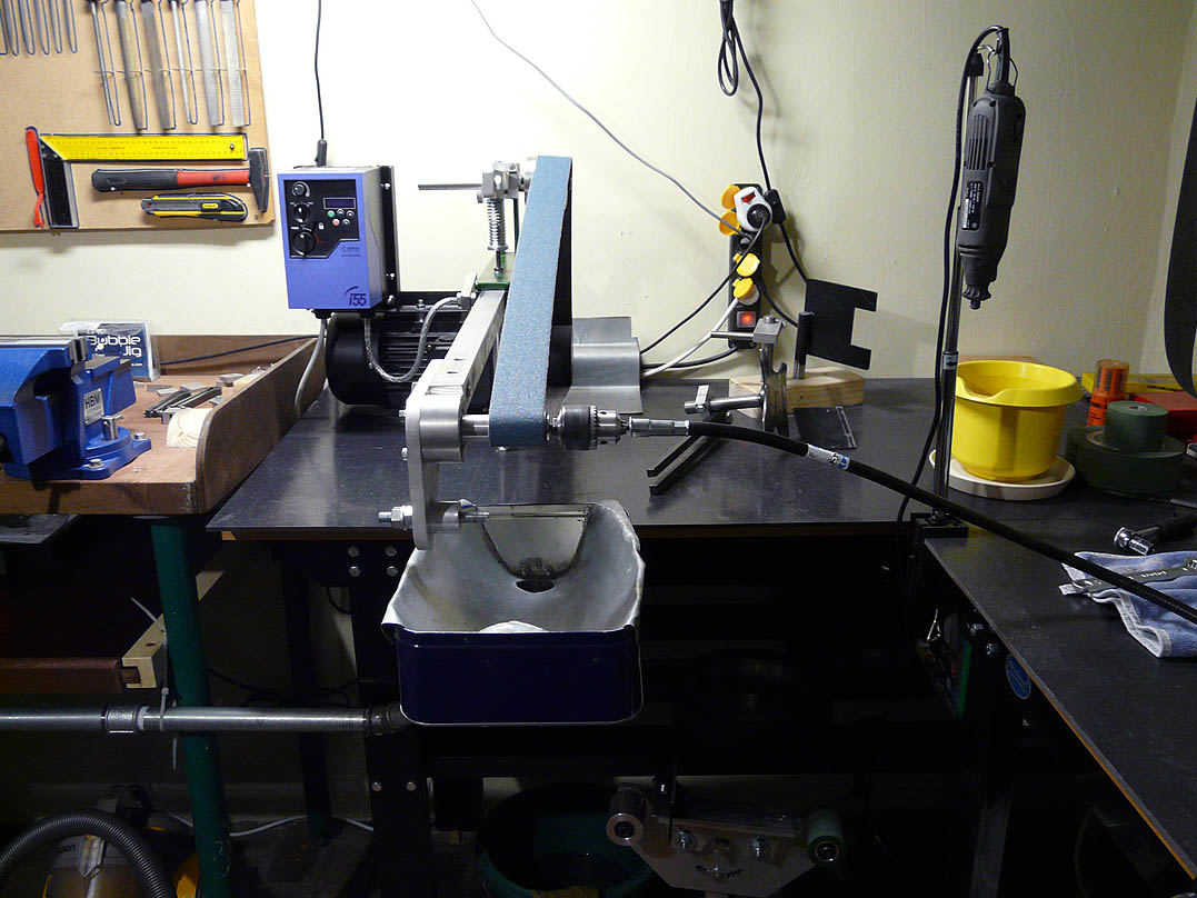

I've got Aly's direct drive maxi grinder so at 100 hz the motor spins at 2850rpm (Aly and the grinders he makes can be found on British Blades btw). With the 4" drive wheel, speed settings are easiest to read when using the 35mm contact wheel on the grinding head. This gives me a max speed of 9818 rpm which makes 1 hz just a tad less than 100rpm. This extension can only handle 3600rpm though so 36 hz is the maximum safe speed, but if I can find a way to attach the dremel flexi shaft, I could go up to 100 hz no problem.
So what I ended up with was a 1500 Watt variable speed dremel. There are a few flaws of course, such as portability :rolleyes: and a lower maximum speed, but overall it works quite well and I very much doubt I'll be able to stall this. :P

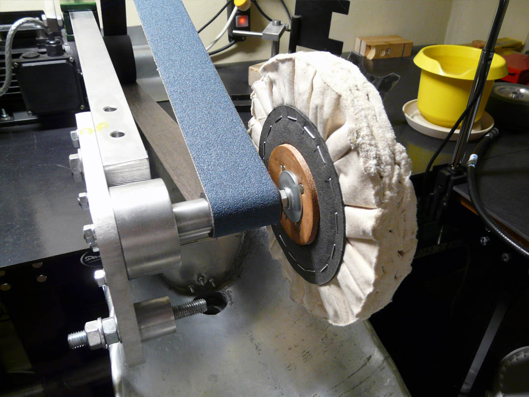

I also got the suggestion to put a polishing mop on there by FGYT on BB, making it even more versatile. :) I already have a 1 horse buffer with 8" mops, but it has a fixed speed of 2950rpm so the vfd should be handy for more delicate things.
Has anyone else done anything similar?
That may be a pretty dangerous setup. The sheath isn't attached to anything, so when (not if) the core shaft kinks under the way powerful motor, whole thing will pull out of your hand and become the spinning whip of death. Hopefully the shaft will tear itself in half before too much damage or blood is drawn.
I'll be honest, If I was visiting your shop and you were going to use it while I was there, I would leave.
seems a little precarious. a 60 grit belt running unattended to run a drill chuck that is attached to a flex shaft for a dremel? It may work, but how safe?
Foredom tool is the way to go.
I was using a worn belt for 'safety', but apparantly I hadn't thought it through properly. It seems to me that even should the sheath be fixed to the grinder to prevent it from spinning, the power of the motor would still be too much and rip it out anyway. Using a different kind of drive belt, one that would slip more easily to limit the power might work, but I reckon it's not worth the gamble. I'd rather spend some more time than injure myself.

The extension I used was originally meant for a drill press, like the one you linked to.

Where things get iffy is the sheath. On a regular flex shaft tool, the sheath is attached to the motor frame. It is held rigidly in place and can't rotate. The shaft runs concentrically in the sheath and it does all the rotation. The shaft is greased with special lubricants, and kept away from the sheath walls by a spacer spring that acts like a flexible bushing.
Now, if you just attach the shaft, and don't secure the sheath, it will try to rotate. If the shaft is well greased and has a spacer, it will not impart much torque to the sheath, and your hand gripping the tool will be enough to resist it. However, most of these $20 flex shaft conversions have only a flexible shaft inside a flexible metal sheath with a rubber coating. They are only lubed with some cheap lithium grease. Thus, if one of two scenarios happen, the sheath will turn, and the whole tool can become a powered whip -
1) The tool attachment ( drill, sander,burr, etc) grabs while being used. This will stop the shaft from turning, and the shaft will try and twist into a knot. The sheath will jam with the shaft, and try and form a knot,too. The whole assembly can pull out of your hand and start spinning around until ( hopefully) the shaft breaks off and it stops spinning. The tool is ruined, and you probably need new pants.
2) You set the tool down to make an adjustment or inspection of what you are working on. Since the power source is a fixed machine, you decide to just let it run and the tool spins freely....no problem....until the friction of the shaft in the sheath starts to cause the sheath to turn, which makes the whole thing rotate, and then it twists ...and then it knots...and then you are in scenario 1, but with even less warning.
The more powerful the motor, the worse the problem will be. Just because the flexshaft says it is rated at 5000 RPM, does not mean it can be safely operated at 1HP....different things.
