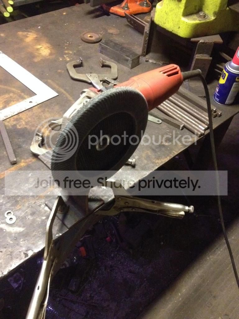

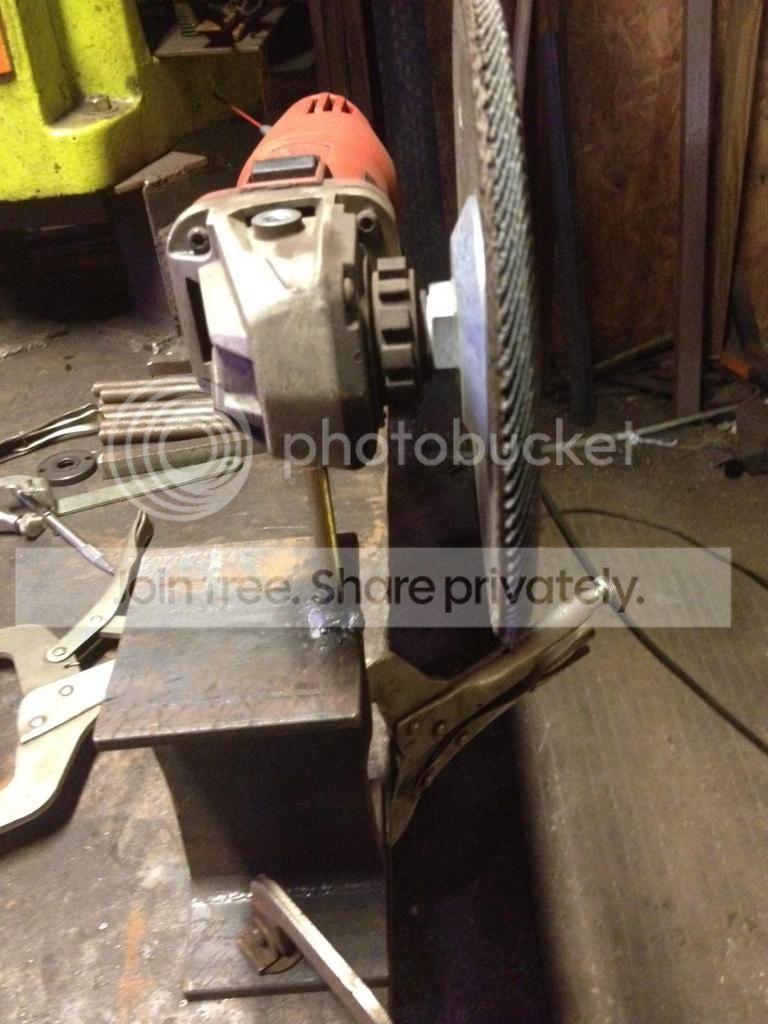

I built a grinder the other night that would cause most grinder aficionados vomit... cost me a 3" section of scrap I-beam and a 5/16th bolt.... and it works like a charm!!! :D

Think about that...the whole grinder is suspended on a 5/16" bolt. I can bend a 5/16" bolt in my hand. Glad you are being ingenuitive, but that looks like an accident waiting to happen.
OMG, I'm a safety guy by profession, and that will give me nightmares for a week, lol
It's a Grade 8 bolt, and the filler is 12018... There is also 2 nuts to ensure a tight connection.... I'm not an engineer by trade, but I'm pretty sure it'll hold true... :D
... pretty sure..... lol
While the weld deposit does take away from the sheer strength properties of the G8 hardware, there should be no such thing as catastrophic failure... that is unless someone takes a cross-peen to it while grinding. A safer means of fabrication would be drilling 5/16th through the section, threading the bolt through, and welding the bolt to the underside... better?, well maybe.
Take a 1/2" pipe and put over the bolt with it supporting grinder. This would provide a extra support - but just what size grinder is that anyway? A 4" disk? 7" disk? 10"?
A 4" isn't that hard to support.

It's a 4-1/2" with a 7" flap-wheel... Not a bad idea at all, because that 1/2" pipe would closely mimic the meat of the handle, which nobody second guesses when it comes to safety...
I'm a reckless guy by profession and that makes me uncomfortable to see also.
