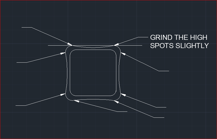

Mine is a slightly different design, and my tenioner is different. Here is my WIP.
I'm using 2" x 2" x 1/4" large tubes and 1 1/2" x 1 1/2" x 1/4" smaller tubes. You'll need to take a file and file down the seam weld on the inside of the larger tubes and it's a great fit. It's not hard, just do it before any welding a test. took me maybe 5 mins with a crappy 3/8" round rasp. I also took a 4 1/2" grinder and laid it completely flat and grinded the outside four sides of the smaller tube till all the mill scale was off the high spots (image below is dramatized of what the tubes actually come like. They aren't completely flat. I just knocked the high parts down some so it was a little looser for after paint. I have virtually no play and my parts slide in and out with ease.

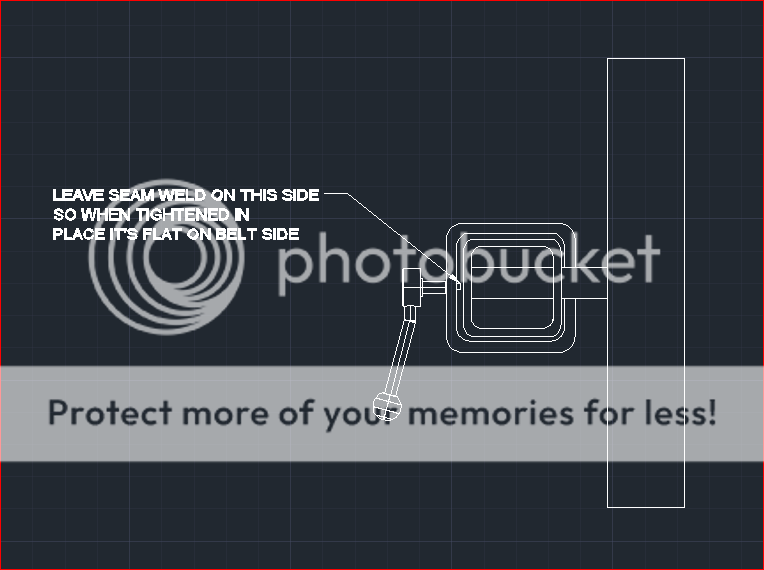

One more thing to note when you weld the main body parts together, make sure the seam weld is on the opposite side you want the belt that way when you tighten the tooling arms in place it tightens against the flat side and not the seam weld.

One of the problems with the builds with the tracking pillar style using 3/16 walled tubing is that there is some play in the fit of the 1.5" inside the 2". The guys seem to remedy that with plastic shims from milk jugs. Using thicker 1/4 walled tubing like you are doing might fix that problem too.
Thanks for the extra info about the fit. I understood about filing the weld seam down but I could see myself trying to slide it in afterwards and going, "$%^* this doesn't fit!" and taking a while to stumble across the idea of grinding a bit to knock down the high points.

I was over at princess auto checking out the fit of 3/16" walled hollow steel. There is a fair bit of play...about 1/8". Enough that I could fit the 1.5" tube inside the 2" tube without filing down the seam weld.
I think I will track down some 1/4" walled tubing and use it. Then I don't have to fiddle around trying to tighten the fit. Just a bit extra grinding/filing needed but I will get a good fit.
