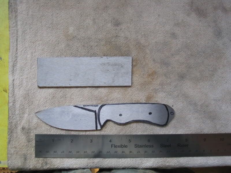

I have started grinding out blade blanks using my little 1x30 belt grinder. I am using 1 1/2" x 1/8" flat ground O-1. I lay my pattern out, scribe onto the steel and cut off any large excess with a hacksaw first. Then, I just grind away. I'm using a 60x grit Zirconia belt, made for grinding tool steel. I'm just starting out, but this setup seems to really work so far. The grinder cost me $65 Can. Here is a pic of my blank. Black lines are just some Sharpie marker ideas for handle etc.
http://i83.photobucket.com/albums/j290/mshell444/IMG_1071.jpg
Benchmade,
The blank looks good, but just a couple of small things. Your index finger groove looks a bit too sharp, and the belly looks like it's a little far north as well, if you catch my drift. Mind you, I'm going off of the assumption that this is a 3-finger knife, maybe about 6 or 7 inches overall. If you haven't already, pull the guard off of the top of the grinder to expose the top barrell. This will open your world to enormous possiblities! French curves, here you come!
Edit - OK, just looked at the photo again, and it's 8 inches.....With where things stand right now, I'd still move the belly a bit, but I'd also give up a little more of the blade from where you're at, to macke sure you can comfortably get your hand on it. Reshaping the butt to do away with the exposed thong hole isn't an option right now, but with your next one, you might consider putting it in the upper corner so you can still maximise the full length of the steel for the handle, without hosing 3/4" or so in length.
Interesting observations. I actually had the thong hole in the upper corner, then moved it so it would be exposed :rolleyes: As for the blade shape, this is actually the second design I'm using. Everytime I make a blank, I refine it a little more. It feels very comfortable in my hand though. As for my grinder, that guard came off last week :D I totally see what you mean!! Thanks for the advice.
