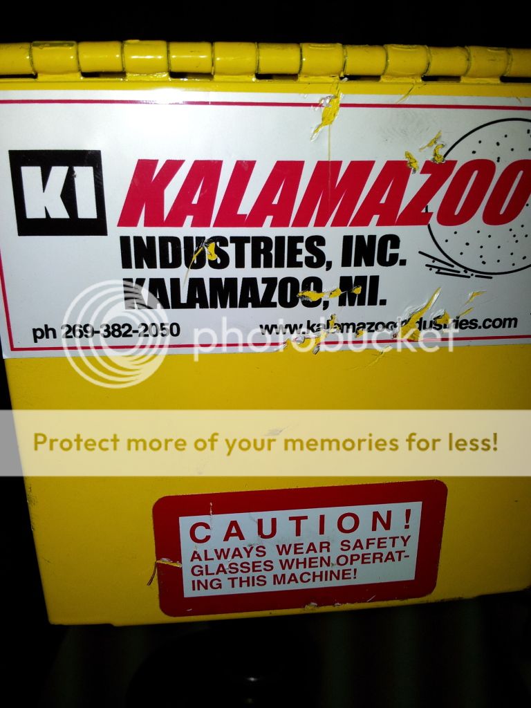

I just got my Kalamazoo 1SM belt sander. I'm a little bummed. There was no packing material at all in the box and the platen got bent and it was a little scratched up. There was also no ply board attached to it like I have seen posted by others.
My use of belt grinders is very limited, but the last thing I'd want on my new toy (assuming you'll use it) is a bent platen.
Maybe they could drop ship you a straight one?
Unless my eyes deceive me, that's the tool rest, not the platen.
The platen is located behind the belt to back it. The platen will give you
a Vee edge and without the platen, a convex edge.
Bill
Bill
Bill's right of course.
I didn't even look at the pics.
I still might ask for a replacement though.
My bad. I thought the tool rest was called the platen. Damn newbies!!! I might try and straighten it out but if doesn't work out well, I'll ask for a replacement.
It is a shame that a new tool gets to you damaged in shipping. I would be pi@#*, but would notify the shipper to let them know about the shipping damage. Maybe they can modify their packaging for future orders with this knowledge. From the looks of the photo, it looks to me like you can remove the Tool rest and straighten it out and remount with no harm done. I would still ask the shipper for a replacement tool rest just in case the metal gets fatigued upon removal and straightening out. I would think it is the least they can do in response to the other cosmetic damage done. Good luck and let us know about their customer service response.
