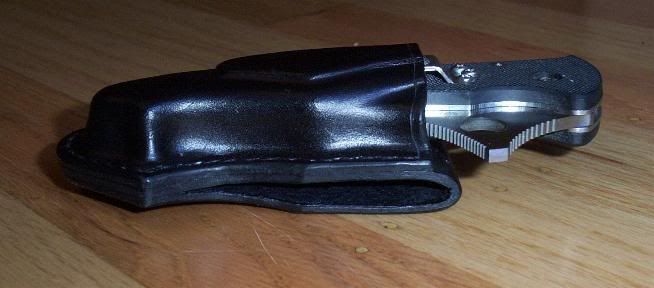

for a Benchmade balisong knife, but is similar to how the horizontal sheaths
are created;
Front opening, you can see the top section, then the middle layer then
the belt loop and finally the folded down belt loop, so there are 4 layers
along the bottom hand sewn into place;
top side shows where the belt loop is trimmed down to create the belt loop
and glued down and stitched into place;
