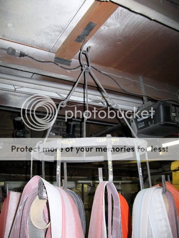

I'm in the process of setting up my new shop, and would like to come up with some sort of solution for storing belts. Simply hanging them from pegs hasn't been working very well.
I'm thinking that maybe some sort of spring tensioning system would be best. If nothing else, it would keep the belts from curling up and getting tangled together.
Anyone have any ideas on the best way to store belts?

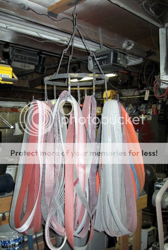

Here's my solution....and old pot rack that I made years ago. Made some new hooks for it, suspended it from the ceiling so it rotates. All I do is spin it to the belt I need, grab it, and go back to grinding.
