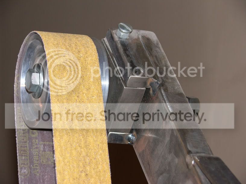

hears one i built for my surface grinder,,note the tracking knob on the back and the off set pivot axle
