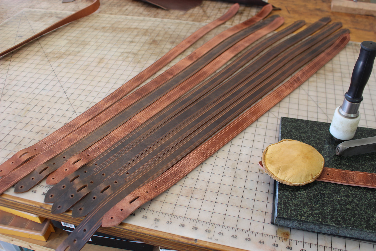

Here I've got the belt blanks all cut out. I've punched the spear points on each end and have punched the buckle tongue slot and Chicago Screw holes as well. We use these screws on our belts as that way the customer can change out the buckle if they like. I've also cut the stitching grooves as all our belts are lined. here I'm stamping the makers mark on all of them.

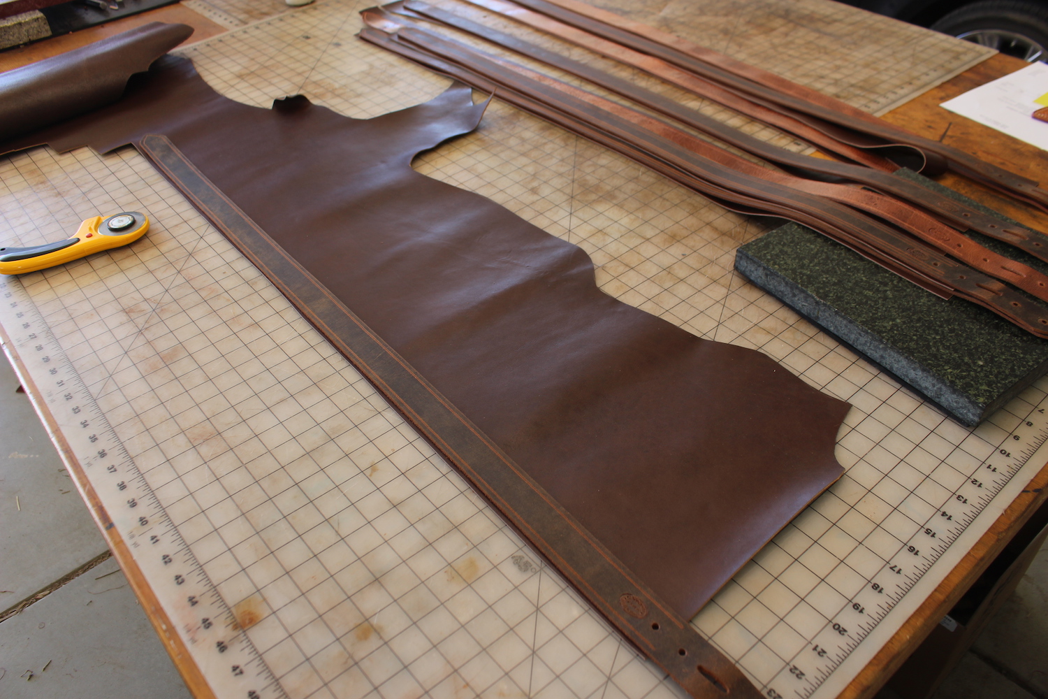

Then I start cutting the lining for each belt. Each one is cut as an individual and I use a roller knife to cut this thinner leather. The lining is an Horween 4 to 5 oz brown latigo.
I skive the end of the lining so that it will lay down flat. I like the lining to end between the two screw holes. Its also necessary to rough up the leathers before glueing paying particular attention to all edges. I use a rat tail file for this.

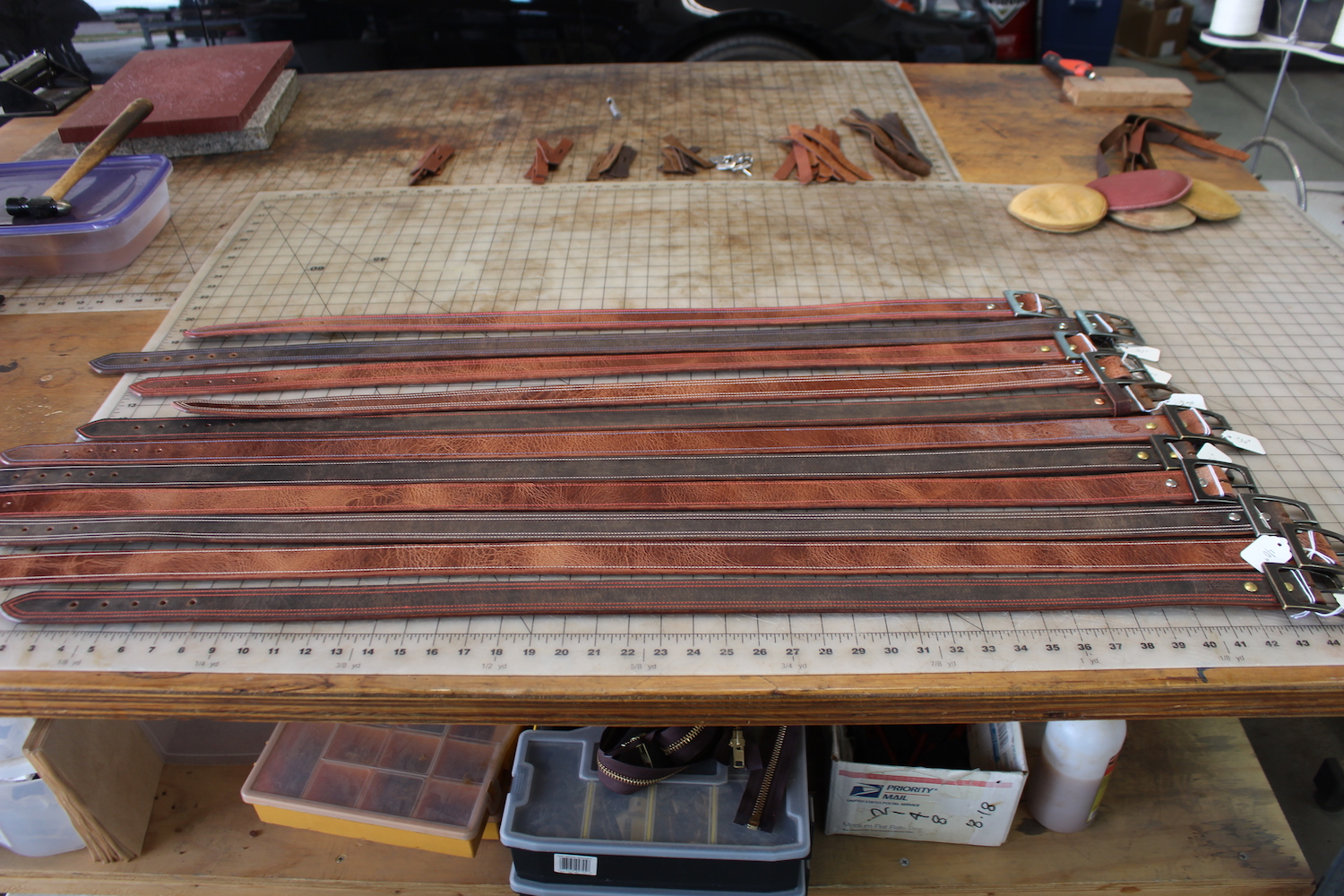

Then I glue up both the belt and the lining.
Now they are ready to sew. I run em inside and Nichole starts sewing em. Some are double stitched and some are sewn with different colored threads. We always try to make a variety as you don't know who's coming in your booth to shop and what they're tastes are.

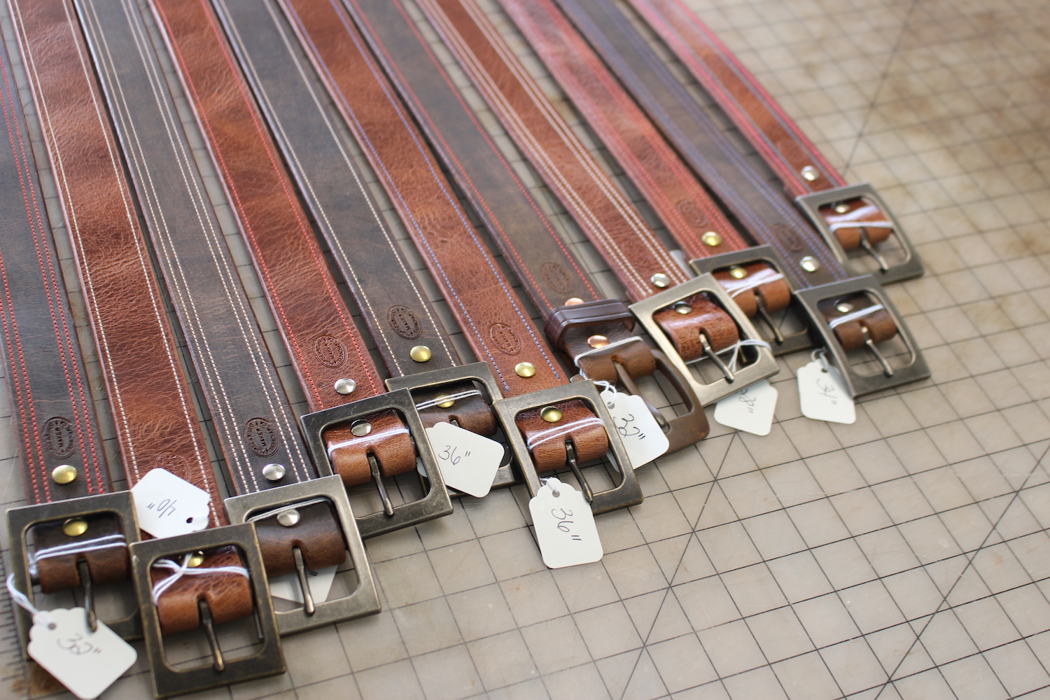

After they had the edges rubbed Katy Mac started in on the finish work. Punching the tongue holes and installing buckles. Pretty much all that was left was to put their price tag on and size em.
