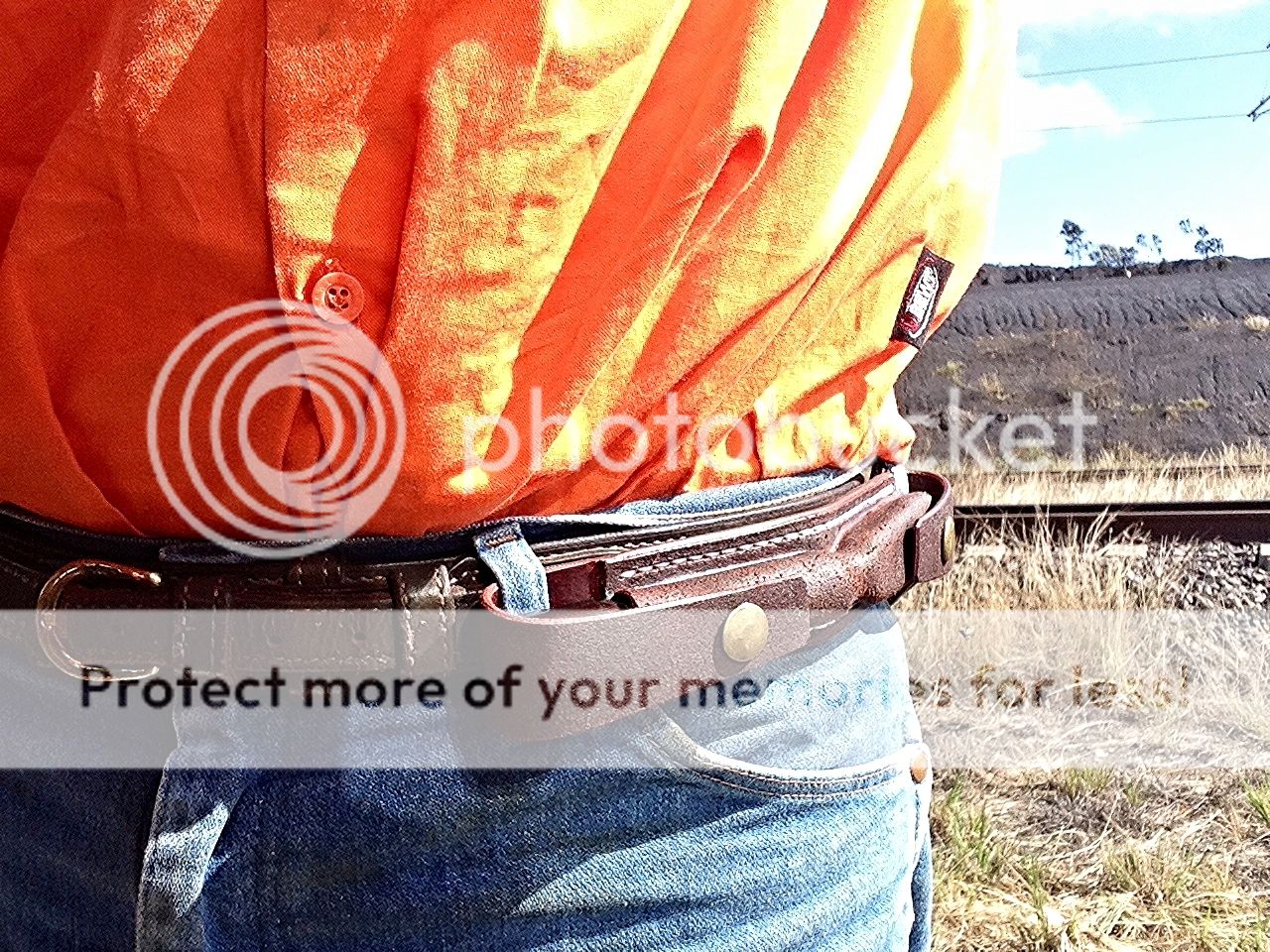

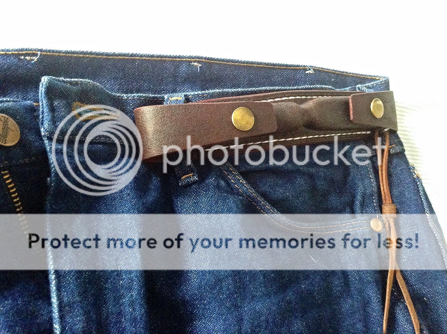

Here is my Version 2 .
The flaps of the double ended pouches also act as the attachment system to the belt loops of the jeans .
I haven't bothered to refine the finish of this sheath as there are a couple of areas of the design that could be improved upon in version 3 .
But the whole idea of this was to see if the concept will work and give me a working model to trial .
I will wear it this week at work and see if it handles the real world , it certainly has worked around home for the last couple of hours :)
Its hard to take a good picture of yourself wearing one of these things .

Dang Ken thats cool! At first I'm thinking That won't work you get your knife out and the whole thing is dangling and floppiing around and then (about the end of the first cup of coffee) I think Duh! just re snap Dave geez! When you coming by for a shop visit? I need help on my molding and you definity have er down
Its surprising Dave , but the bend and memory of the flaps keep it in place even if they are unfastened . I tried undoing both ends and jumping up and down outside on the lawn and it didn't move or come off , the overall length is kind of important as is the bend in the middle , it all combines to kind of wedge it between the loops .
The test is going to be wearing it at work in a hard use environment .
The pics are a bit deceiving , in real life its not that big , it looks like its the size of a jumbo jet in those photos which is a trick of the angle and camera .
Ken

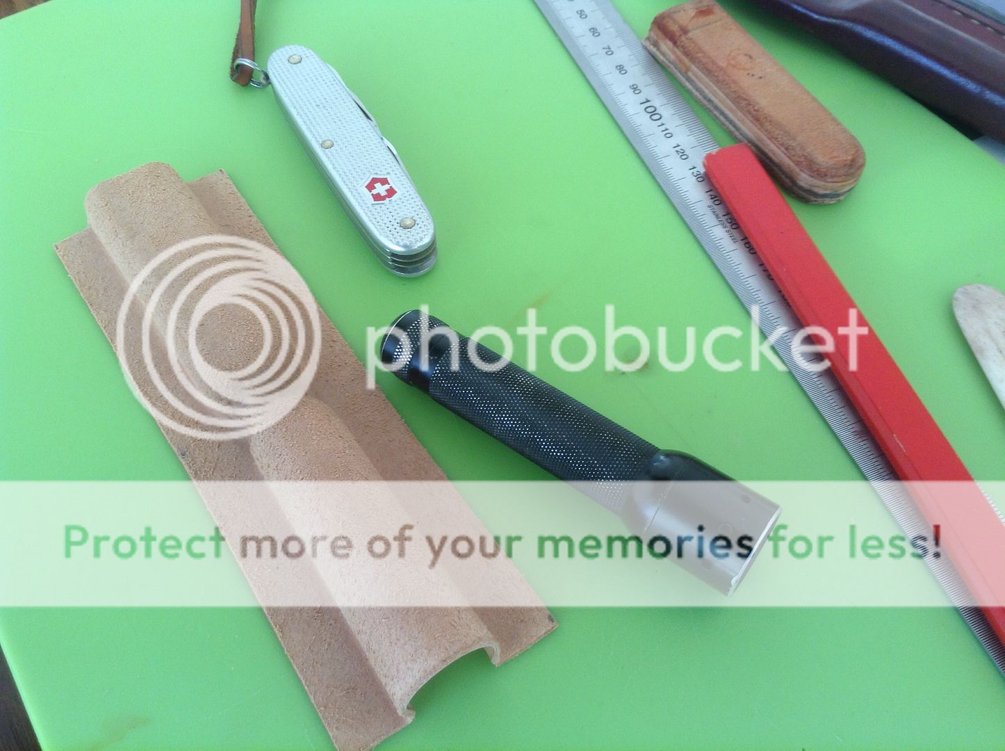

now seriously, could you do a wip/tutorial for your wetforming? i'm not sure, but that sak/flashlight sheath is probably closer to 3mm leather than 2mm... i couldn't get this kind of shaping if my life depended on it... also did you dye the leather or is it pre dyed?
Its funny that you all have mentioned the wet forming when it is one of the areas that I'm not happy with . I wanted it to be more defined than what I got .
I wanted to make the two pouches out of the same piece of leather for a few different reasons . The flashlight switch is on the end of the handle so if you make a closed end you run the risk of the flashlight being accidentally switched on when you push it into the sheath , also I wanted to create a stretching tension on the sheath as it bends in the middle to conform to the curve of your body , but the end result was that I didn't get the definition I wanted where the two pouches meet .
Wet forming is one of the more enjoyable aspects of making sheaths in my view .
Next time I'm making something I'll take time to photograph the process .
It's not hard , you just need to take your time and don't rush it .
The leather used isn't pre-dyed and I didn't take many pics as I was making it , but here are couple .
I didn't use my best leather for this one as it was always going to be a prototype , so its a bit rougher than I would usually use , the dye is British Tan but I really put it on heavy to darken it and to harden the leather as much as possible .
