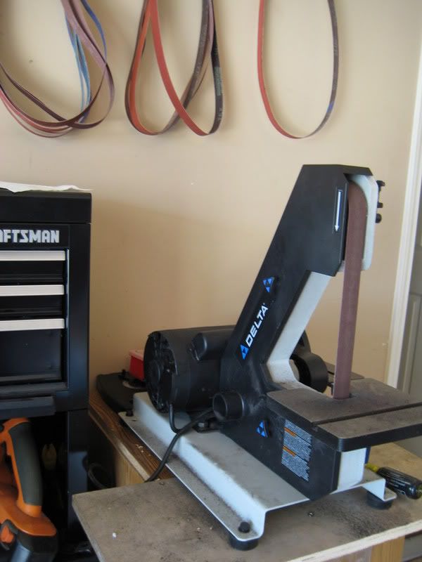

I bought one of the $40 1x30 sanders and added a rheostat to slow it down. Makes things a lot easier.
A rheostat.... Like a dimmer switch for a light.
I picked it up at a hardware store. I had to cut the power cord on the sander and wired it in. All it really does is regulate how much power is getting to the motor.
No pics at the moment. I'll see what I can dig up.
Thanks kdstrick, no magic, no voodoo and convexed edge in two minutes? Beats the hell out of mousepads and sandpaper. Is there any risk of overheating the blade, ruining temper/finish? If so, how do you avoid it?
