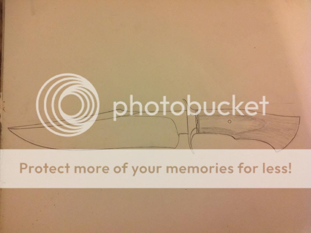

So onto our first build. I told Ben that I was looking for a mid size bowie that would be a good general use knife. We determined we were going to use W2 steel with a variable heat treating process to allow it to be harder at the edge and softer on the spine and it will be finished with a nice Blackwood handle and file worked spacer. After going back and forth a bit more this was our starting sketch.
Ben is calling this knife “'Talisman'. That's a charm you carry to ward off evil...I'd say this beats a charm any day”. Now to take the sketch and bring it alive in metal.

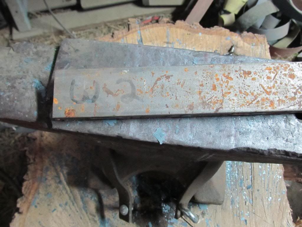

Ben started to heat up some 1 1/2”x3/8 W2 to get started

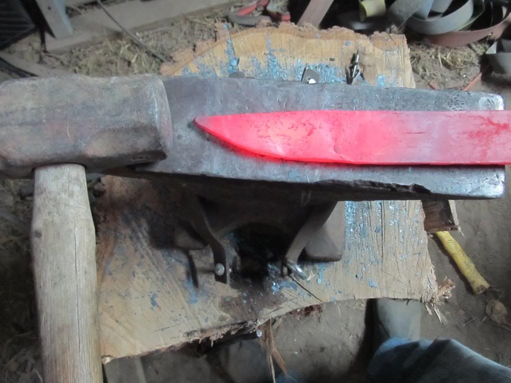

Forge it pointy!

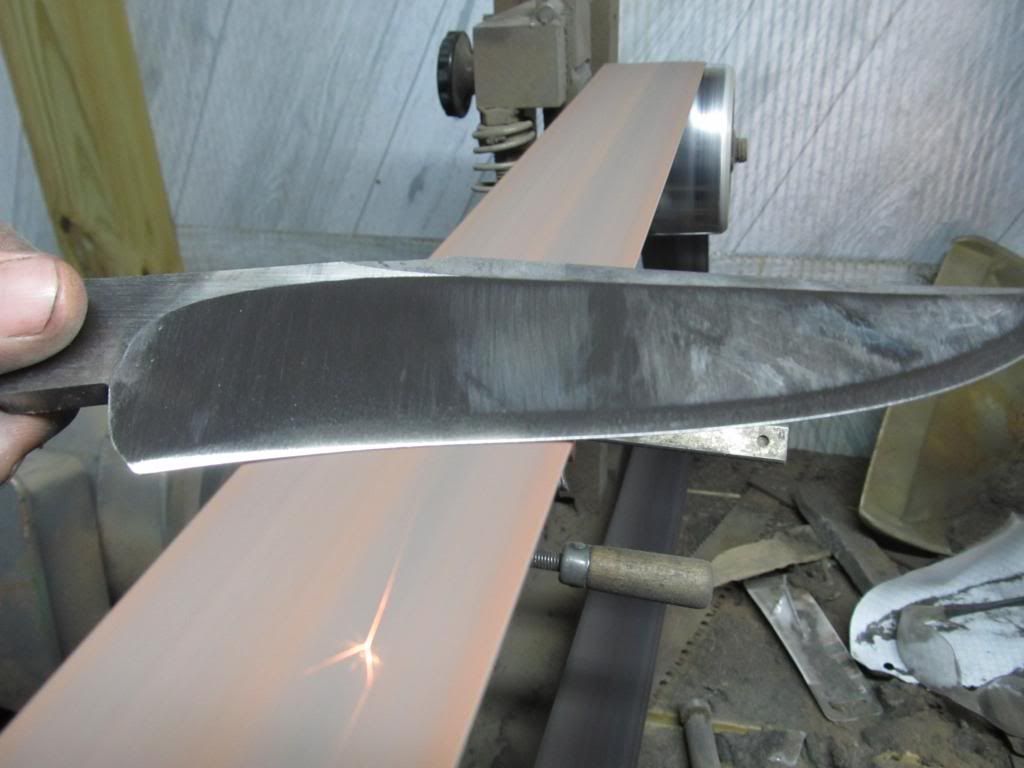

Then to shape

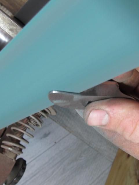

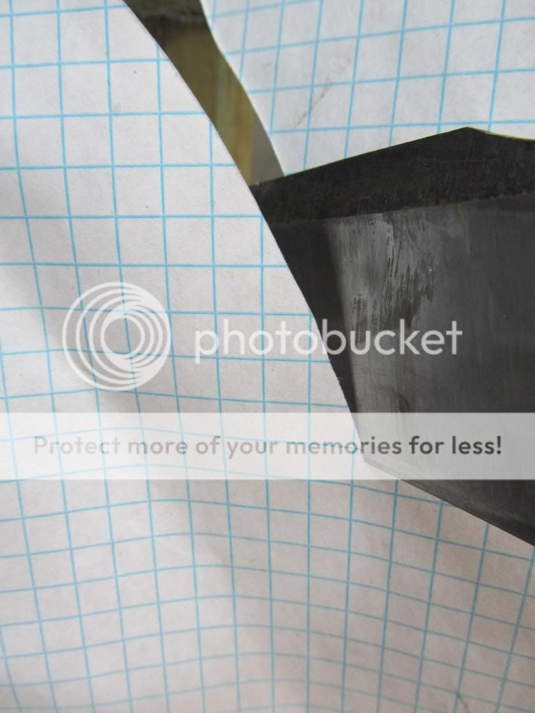

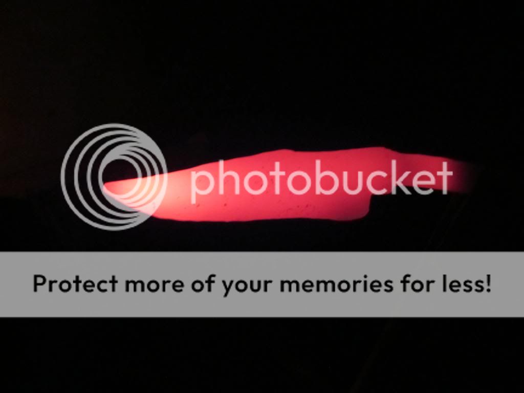

Then rough grind and heat treat. The blade is clay-coated, thermal-cycled, and quenched in Parks 50 quenching oil.
More to come in the next post

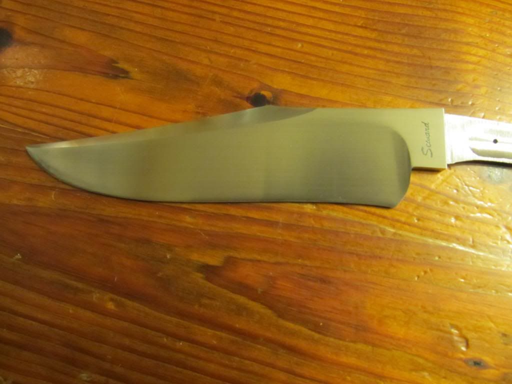

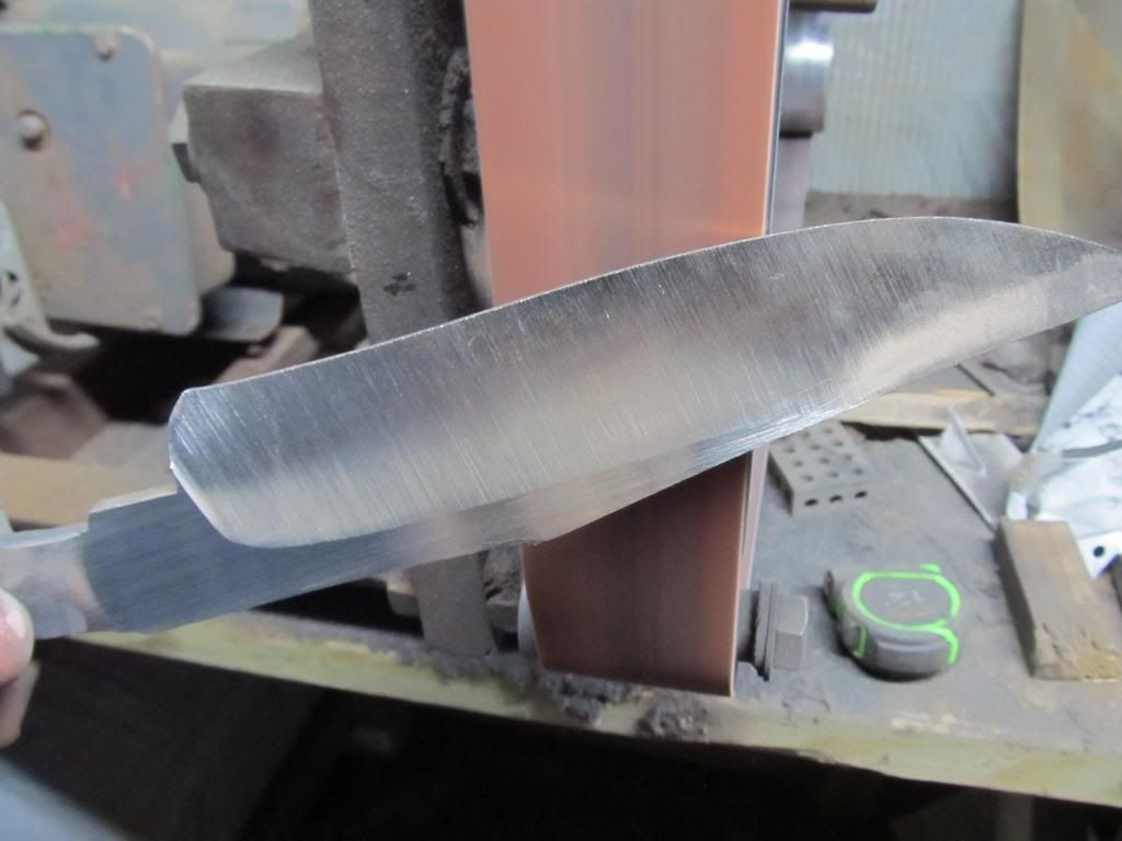

Here it is after two tempering cycles @ 425 degrees (notice the blue color). Then it is finish ground.
The edge is rolled then sharpened...

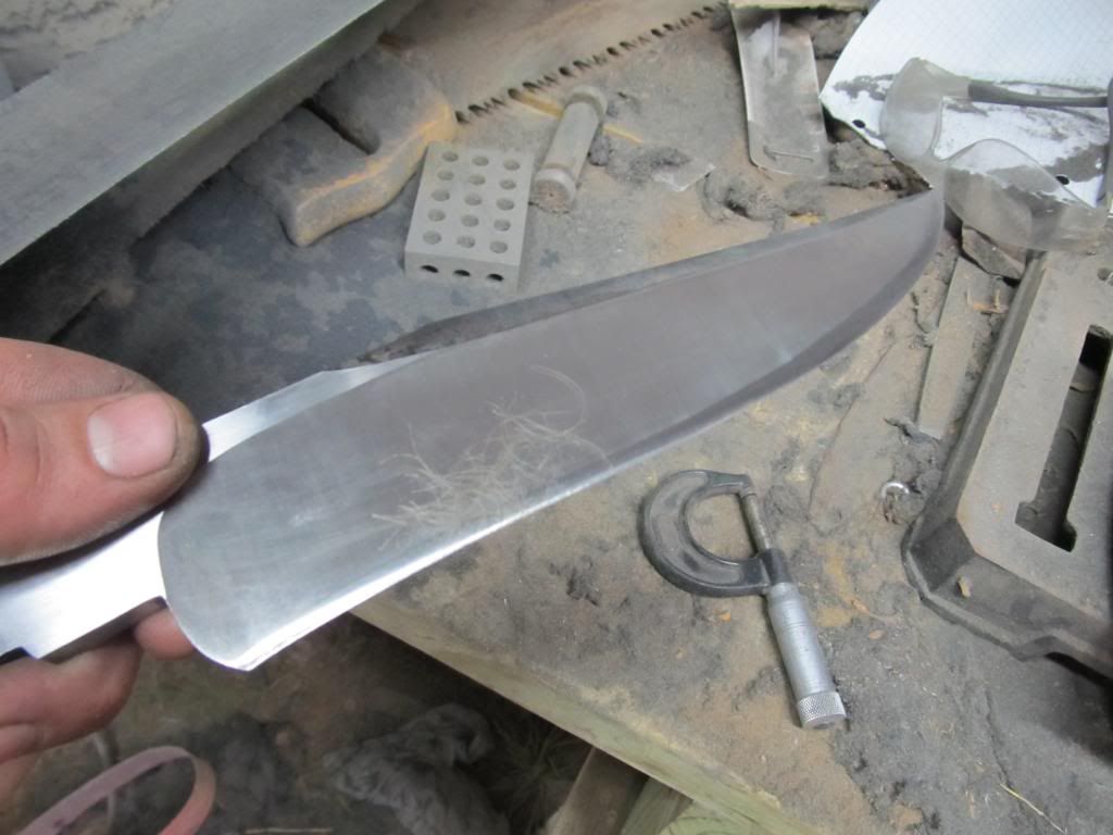

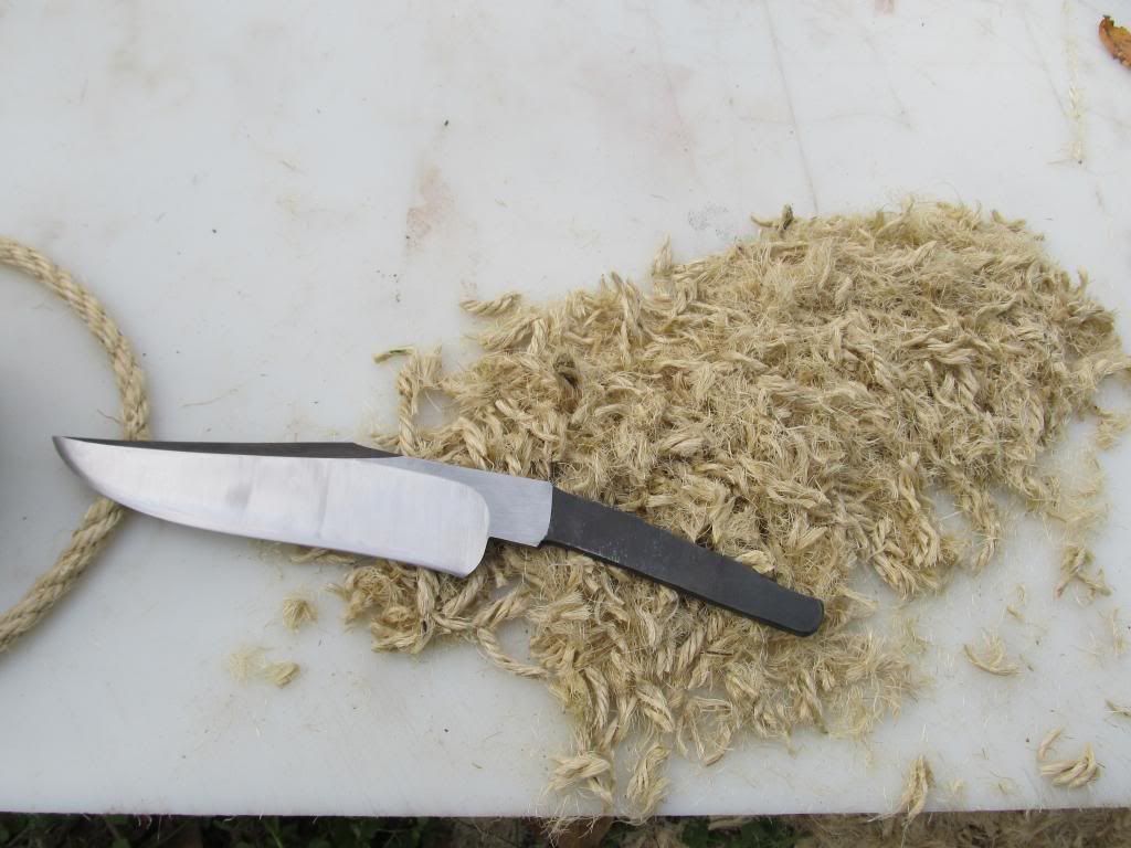

A little edge retention testing--3/8 inch sisal rope cut 200x..
And after all that cutting, Still cutting hair..

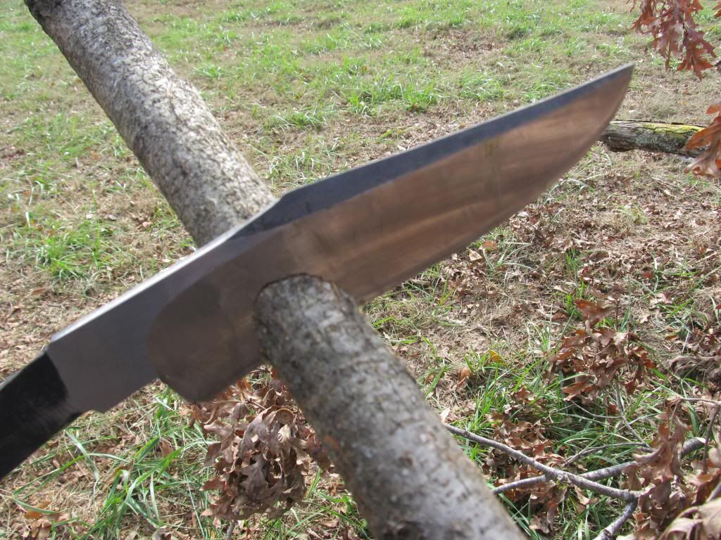

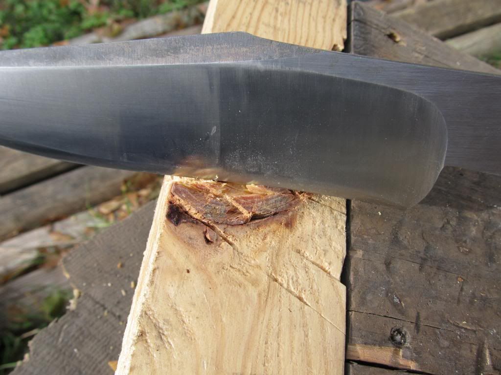

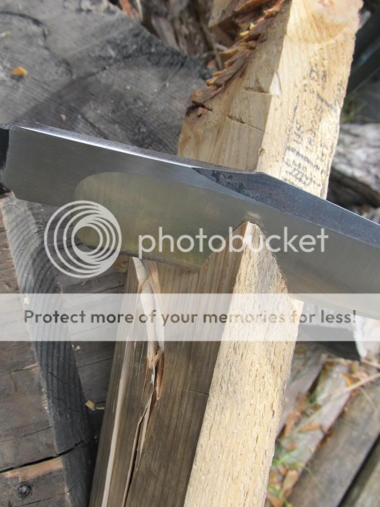

Chopping on a pine knot. This is to test the edge toughness and geometry.
Has good bite on yellow pine...minus the knot.
Hacking some junk in the back yard...this was one stroke.
Chopping some white oak...not bad for a little guy.
Oh, and it still slices paper.

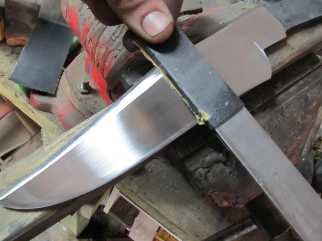

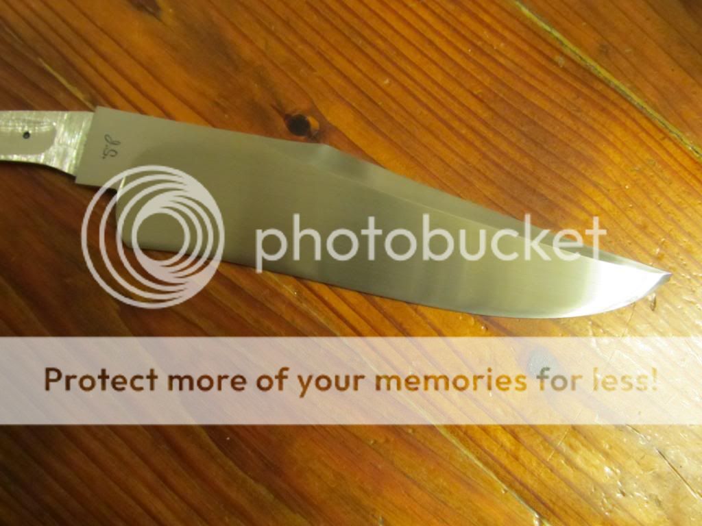

Now that I'm happy with the performance it's on to the hand sanding.

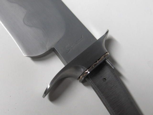

After hand-sanding I cut the shoulders for the guard fit-up.
Then I put my John Hancock to it...
And the journeyman mark.

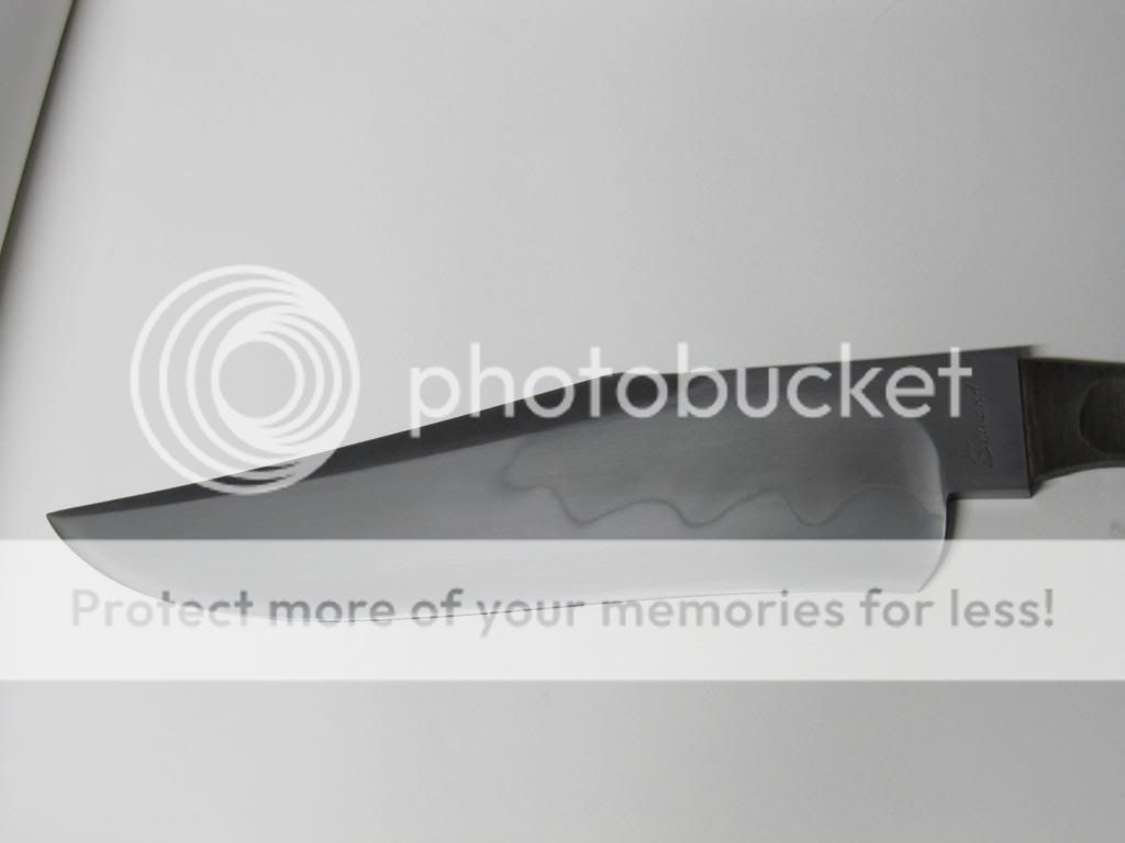

After a bunch of etching and polishing you get this.
This is where we are at for now, more to come soon!

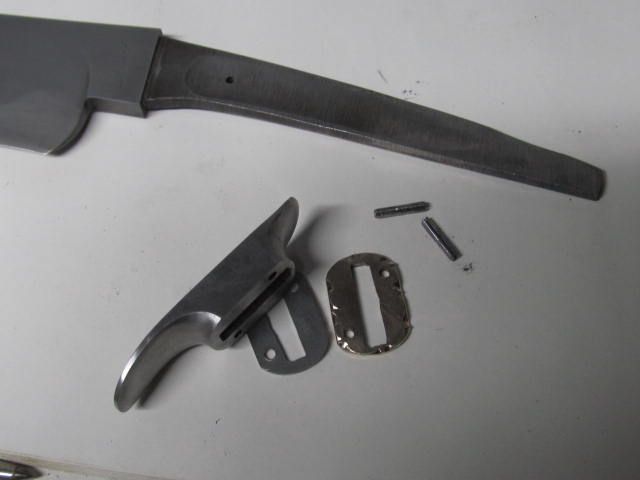

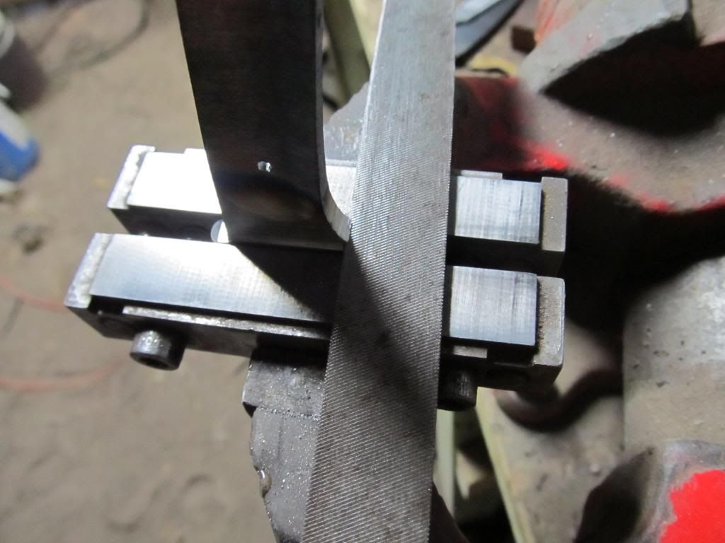

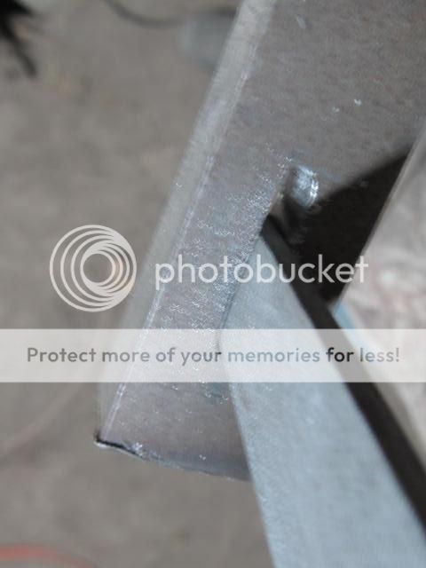

Starting the Guard:

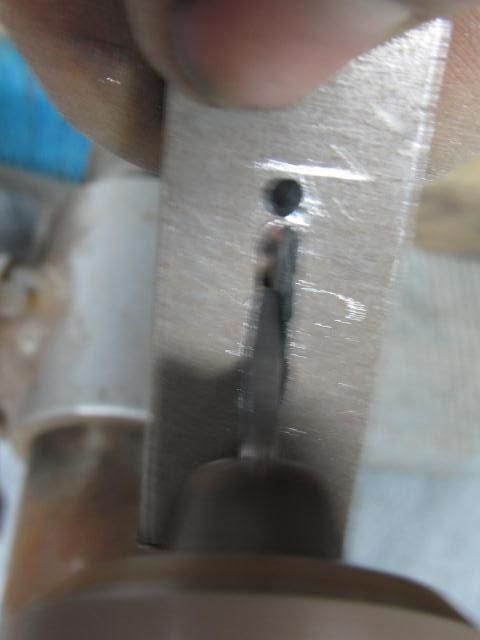

Connecting the Holes
Filing the slots to connect the holes, a lot of work without a milling machine (Ben needs to sell some more knives so he can buy a milling machine!).
Grinding. After this the S is bent, then more finish grinding.
Convexing (technical term) the lugs. This is something that Ben does to give the appearance of a delicate slip of a guard...without compromising strength.

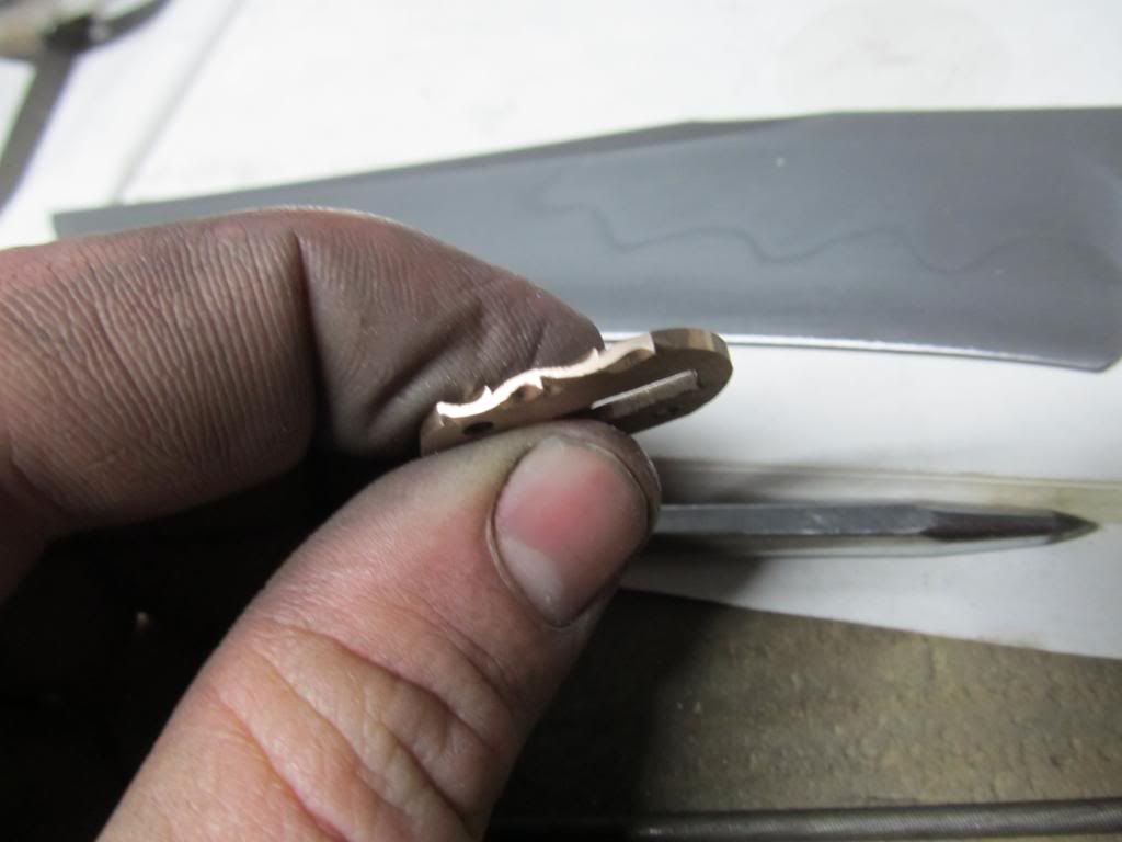

File-working the spacer. The alignment holes have already been drilled.
Here's all the pieces...S-guard, alignment pins, bronze spacer, stainless spacer.
Here it is together. We are getting close!
