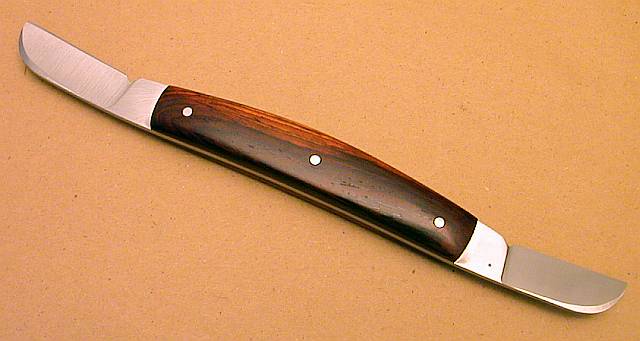

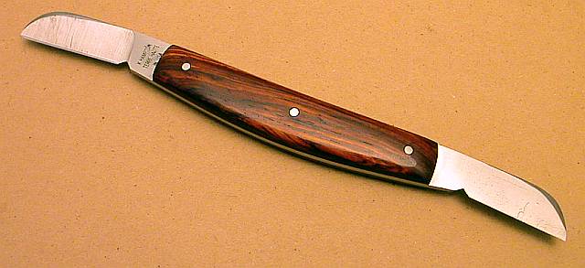

When you are working on something at your bench, how many times do you reach for something to cut and scrape with? Here's a handy tool that I learned about from Tony Bose that fits the bill.
This is patterned after a congress slip joint folder with both blades opened. One blade is flat chisel ground for use as a scraper and the other is a 10" hollow ground blade for cutting/carving. The handle is cocobolo and pinned with SS. It's overall length is 8".
The steel is probably L6 and comes from an old bandsaw that was surface ground to .100". I oil quenched and tempered the blade ends with a torch. Rc tested right at 59(you can see the Rc dimples in the images) Only took a couple of hours to crank out, including interruptions.:D
