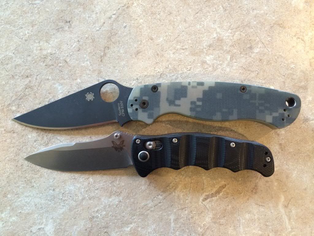

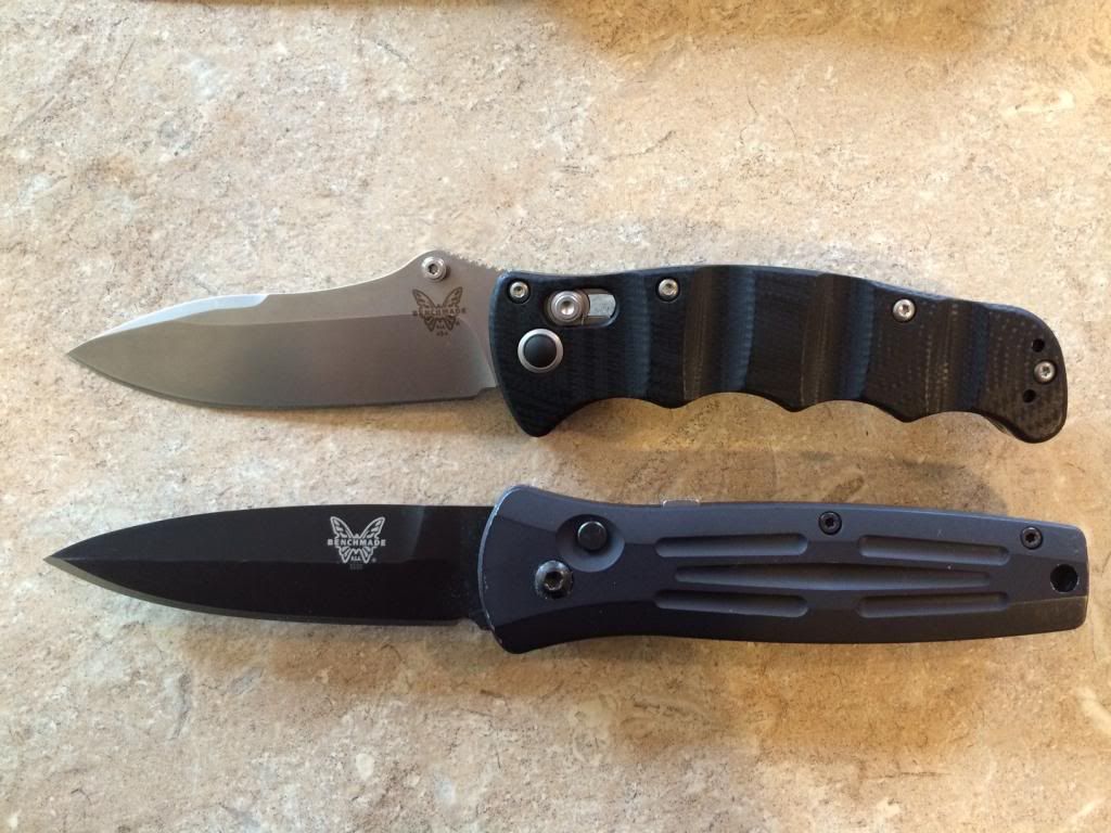

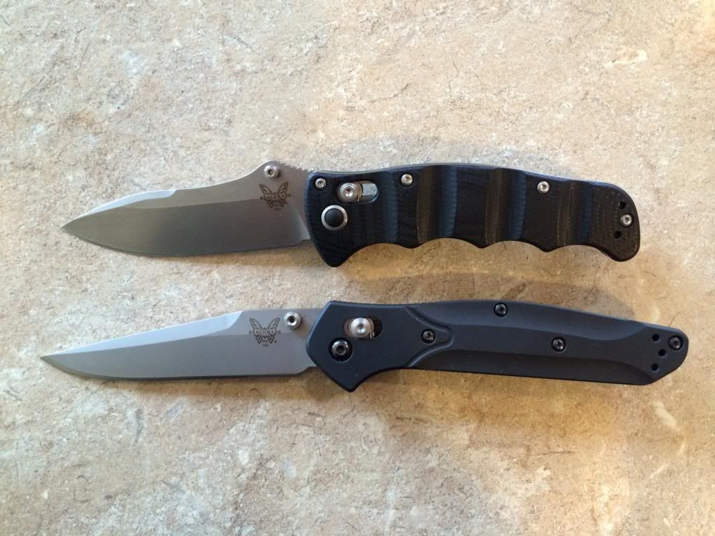

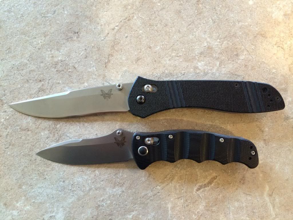

From the numbers, you can see this thing is SMALL. Like, Mini-Grip small. I took a few comparison photos of well-known knives for reference. These are arranged from smallest to largest:
3550
943
Paramilitary 2
710-2
And laughably, an 810
After carrying it for a few days, I can say the size doesn't bother me. It has almost the same length of cutting edge that the PM2 has, but with a MUCH smaller handle. Speaking of the handle, it is exquisitely comfortable to my medium hands. The thumb-ramp jimping is perfect, and well-placed.

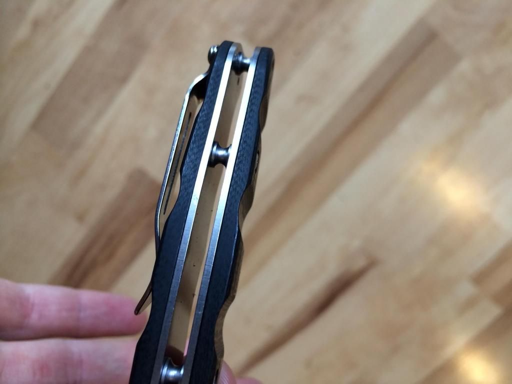

The liners aren't drilled, so if someone wanted to make the 484 lighter, there is wiggle room

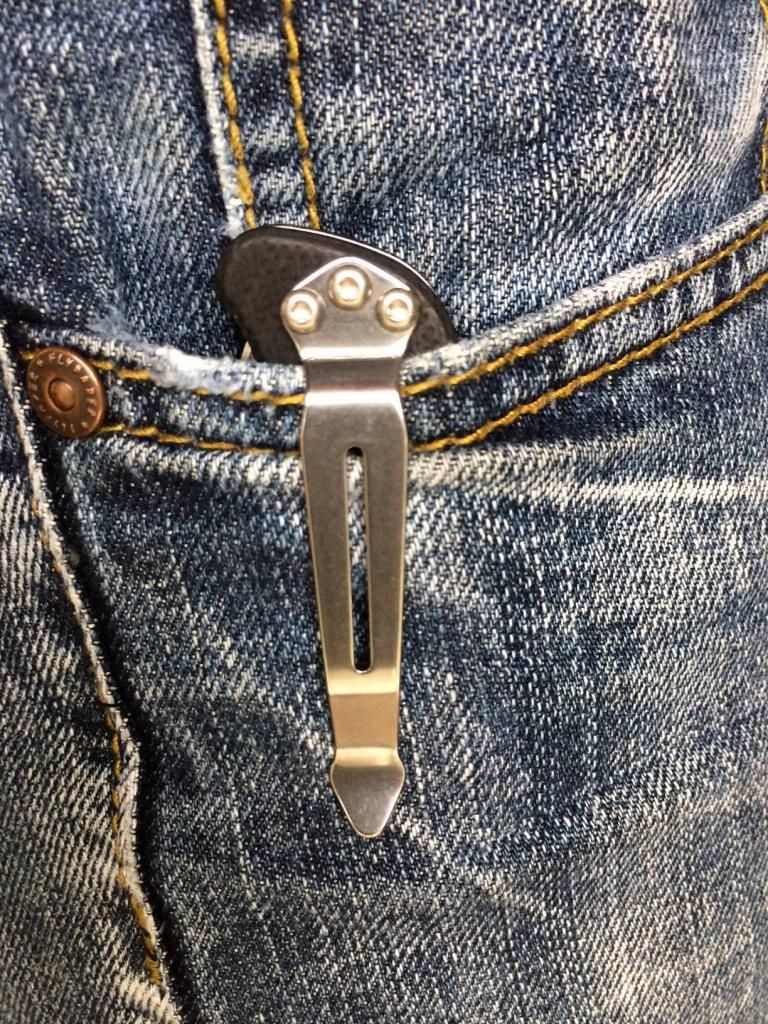

Split-Arrow clip. Some people say this knife rides high, but I like it like that. I've seen the 810 clip put on the 484, but it sticks off the end of the handle, ruining the ergos and asthetics.

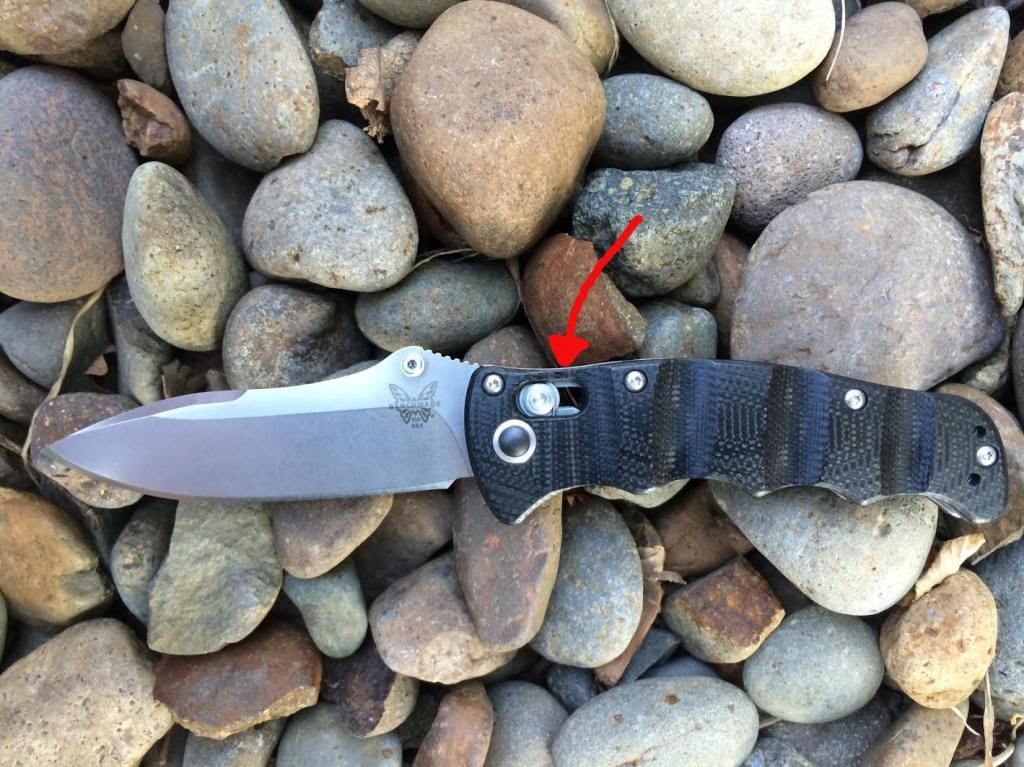

The fit and finish was what we've come to expect from Benchmade over the last few years: Not all that great. The blade was not centered, and the edge was work-sharp, but very wavy. The main bevel was about 1.5 mm shorter on one side, meaning I needed to grind into the plunge line in order to sharpen the full edge. On a positive note, the pivot is perfect. Very little play, and the blade will fall open under it's own weight and swing a few times when the Axis Lock is pulled. The edge was standard Benchmade nonsense at 45º-50º inclusive, but this one came in pretty crappy. My 1/2" stones wouldn't hit parts of the blade until a lot of material had been removed. I now run it at 34º inclusive, and stropped to a hazy mirror finish. The blade shape lends itself to be a slicer, and it doesn't disappoint! It will push cut printer paper almost silently.

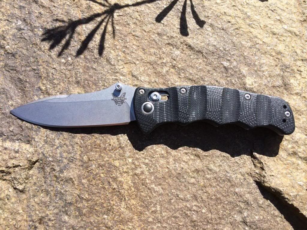

Aesthetically, this knife is very pleasing to look at. The blade is almost just a small version of the Spyderco Gayle Bradley. The handle looks terrible in the stock photos, but it actually matte in nature. The pivot screws are black with a silver metal band sticking out from under them... As a BMW owner, this closely matches my Angel Eyes. Just like Angel Eyes, some will love it, some will hate it.

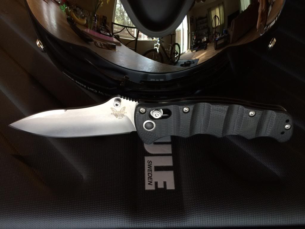

Glamor shots:

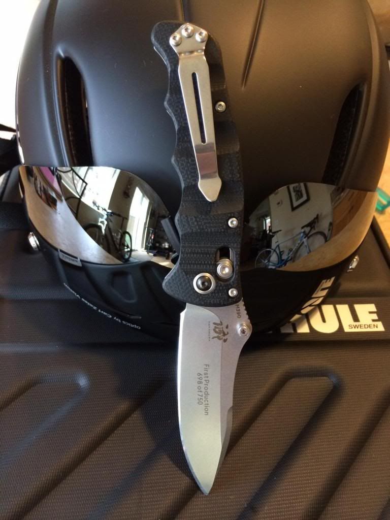

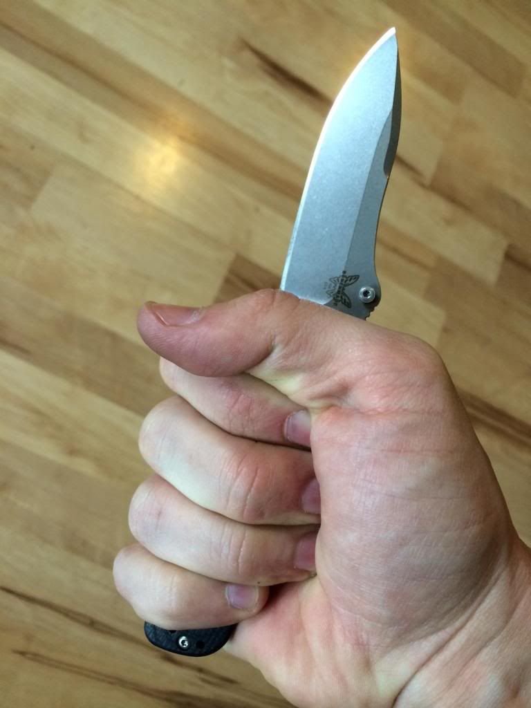

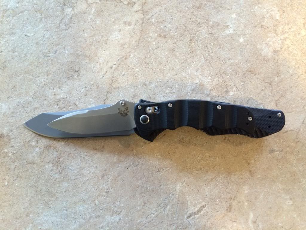

Unfortunately, a rather large issue arose when I began carrying the knife. The very exposed and long thumbstuds can grab the inside of a jeans pocket and near-Emerson Wave the knife about 1/4 open before releasing the blade, slamming it shut. I actually ended up with a nice notch in my pointer finger nail from this madness before I even realized what was going on. I tried to fit a set of studs off of one of my other Benchmades, but the hole in the blade is significantly smaller than those of the rest of the knives I own. To give you an idea of the problem, I took this picture mid-pull:
