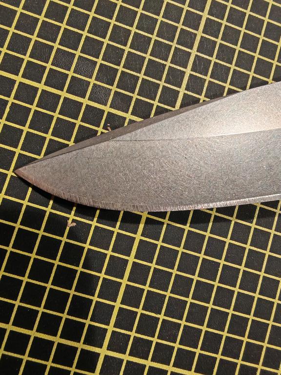

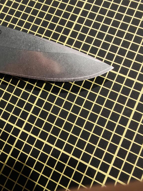

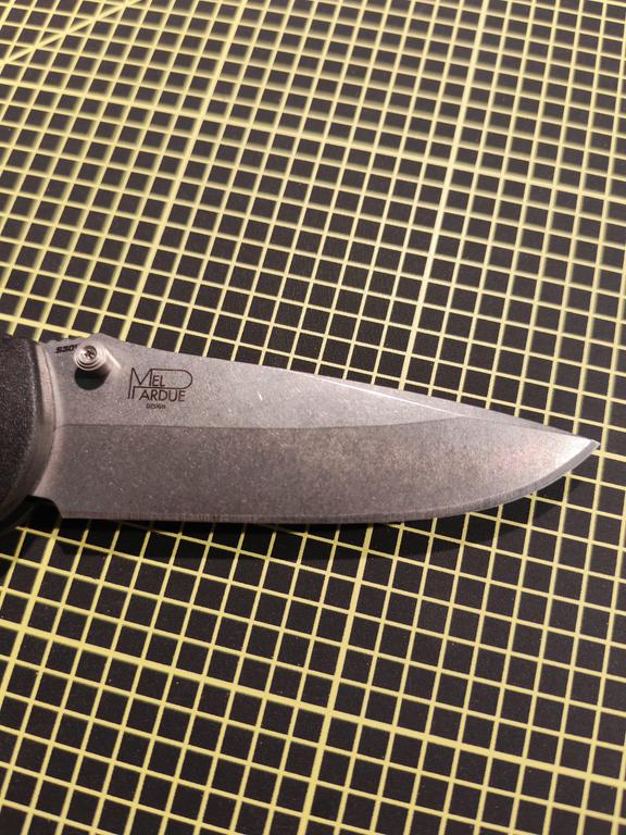

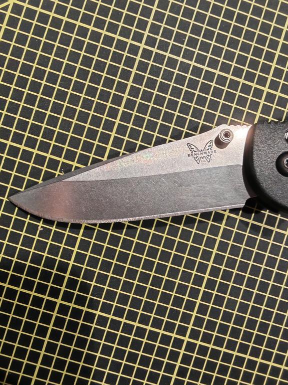

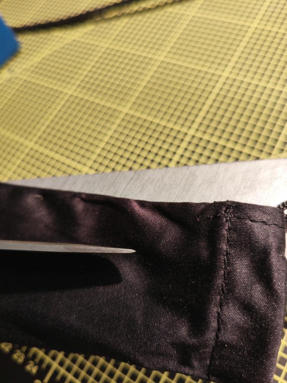

Hi,
wanted to ask about your opinion if you would send that new BM back or if you consider the edge bevel OK?
I find the bevels a little wide. The wider bevel on the show side might be about 18dps and the other might be around 19-20dps. For that measurements the bevels are a little wide imo.
Thickness bte is around 0,64-0,67mm. At the tip area tickness bte is around 0,8-0,9mm.
Thanks and BR,
Oliver
I can't see the pictures. But in recent years BM has decided to emulate Spyderco's thick edge bevel, so this comes as no surprise. Too bad, that is one area where BM was superior to Spyderco, but no longer.
