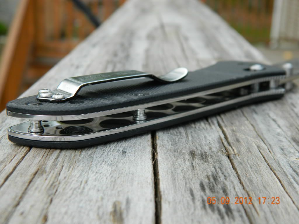

Nope. I got those from a on line supplier.
You could purchase some yourself and put them on.
BM spacers will more than likely be the newer cog style.
These are not threaded.
The factory screws go right through them and screws mount like they always do.
The standoffs above threaded and require a slightly bigger hole be drilled to accommodate the neck/throat on them.
But, there are other standoffs with out this neck/throat on them available.
.165" is the size you're looking for.
If you are going to purchase threaded standoffs.
You gonna want to buy some screws too.
That way you can screw into the standoffs from both sides of the knife

These standoffs won't just slip into place.
Both liners mounting holes would need to be drilled out to .120" hole to accept the neck.
The factory hole is slightly smaller than what is needed.

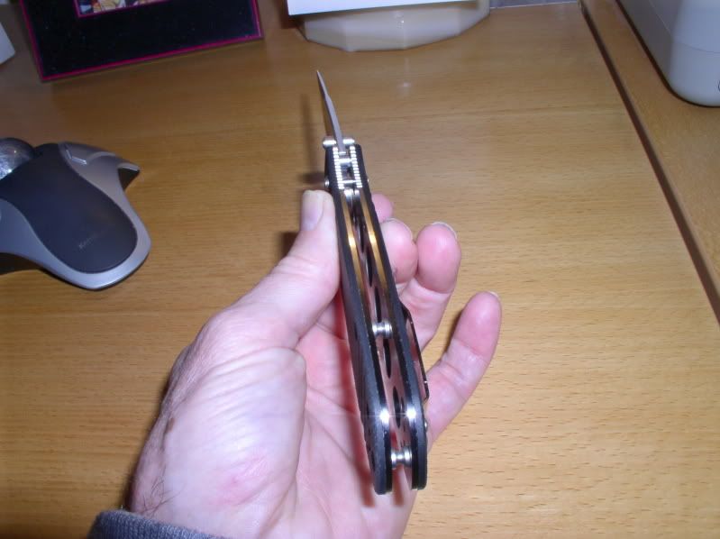

These on my 710-1 are Benchmade's version and I much prefer the open frame; it's easier to keep clean and as a bonus lightens the knife.
Those look great! I am think the hourglass shaped spacers would ensure the blade does not touch the backspacer. Are those factory backspacers installed by Benchmade or did you do that yourself?
I do believe that is what Joe is saying here.
Those are BM's standoffs/barrel spacers.
