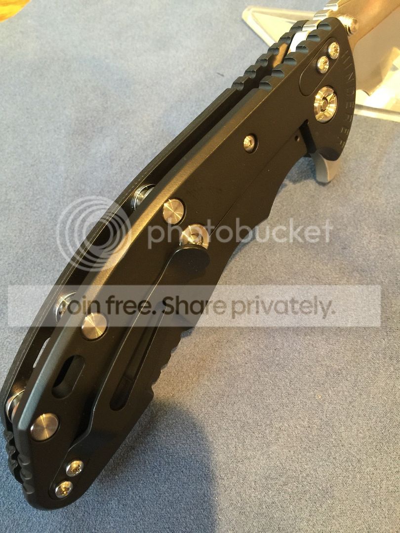

Death of all things is a member on this forum that makes aftermarket 940 scales i'm pretty sure, he's got a thread in the custom knife services section.
My friend THAT is beautiful. How durable is the coating?
When it's preped, applied and cured properly it's very durable. That being said I have seen lots of inferior work on factory knives. I have used it for years on guns and knives and like it. All coating wear and at different levels depending on use and conditions. Cerakote has a cool factors as colors are infinite.
Ryan, DOAT, makes fantastic scales for the 94x!!
Here are 2 he's done for me.
Excellent service and a great guy to deal with!
