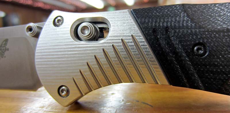

As mentioned in the other review, the handle is nice and thick, so it fills your hand and the
G10 is smooth, a grippier type would be nice to have I think.
Bolsters are aluminum, and the grooves are sharp edged, purposely so as to catch your grip from sliding forward onto the blade.

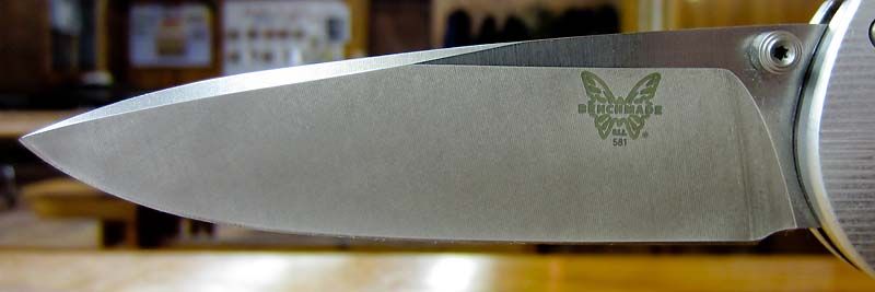

The blade is flat ground and fairly thin edged, should make an excellent slicer, as noted the edge while it will cut
stuff, you are hard pressed to push cut through any material. Which I intend to remedy tomorrow.
Blade alignment, mine shows it favours the right side of the handle when looking from the butt end upwards,
doesn't seem to rub so I'm not concerned on that point.

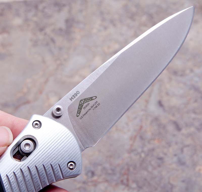

The treatment on the blade works well, as they made the transistion from tang to edge a sloping area
so if material falls into that spot, it will ride up and onto the edge, handier than just a straight drop down
from the edge which seems to catch on stuff all the time.

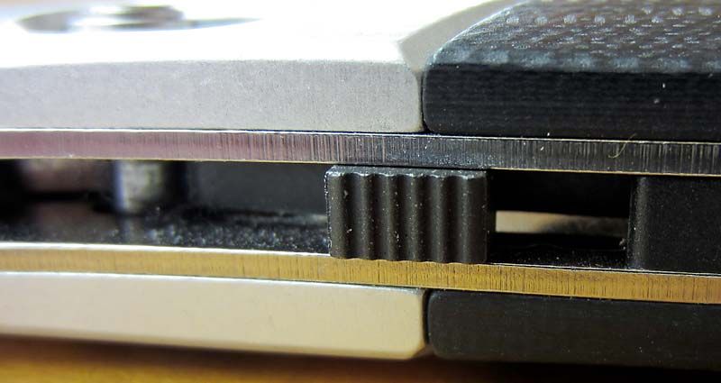

The Axis lock works great, on the spine of the handle they have a sliding lock system that
works to both keep the blade from accidentally opening in your pocket as well as keeping the
lock from disengaging while in use, you have to slide it into place yourself, so it's an option
for you if you want to use it.
Near the middle of the photo you can see the black ribbed looking slide that locks the axis lock in place,
basically it acts as a block to prevent the axis mech to move

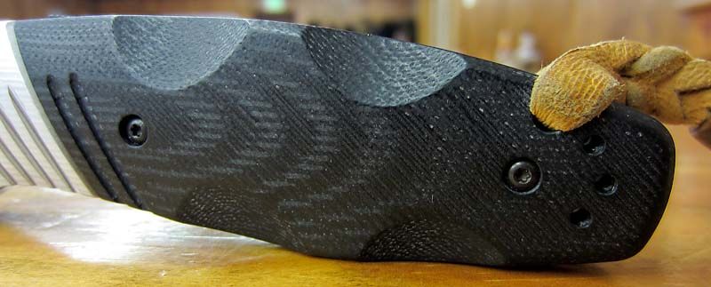

The scales, while smooth, the carved dimples create a nice grip surface, as mentioned above
if it were grittier/textured G10 that would have been nicer, but probably hard to do if they
still put in the dimples.

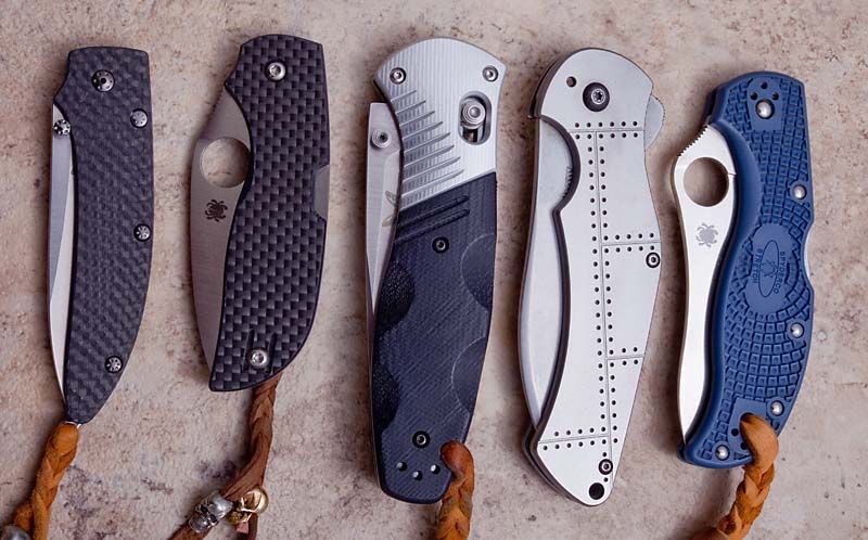

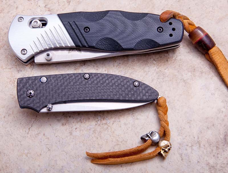

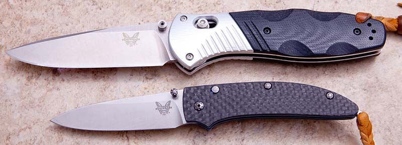

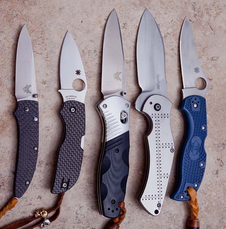

Here are a few more images of the Barrage;
and compared in size to the following;
1st Spyderco Stretch
2nd Kershaw Junkyard Dog II
3rd Benchmade Barrage
4th Spyderco Chapparal
5th Benchmade Shoki

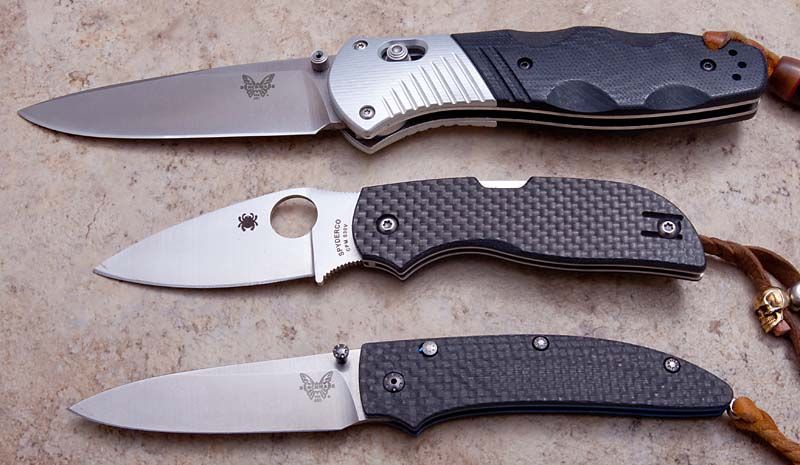

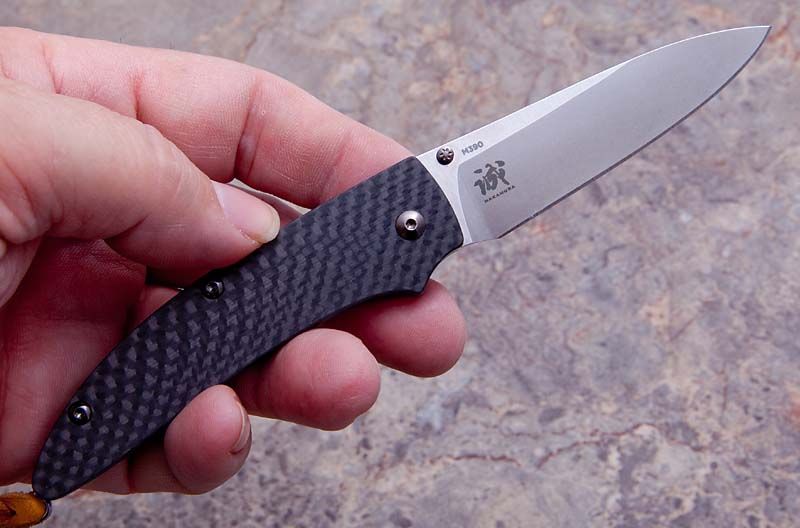

Lately here is my main pocket carry, not counting the Swiss Army Knives, those I think of more as tools;

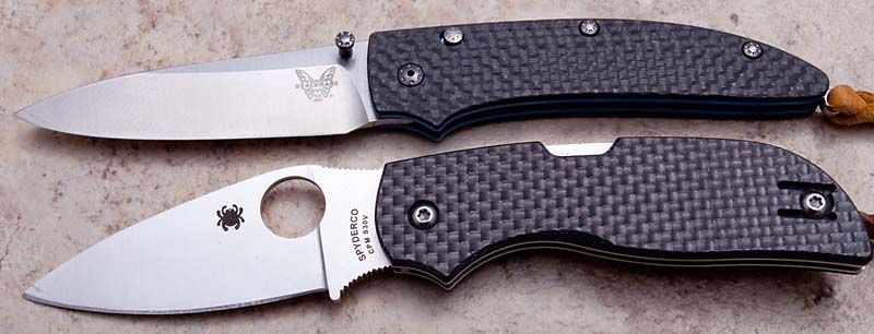

The Barrage, Chapparral, Shoki
These two are similar in size, with the Shoki being slimmer profile
Spyderco has a more pronounced weave in their carbon fiber but the Shoki has a little bit of texture but not the ripples
Thanks Dan, I really like that Shoki 480-1 as a compliment knife to the Barrage, similar blade shape and also made with M390 steel
The detent when closed seems almost non-existent and when open there is some blade play, after tightening the pivot the lateral
play went away but of course it didn't change the vertical, so there is still some slight vertical play, not much but I've never cared
for any blade play, especially on a new knife.

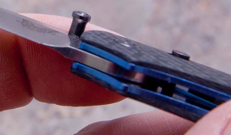

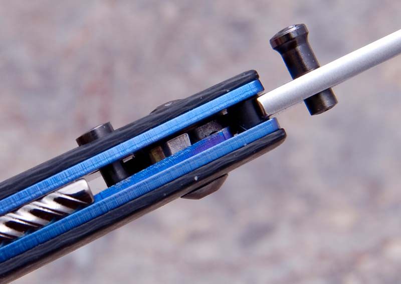

Here are some images of the Shoki;
the Nak lok rises up above the scale only slightly, so I don't think you could accidentally press and release the blade in use,
lets say "normal use" as others have noted this is more a Gent's folder and not a combat blade.
The Nak Lok has, basically, a thumstud attached to the liner that swings across to prevent
the blade from closing. I imagine that it is fairly hard to get the geometry just right to keep
all things lined up and prevent the vertical play, lots of variables going on there.

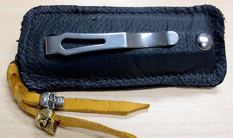

SO, my recommendation is to always carry the Shoki in some type of slip sheath, the one that
is provided, I've worked it in so that it's tip up now and holds the knife pretty secure, the
braided lanyard aids in removal from the sheath, pulling the lanyard while pressing down on
one lip of the sheath's opening. I placed the knife in my left front pocket free once and when
I drew the knife out, the thumbstud caught on something and as it came clear of the pocket
the blade was almost fully open, not a good thing when you don't expect it to be!

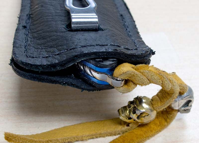

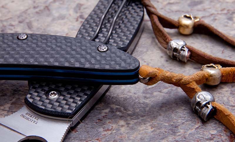

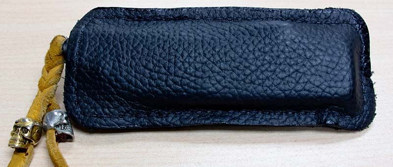

Thanks JD, just took a few images of the small clip sheath, without a lanyard, you would
be hard pressed to remove the knife when it was inserted pivot down;
and a looksee into the opening, the leather is braided snuggly around the metal end
the skulls were from a friend at Ashokan, helped him learn a little about sharpening
William 'Bill' Barrett and they may look scary but they do the job for this small folder
where larger beads would be too much.

So, for me, easy answer, Shoki for the office, for every day joe/jane either one will work fine,
flip a coin, there are no loser's for that flip :)
Hope that helps?
G2
Thank you for a very well-reasoned and thoughtful response, Gary. I passed on Spyderco's Carbon Fiber Caly 3 and Sage 1 for the same reasons - a little too wide to comfortably carry around the office. For me anyway. From pictures, I thought the Chaparral might be better, but the little Shoki still looks like it comes out ahead in the "discreet-carry" category.
I hope BM takes care of your issue. Let us know how that works out.
Thanks.
You're welcome and you certainly should grab a 581, I've been tempted to get one with the black blade too
just for the balance, black blade, light bolster, black scales, I'm all about balance :)
G2
