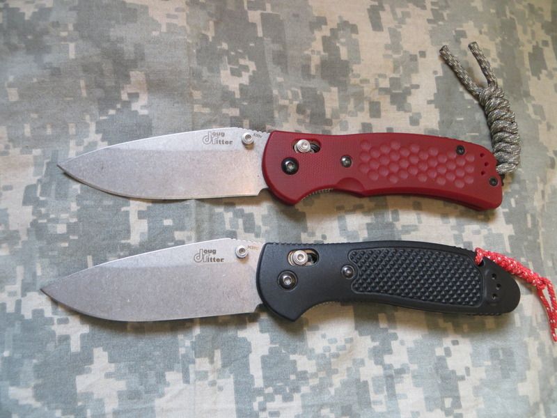

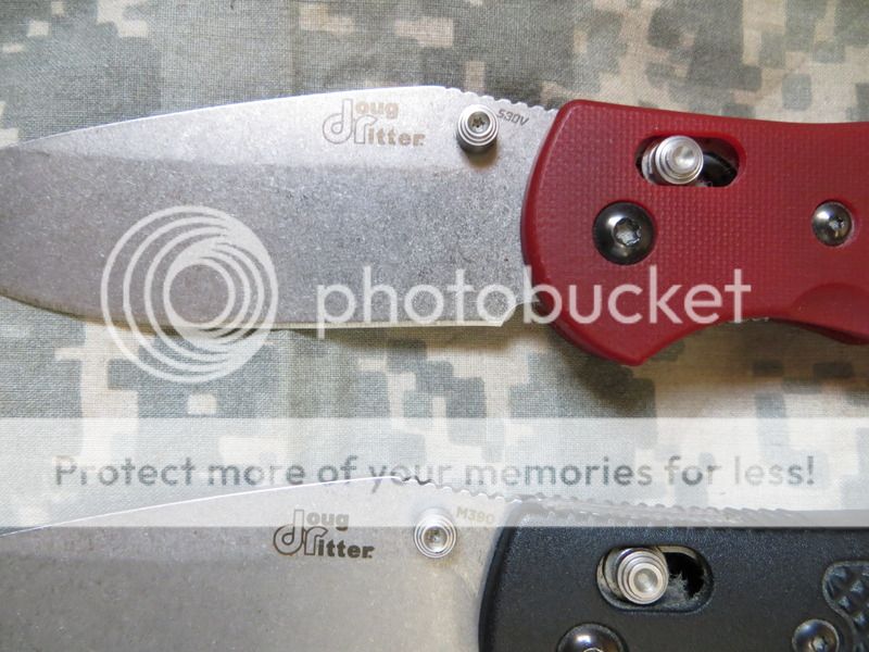

I believe I was one of the first to buy a M390 Grip... works fine for me. BM does do a very good job with S30V though I must say. I have a Ritter with Wilkins in S30V and that works very well too.
