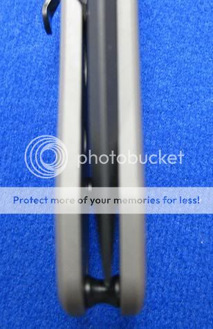

Now, the locks look good, but not quite. The left one has issues with locking up. There was blade play right out of the box. Not just side to side, but up and down. This would be a knife I would send back if I were to get it. The blade on the right locked up nice and solid, no blade play, but was quite difficult to flick open.
As with most frame locks, you have to worry about over extension. This is how Benchmade solved that problem. There is a little nub of the frame lock that hits the pocket clip, making it so you cannot over extend. Great idea IMO.
This is a picture to show both blades. #531 was hair popping sharp right out of the box (also happened to be the one with the lock issues), while #534 was sharp, but not hair popping.
#531 also had issues lining up straight when closed. It rubbed against the non lock side (issue with loose pivot and blade play?)
#534 was a little better, not as much rubbing, but still there.

Straight out of the box #531 had the BK1 coating rubbing of on the inside of the frame. This is not a good sign!
Overall, I liked the knives. Now for just what I wrote down in notes!
#531- Loose, easy to flick open pivot. Hair popping sharp. Issue with lockup. Side to side play, and up and down play. Frame lock to short? Stop pin to far back?
#534- Tight pivot. Awkward to open. Have to flick hard. Not hair popping, but still fairly sharp. Solid lockup, no blade play.
