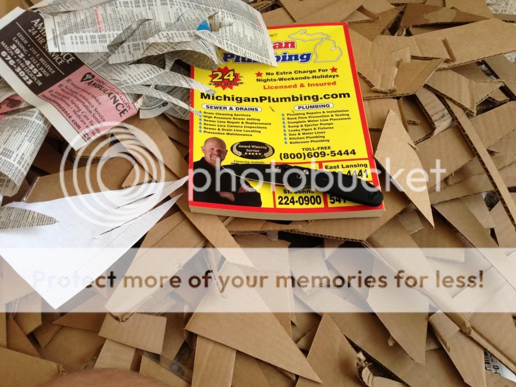

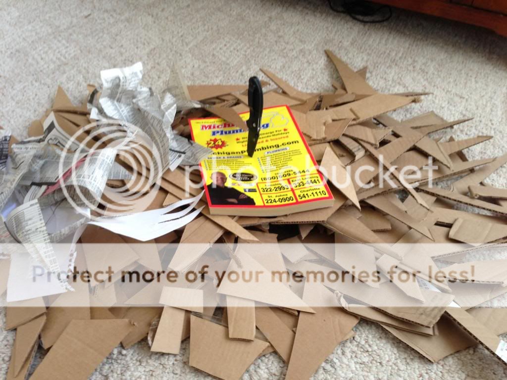

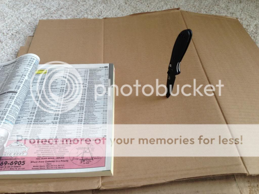

I decided to do my first formal cut test with the Mini Griptilian today. I had 10 large sections of cardboard measuring 21in X 24in. the 154cm blade had a factory edge touched up with the fine and ultra fine stones on the sharpmaker. The knife would cleanly push cut and slice phone book paper at the start of the test.
I decided to make 25 cuts per piece of cardboard making a total of 250 cuts.
25 cut's: The knife was still razor sharp and would slice and push cut phone book paper. I could not notice a change in sharpness.
50 cut's: The knife started to develop a toothy edge. It would still slice and push cut phone book paper.
75 cut's: The knife developed a full toothy edge and needed to cut slowly to cut phone book paper.
100 cut's: The knife started to develop a few roles in the edge. It would barley cut phone book paper.
125 cut's: The knife would not cut phone book paper. It can cut notebook paper if you are careful.
150 cut's: The knife barley cuts notebook paper.
175 cut's: The knife will not cut notebook paper. It can barley cut computer paper
200 cut's: The knife starts to slow down cutting the cardboard. it will not cut computer paper.
225 cut's Still cuts cardboard clean but slow.
250 cut's: End of test. Still cuts cardboard clean.
As you can see the 154cm held up very well for a mid level steel. I am very happy with the performance of the mini griptilian. this blade is an awesome slicer for being such a small package. The Benchmade black coating also held up very well! i am very pleased with the results of this test.

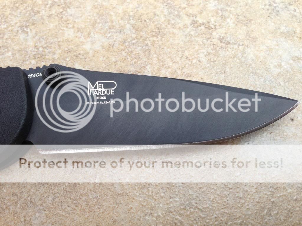

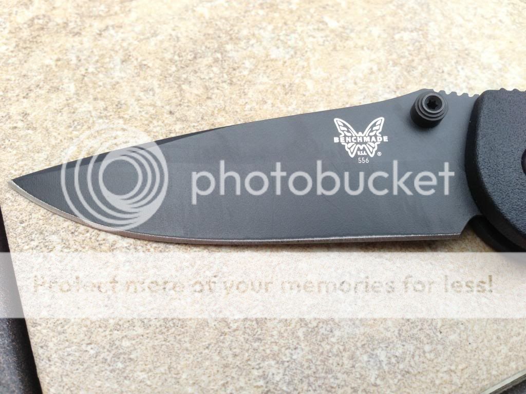

This is the end of my first week with the mini grip. I am still liking it a lot. I love carrying a 3 inch knife. It is so much more handy than carrying a large 4 inch folder. The knife definitely had a good first week. I used it a lot and it is starting to show some wear.
