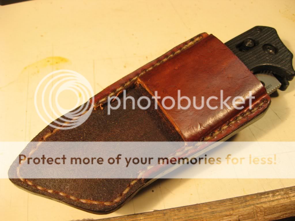

No pictures in this thread??? Ok, let's fix that.....
I agree, the Rukus is too big (for me) to carry in my normal spot: in the waistband. So I made a sheath that rides horizontally on my belt.
I kindly messed up the back of the sheath when making the loop for the belt, but it functions ok:

And that case above is amazing. Make it in black, put a price on it and I'll buy one from you in a heartbeat. PM me if you're interested.
Stretch...that sheath is awesome. Nice work. With the Rukus series, you are getting alot of knife for the money. G-10/Micarta, S30V steel. Shaving sharp out of the box. They are built like tanks and are one of my favorite blades.

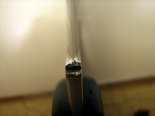

Its easy to see on spyderco's because the grind stops before the choil, you can visually compare the plung grind and this is how I found out my problem was not with my sharpening but with the knife.
The picture is of my delica and it was yet another example of a bad sharpening, when I first got it the edge angle was around 50deg, dull and unpolished. It was when I used my DMT aligner to cut the bevel back is when I notice one edge bevel was getting bigger than the other. After a long time of scratching my head and trying to adjust the angle to make it even I finally called DMT and they suggested that the knife itself may not be even. They were right and now that I look I find it more common. Its not a big deal but its something you will find if you use a guided sharpener.
As for factory sharpness I feel that its good enough to do work but I've only seen a small handfull of knives that I would ever consider sharp. I also sharpen to a higher standard and I don't think I have used a factory edge in 15+ years.
