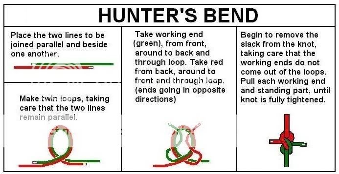

Having said that, I find that more and more I'm using the Hunter's Bend and the Zeppelin Bend. What determines which knot I use, is the ease of tying. Many years ago, I learned to tie the Hunter's Bend, but kept forgetting how to do it, because of the method I learned. More recently, I learned a different method, which is much easier to remember and it improves the knot immensely, for me. Below is the easier method, at least, IMHO.

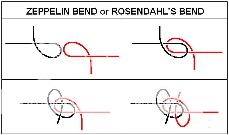

Brother Coote has mentioned before, of his affection for the Zeppelin Bend. I also used to find it awkward to tie and often forgot how. A newer method has greatly simplified the tying for me, and now find I use it quite often.
I do this by first wrapping the end around my left index finger. I then wrap the other end around my right index finger. I then place the loop formed around the right index finger behind the loop formed on the left index finger and proceed as in the picture above. I hope this made sense. :o

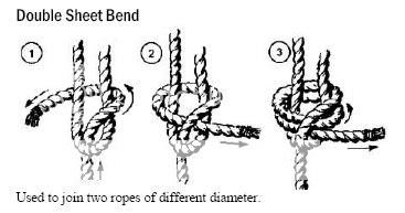

As for unequal diameter bends, I use either the Sheet Bend, Double Sheet Bend (less likely to spill) or if I want total security, the Double Simple Simon.
If you stop at step 2, you have a Sheet Bend. Step 3 is the Double Sheet Bend.

I use the zepplin (rosendahl's) bend a lot. I remember the structure by making a 69 with the working ends. He goes under then up and through. She goes over then down and through.
I also like the sheet bend for temporary low tension stuff like pulling a heavy line through an eye or over a branch with a smaller leader line. I also like it because I remember knots in families. If you take a rope, make a loop, then sheet bend the working end to that loop... you get a bowline.

I like the fishermans knot, excellent for 2 ropes or lines of equal diameter. The sheet bend is great too and easy to remember.

The Sheet Bend is probably the most used knot for net making.
