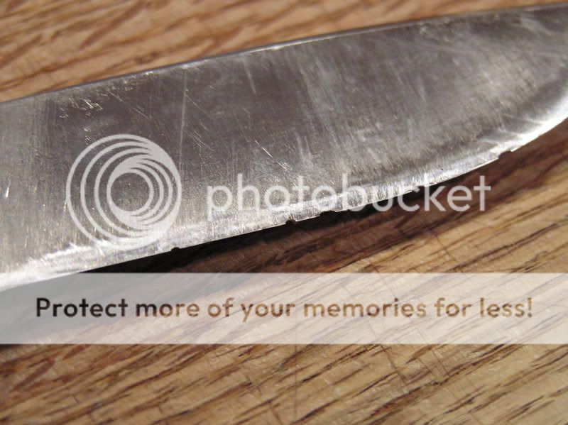

D2 is great steel when properly heat treated. I have experimented with thinning the edge, and when I get below 10 or 12 deg per side, this happens when doing twisting cuts in wood.
I put a microbevel on this, and removed the damage in 5 min or less. This Queen 4180 will go through cardboard and hold an edge almost forever, the microbevel doesn't slow it down one bit. This has to be one of the best knife deals in the world, no joke. It's one of my favorite knives, blows away many in edge holding, and was under $40.

sodak, that looks more like rolling than chipping. It's hard to tell at this angle but if you can't see the grains then it's rolling, if you can then it's chipping. If it's rolling then O1 or 52100 would have the same issue, you can't really blame the steel but the heat treat.
Or the guy who thinned it out too much... ;)

Absolutely, 100% my fault. I wanted to find the limit, and I did.
I really have to agree with Ken44. I could have left the edge fairly thick from the factory. It would have held up to wood, and been ok. It would have also been a little harder to sharpen because of the thick bevel. But still not as strong as a fine grained steel for hard, twisting, carving cuts.
So when it's thinned out, it *really* shines. As does ZDP 189, CPM 10V, M2 HSS, etc. You thin those out, and give them a decent microbevel for edge protection, that is really where they shine. Especially when they are run at high RC's, they have the strength to support the edge, and the edge holding properties really shine. That also makes them more single purpose than a jack of all trades, but steels like 1095 are better at being a jack of all trades anyway.
