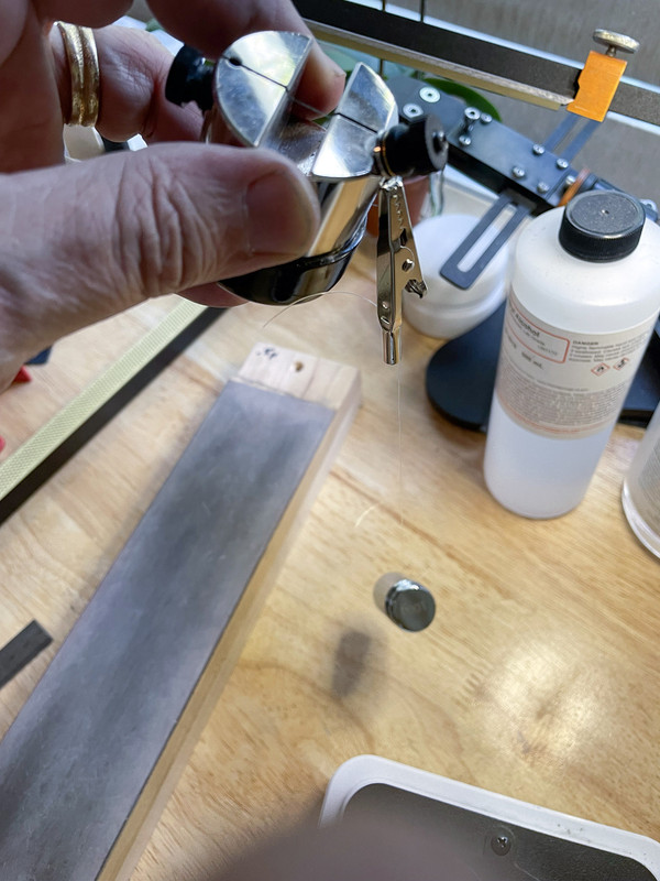

If you really want to geek out and take some of the uncertainty out of the BESS tester, the recommended pressure to string the filament holder is 100 grams:
