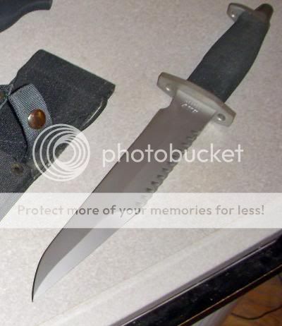

clw, is the razor carbon steel or stainless? if its stainless you can forget about getting it sharp. if its carbon you might have a chance.
I don't have a clue, after a while, I taped it shut and threw it away. No sense giving it to anyone else and didn't want it to cut the garbage collectors.
It really is the only "knife" that I gave up on.
