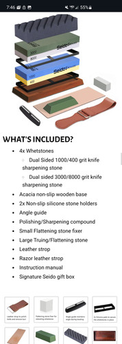

Would something like this work for a beginner?
I'm planning to get a boot holster and a few fixed blades to practice with to start. No matter how ugly I make them, they'll be in my boot. lol
First off, don't use or let anybody use a dry belt on your Magnacut blades.
Second, I suggest to start with a single good medium whetstone (600-800dpi), my favorite is the Spyderco Medium Ceramic. Will give you a slightly coarse edge that will hold and perform for a long time.
After a few uses, clean the stone with Bartenders Helper.
Start on a cheap knife, use Sharpie.
