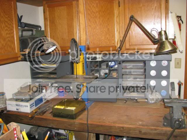

First let me say I don't do stainless. I have cut stainless with my bandsaw, but not that thick. This is what I use and what I recommend for most steels, as far as great bandsaw blade.
Lenox Diemaster 2 Bandsaw blades by Lenox Width 500, Thickness .020, TPI 18. I purchased two and I am still using the first one. I purchased some prior too the Lennox Diemaster from ENCO (their brand) and one of them made it about 2 1/2 minutes the other lasted a week.
Having said all that I do believe there is a break in period for any blade saw blade. In other word when first starting with a new bandsaw blade I let it heat up and cool down a few cycles before really going to town on it! You need to let the blade do the cutting, (don't force it). That only results in overheating and binding both of which will strip the teeth of one and then it all over.

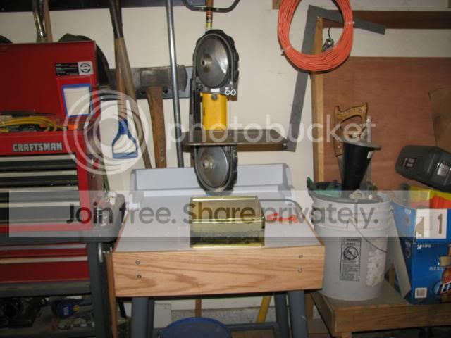

Even after setting up my bandsaw,
The bandsaw has been relocated to a table dedicated for its use. The new table has a different power set-up so no cords over the front to the foot switch and keeps that dust further from the assembly area!
