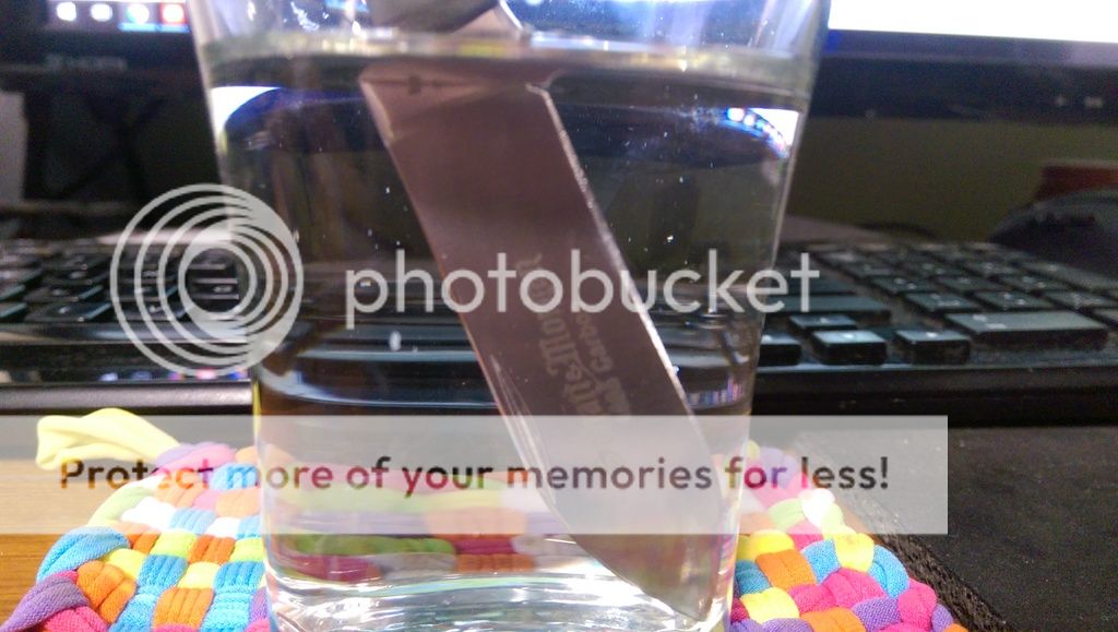

Then again, for the last couple of weeks I have been carrying a Schatt & Morgan that's labelled 1095 and it hasn't patina'd nearly as much as I had expected.
I've been carrying this knife every day since April 1st. I've used it to cut up apples, mangoes, strawberries, steak, all of the stuff that would normally leave a patina on a 1095 blade. It doesn't show any sign of patina. I got suspicious and put a drop of vinegar on the tang today to see if it would react. A half hour later there was no change in appearance at all. I decided to up the ante and submerge the whole blade in vinegar. It's been sitting there for a couple of hours now with no change at all. Just to make sure I wasn't delusional, I held a GEC 1095 blade in the vinegar for about 5 minutes and it developed a pretty dark patina. So, I know it's not some weird thing where I got a batch of eco-friendly, non-acidic vinegar or anything like that. :p
What are the odds that Queen accidentally put out a batch of knives labelled 1095 that were actually 420HC or something like that? I get that there are variations between different batches of 1095, but to show no sign of patina at all after 2 hours submerged in vinegar? That doesn't seem right to me.
I have found that the higher the polish the harder it is to get a good even patina. Try going over the blade with a scotch brite pad, cover it in a light coat of mustard, and leave it out so it can get plenty of air. If you wash it off after an hour and don't have a patina, it is most certainly 420.
I'm betting it's stainless. At least the edge bevel would be dark, as it's been sharpened, and certainly without polishing.
I'd say 100% by the looks of things. Perhaps some more folks will chime in with the same issue now that you've addressed it.
I shot an email off to Ryan Daniels to see if he could offer any insight. I'll update here when I hear back from him. Thanks for your responses. I wanted a little confirmation on what I was seeing before I went back to Queen and accused them, even if politely, of marking stainless steel as 1095.
