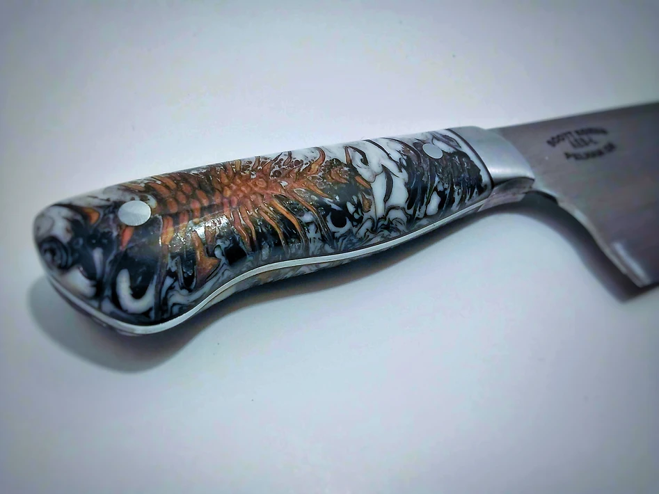

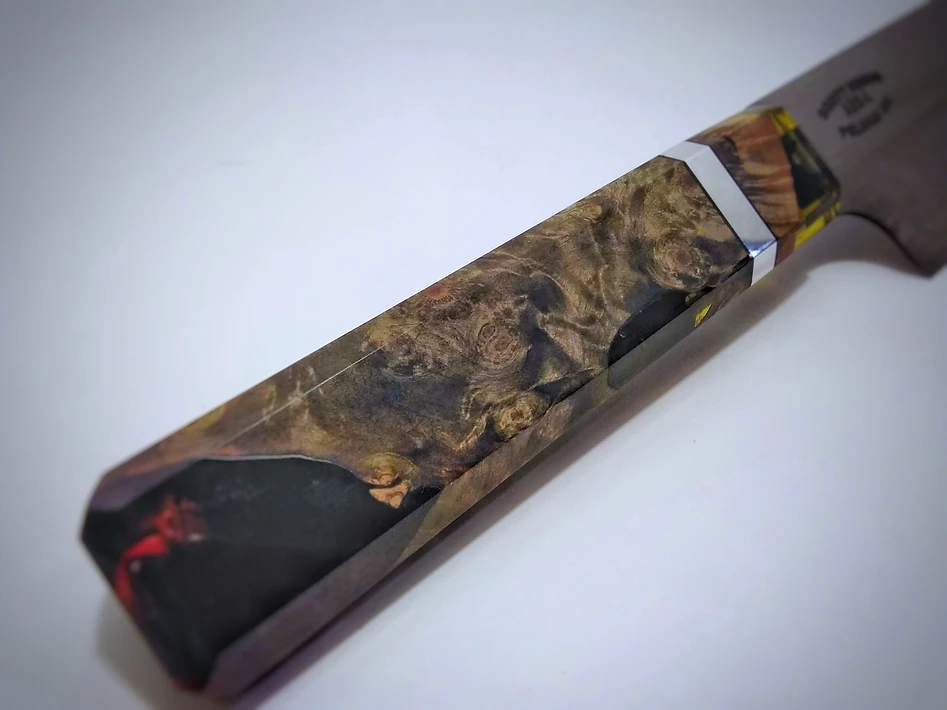

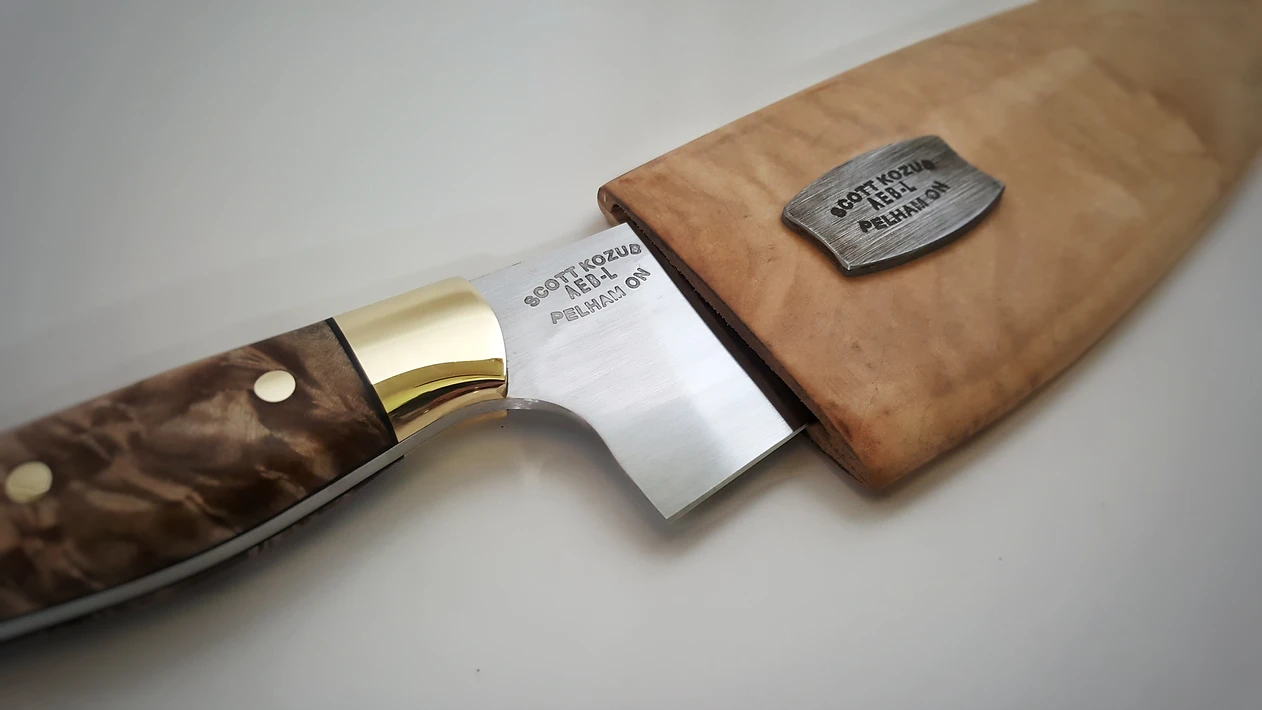

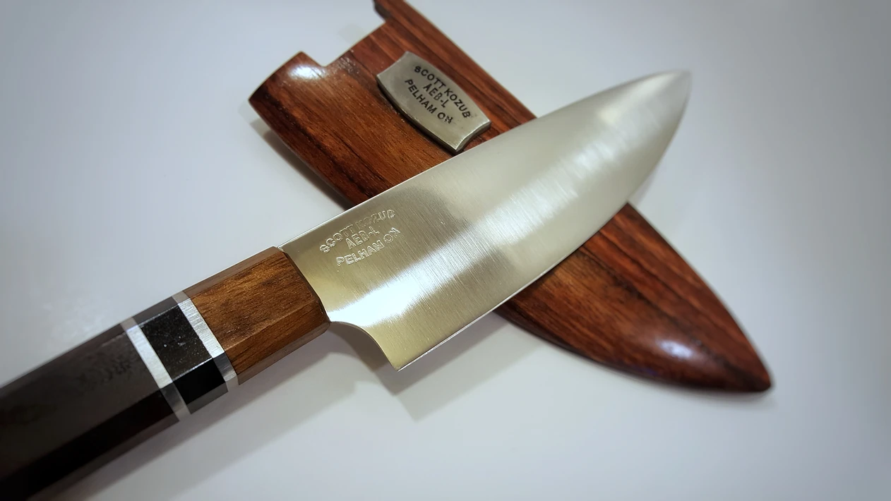

I have made a whack of nikiris in they are wonderful for vegetables but not very versatile. There are plenty of guys in the makers forum that do integral bolsters and will make you a one off custom. You get the advantage of thin geometry, great steel of your choice and heat treated and tailored for your desired hardness with endless options if you go custom. I'm a stock removal guy so I can't help you with integral bolsters but there's a great group of very friendly makers there. Here some examples of my work to get you thinking about the possibilities.
A great stainless steel in the kitchen is AEB-L. It is extremely tough and doesn't form large carbides so it can be sharpened nearly as keen as carbon steel. The toughness of this steels allows a maker to run it hard and thin without the edge being chippy. Its also an inexpensive steel because it's used for razor blades so the economies of scale are much greater than any other knife steel. You'll likely have to go custom to find it though. Below is a testing video I did on a Nikiri (before mounting the handle). This blade is just 0.002" thick behind the edge heat treated to 62HRC. I eventually chopped through the entire 2x4 with no chipping or rolling damage. Steels that form larger carbides will excel at edge retention but won't get as sharp and you risk carbide tear out at thin geometries. This knife is the 2nd picture above.
Every steel will have advantages and disadvantages. Depending on the use, most makers will vary the hardness and edge geometry to get the optimal performance. One thing with most production knives is that they are usually a couple points low on the optimal hardness and thick behind the edge. Its done this way so they don't have to worry about warranty claims for chippy knives but there is performance left on the table. To assume that a harder knife is a chippier knife is a misnomer. AEB-L at 62 HRC will be noticeably tougher than CPM S35VN at 59 HRC but the S35VN will have better edge retention even at the lower hardness. Seems counter intuitive. Every steel is different so you have to make sure the hardness is matched to the geometry to get the optimal performance. Don't just buy a blade thinking a higher HRC number is better.
https://www.instagram.com/p/B8mugvdHcBR/
