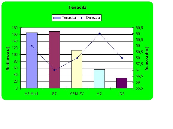

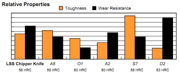

what do you guys think about a8 ? in these graphs there is controversial info about its toughness . one is very high ,on par with s7 ,the other one is way below s7 ...?
To make real comparisons, they should all be tested at the same HRC+/- .5
The first graph compares A8 with other steels, the second graph shows A8Mod, so I’m not sure its the same steel. And, as mentioned above by Danbot, it’s not the same hardness either
