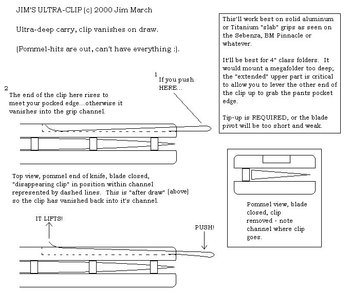

How about a clip that vanishes on draw?
Like so:

---_______________
---|o o (======) /
---|o o (======)/
TOP VIEW
_______ _______;
\_________|
SIDE VIEW
THIS IS WHAT I FEEL WOULD BE THE PERFECT CLIP
