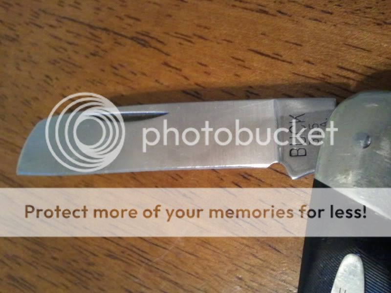

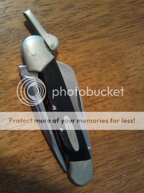

Oh, and for your viewing pleasure...
-Xander
Way to go, Xander! What a great knife!
Unless someone holds one of those in their hand, it is impossible to tell someone how sturdy that knife is built. After all the spike is made to pry open knots. I had one of those for a while, but didn't ever use the spike so I sold it. What a dummy.
Robert
