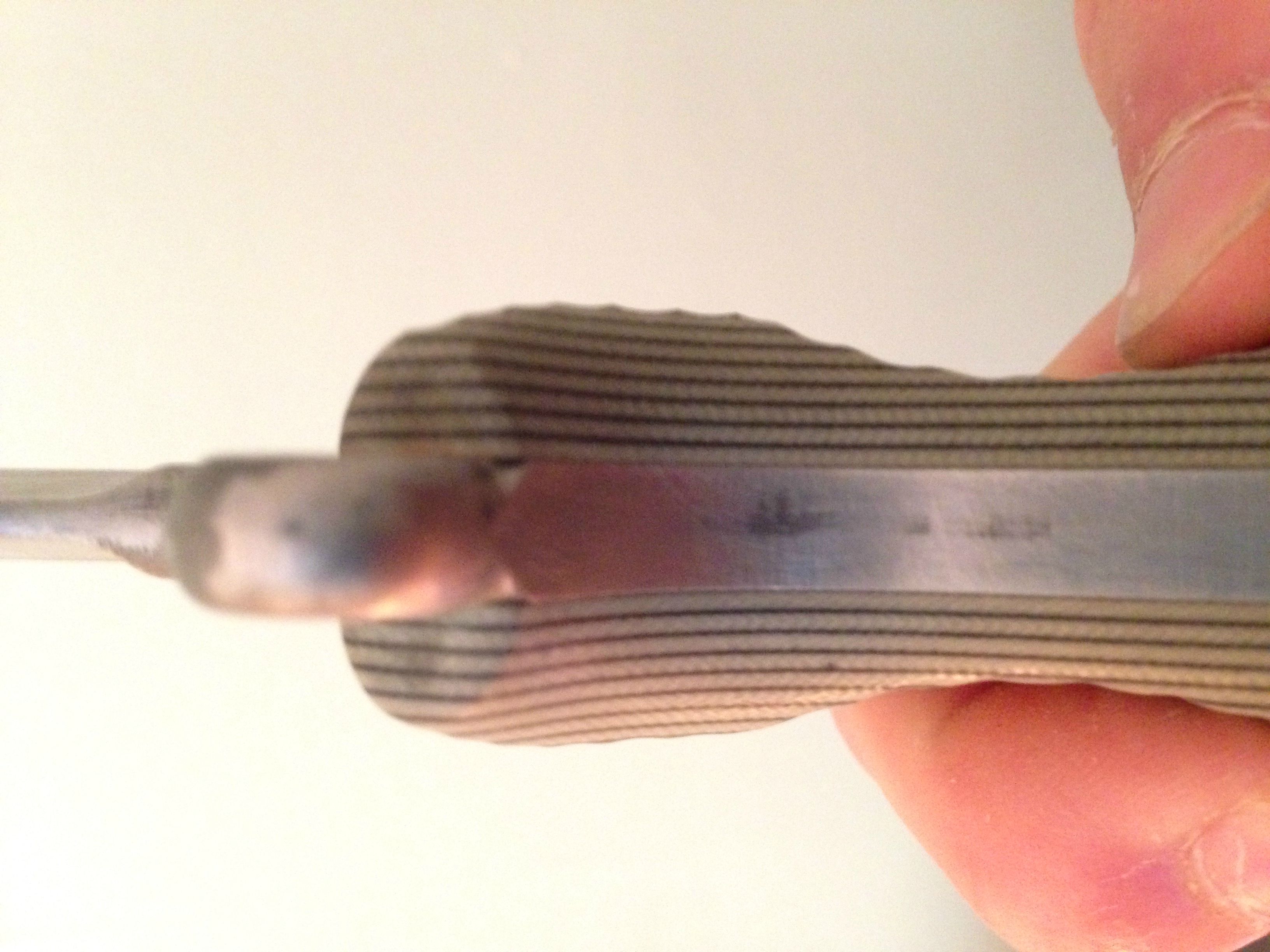

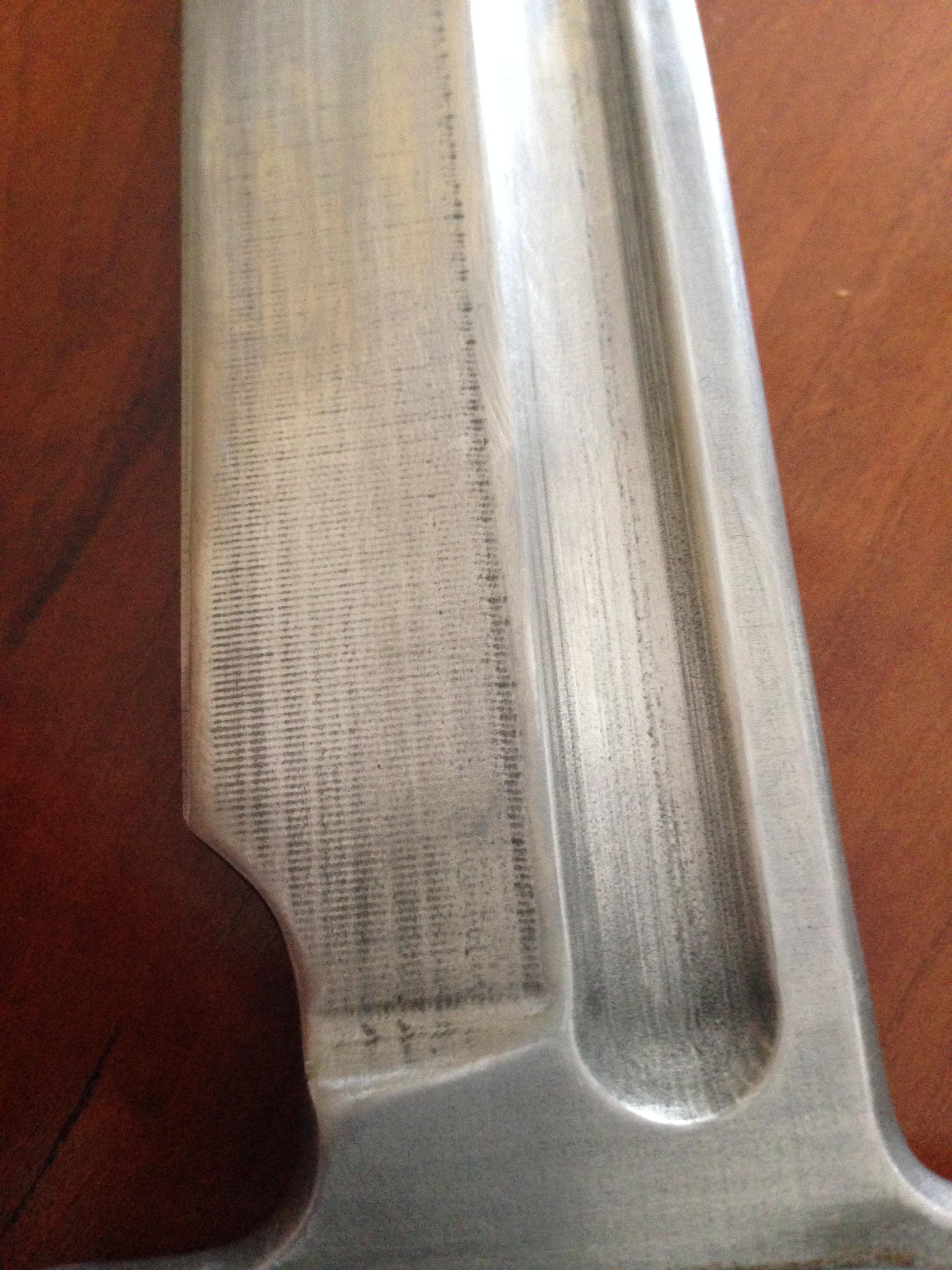

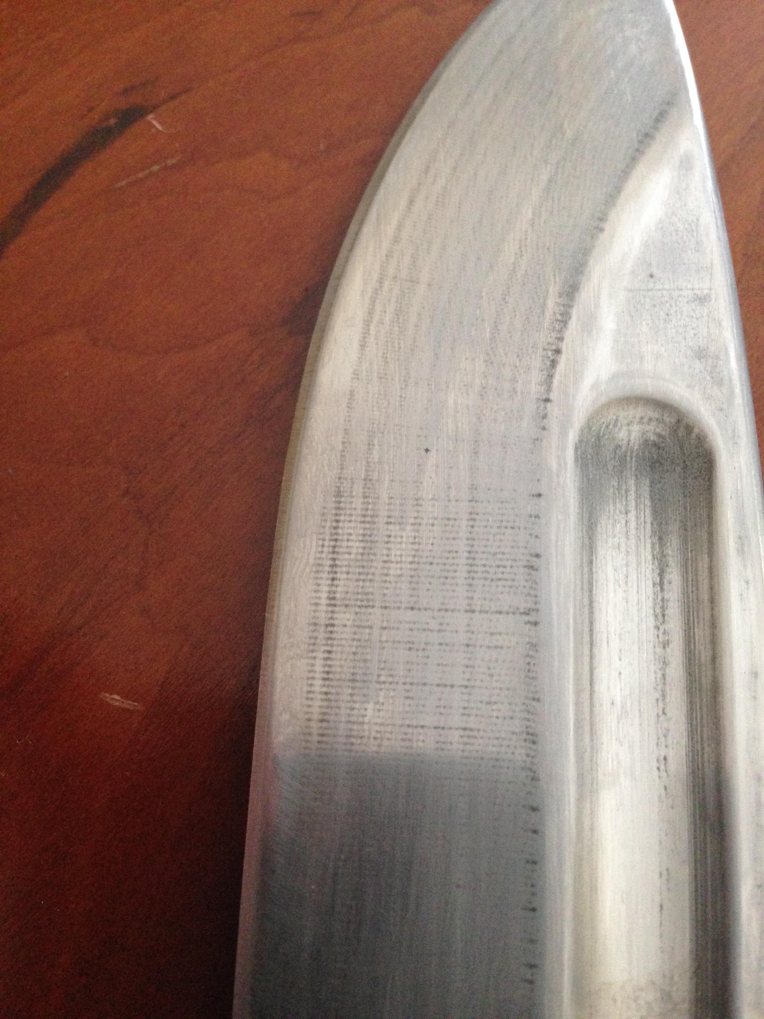

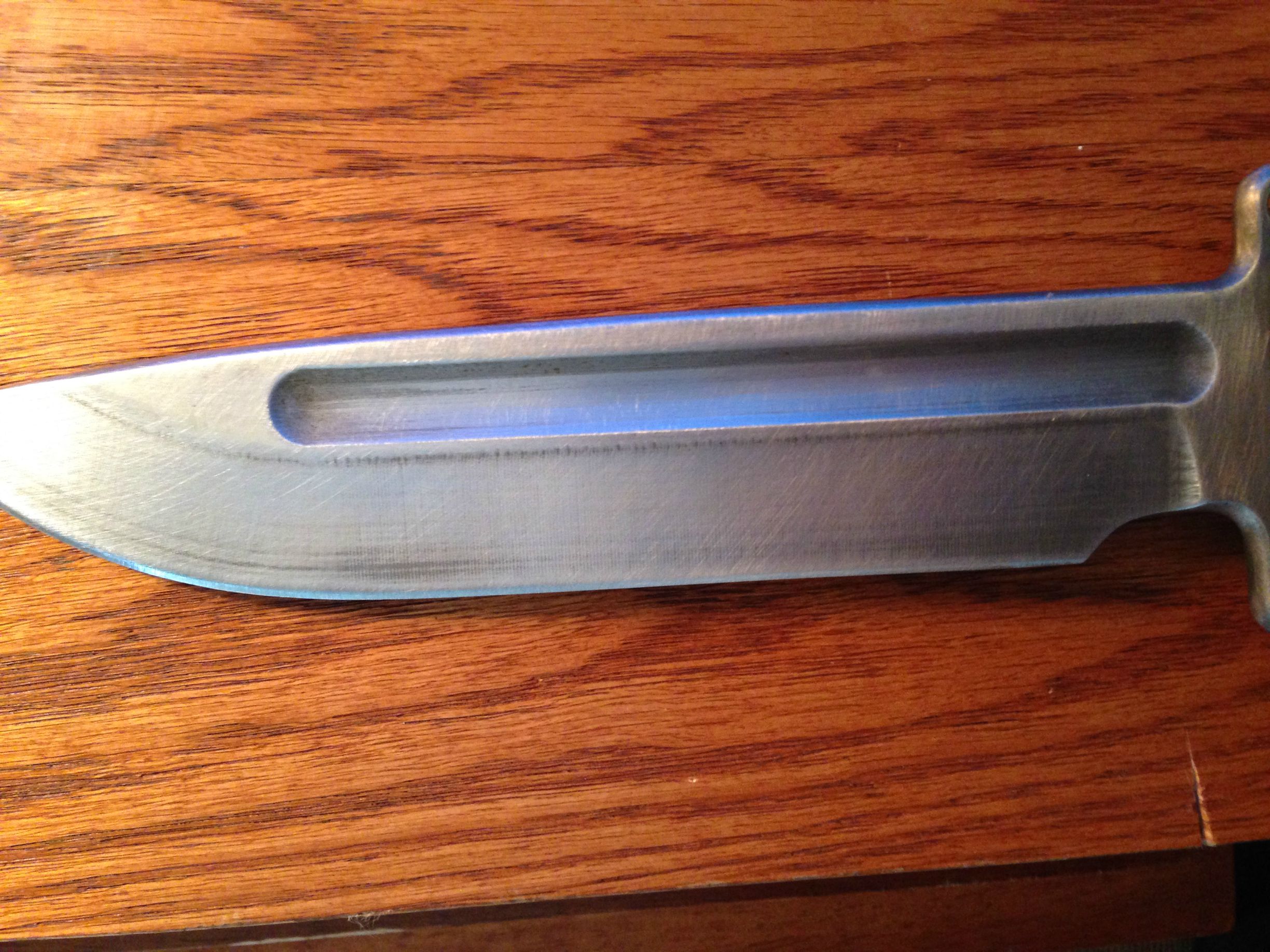

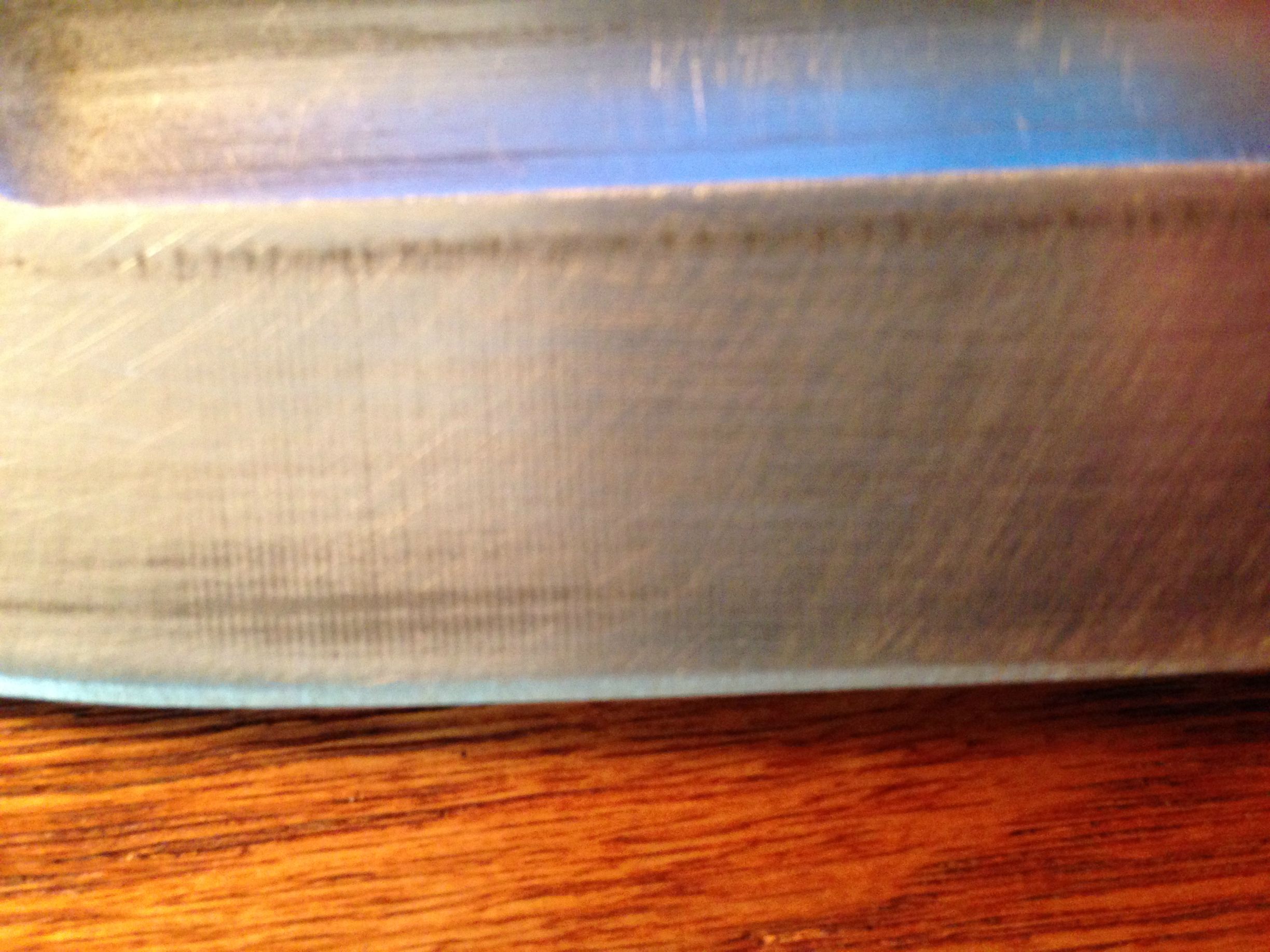

I got what grits were suggested and got to work. I'm now out of sandpaper, and this is the end result. http://imgur.com/RxrDM80,tiUUdWg,Q3Yfseq,hqJuwJy#0
It still isn't all gone, and the area around the tip is wearing down, so I'm getting nervous about continuing. Any further tips for me?
You can either stop, or keep going.
I don't know if I'd call that decarb
The problem is they use that thick coating to hide bad metal finishing
I'd go back to 120
If you want a nice finish, you have to get it all down below the black marks.
Make sure you use a hard backing stick like Nick Wheeler shows in his hand sanding videos
Make sure you're using metal working abrasive cloth or paper, not sandpaper for wood
