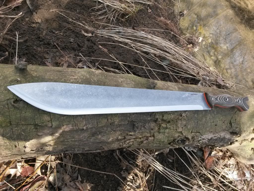

I haven't test them against every machete out there but the ones I make are pretty good :)
.108 thick 52100 with a 58RC edge and spring tempered spine. Its a whole different animal than any machete I've used.

What an excellent machete ! I truly admire your work . You wouldn't happen to make these in 1095 carbon steel by any chance ; would you ? Or 440c ?
Spring tempered 52100 is kinda like 1095 on steroids. You're asking for a step down the quality ladder ;)
I got to play with on of those at the Beckerhead Spring Gathering this year, awesome 'chete. :thumbup: It was identical to the one with purple G-10 and the finger hole. :thumbup:
