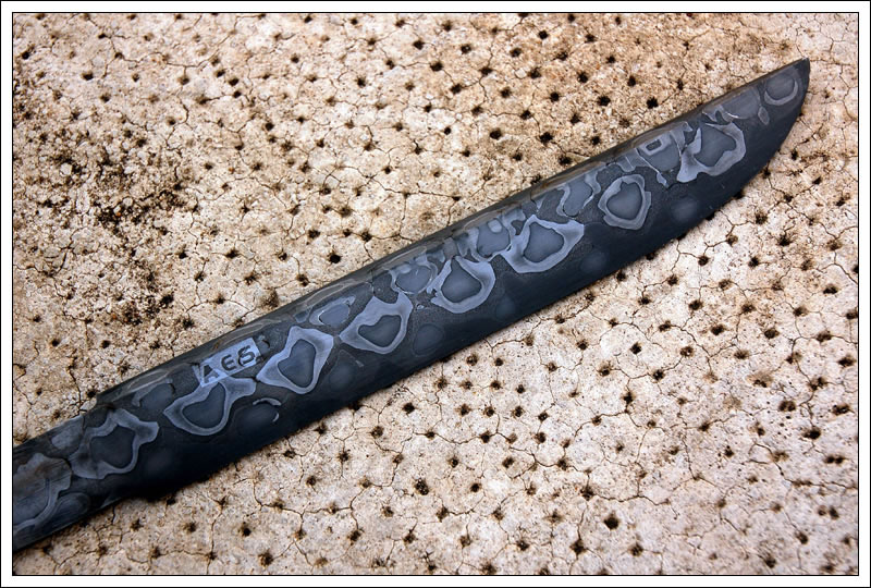

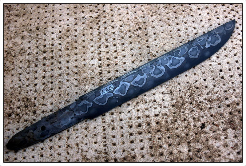

Some of you will remember this blade I finished about 2 months ago.
It's for a customer in Israel that wanted something like this one.
If you want to see how I made this one, check out this page:
http://www.aescustomknives.com/docs/knifemaking.htm
But gave me free reign on the creative aspects of the project.

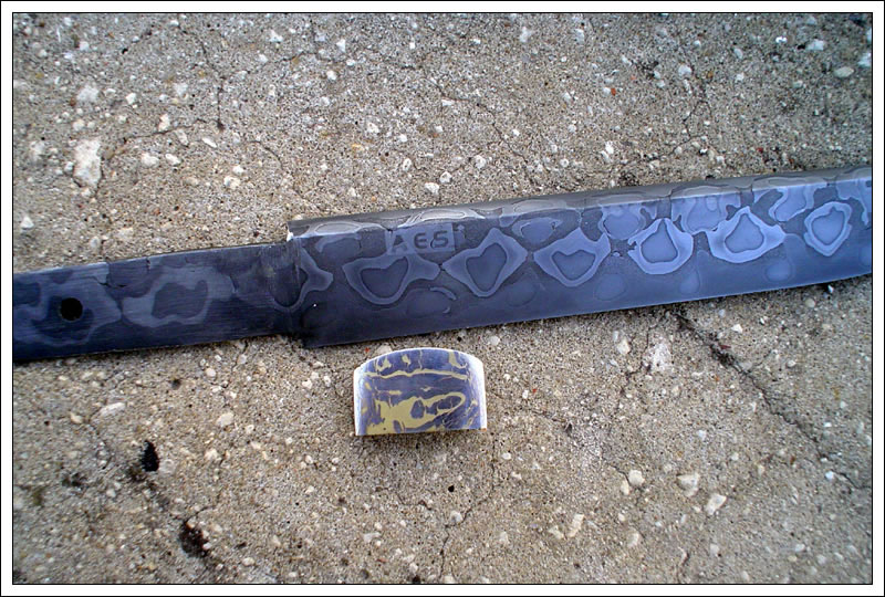

This is what I have so far (I'll get much better pictures once I finish the wooden scabbard)

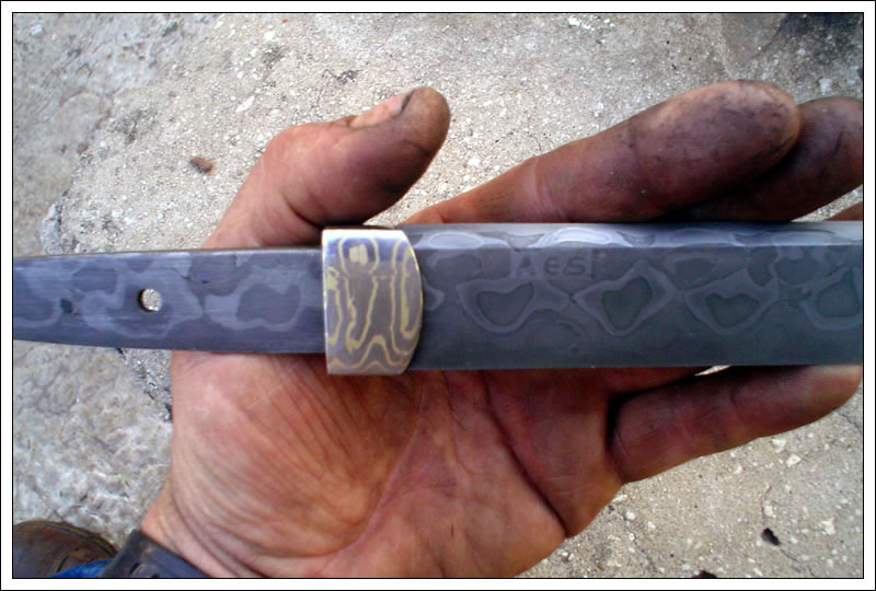

Bronze/stainless mokume habaki
On the blade

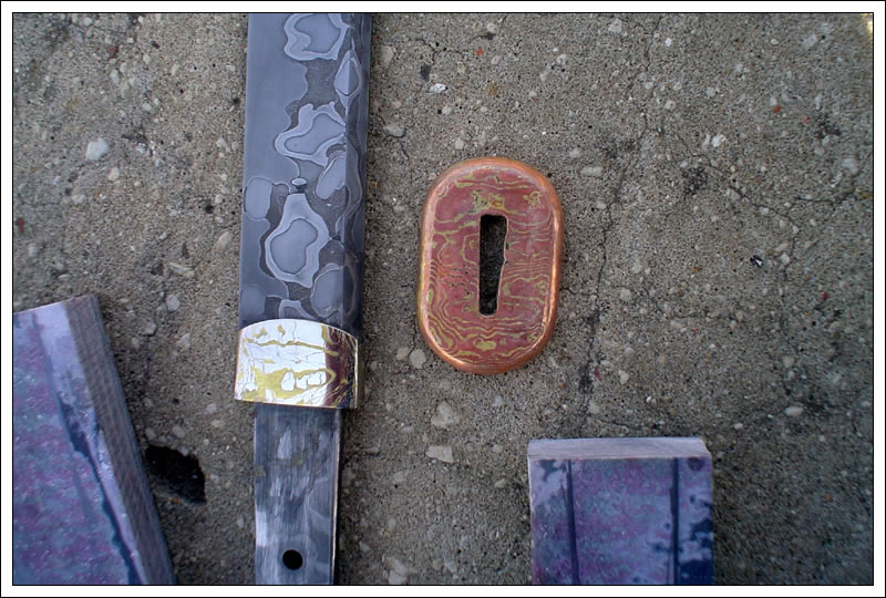

Bronze/copper mokume tsuba and future micarta handles
All future tanto parts

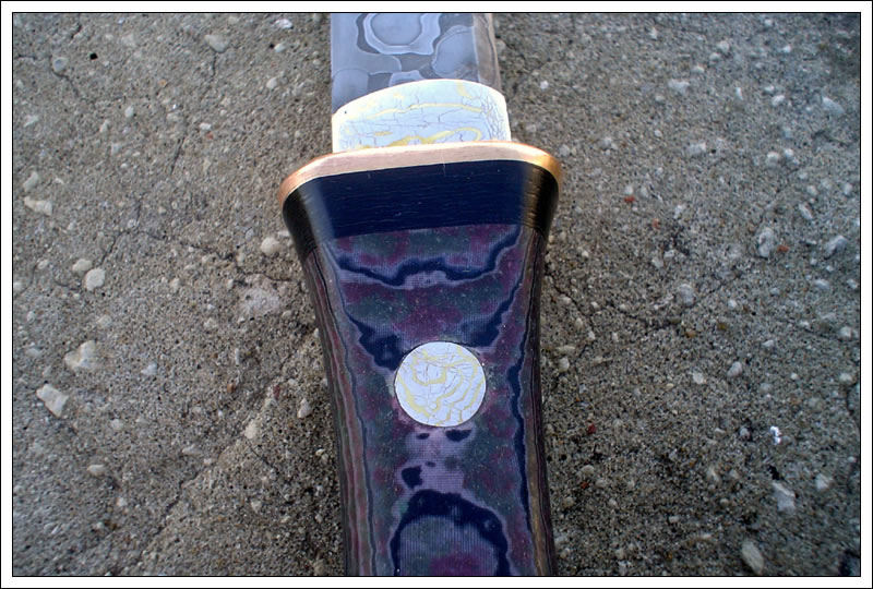

Habaki and tsuba on the blade
Ariel,you are one of the most talented and imaginative makers there is out there--Beautiful work-:thumbup::thumbup::thumbup:-Butch
I love it. About the only thing I would want different if it was for me, would be a different color handle material. Either wood, or subdued earth tones micarta if it was going to be a user. That blade pattern and the Tsuba etc all have enough great colors and patterns in it. That is one lucky customer.
Very nice work. The original one always caught my eye, but this one is outstanding especially given the detailed work on all the fittings.

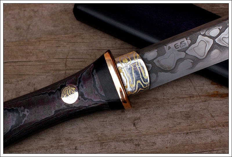

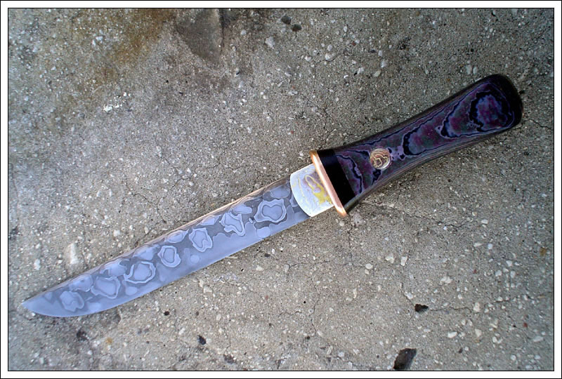

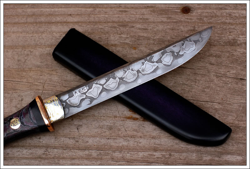

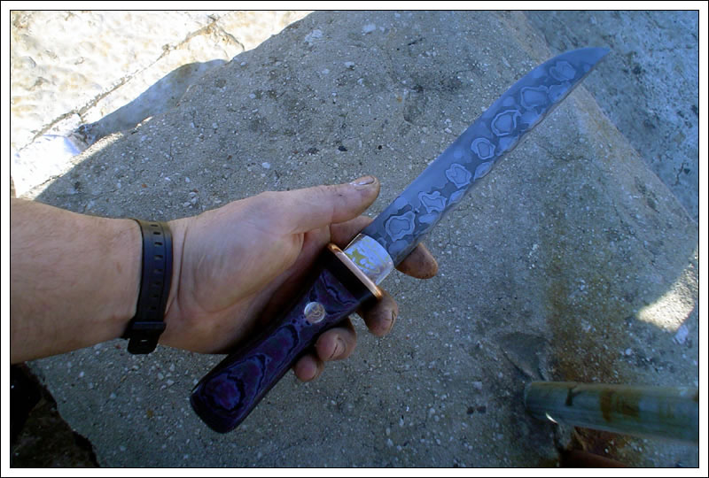

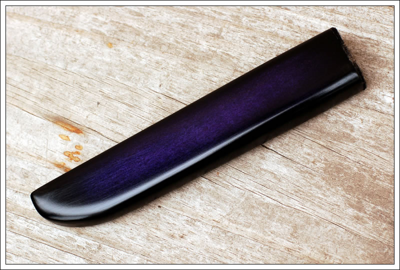

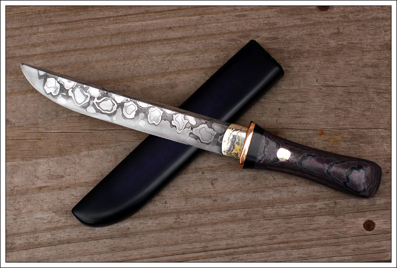

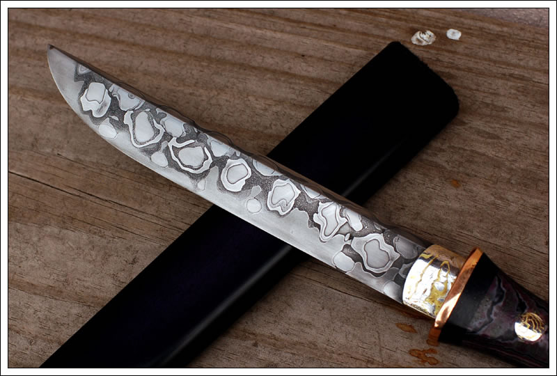

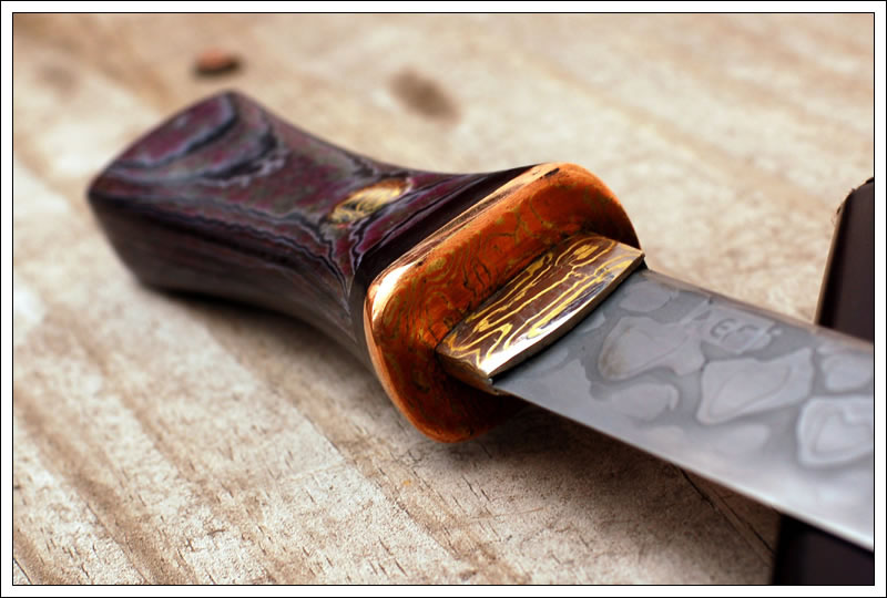

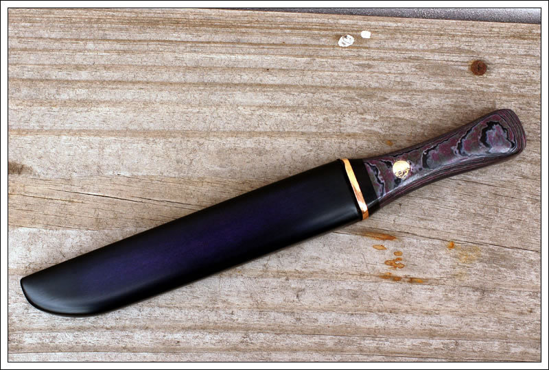

So I finished it :D
San mai damascus from a motorcycle chain with a 5160 core.
13 3/4" overall length, 8" cutting edge, 8 3/4" from tip to tsuba. 1/4" thickness. Hand made micarta handle. Bronze / stainless steel mokume habaki and decorative pins. Bronze / copper mokume tsuba. Dyed and lacquered maple saya.

that is a very nice knife!:thumbup:
Well done:)
