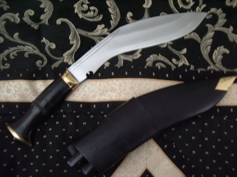

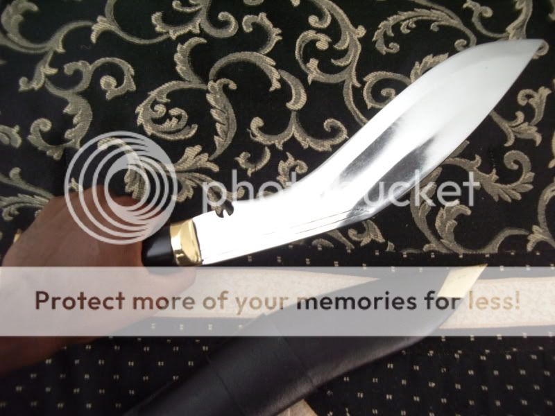

Thanks for all the advice guys :) . I ended buying an AngKhola off Ebay, from the only person selling angkholas, for $75 shipped, though I'm unsure of where it originates from (am I allowed to link to ebay auctions?). It's a 17" kukri with a 10.5" blade, 3/8" thick. I just got it today, and I must say it looks like a mighty fine knife. I can tell I would've been better served by getting one with a wood handle instead of the black buffalo horn. My tendency to have sweaty palms might necessitate amending the handle with something that provides better friction/grip. The blade is solid and it came pretty sharp. However, I don't think it's razor sharp, though I've never had one of these before to be able to tell what level of sharpness it should have. Sharp enough to cut through paper with just a little pressure, but not sharp enough to taste my blood yet I don't think ;) .
The weight is also no problem for me. It's actually a bit lighter than I expected it to feel. I certainly wouldn't want the blade to be any shorter. So does anyone have advice on how sharp this thing should be?
That AngKhola doesn't look too bad from a fit and finish perspective, but that could be the resolution of the images. It's a bit short for my tastes, but I'm not surprised it's lighter than you expected from the length and blade thickness you described.
Assuming it has been properly zone hardened in the traditional way (assumes this isn't a tourist model that will simply not take an edge), you should be able to to use medium to medium fine-cut files to get a good utility edge on it. I favour the half-round files and the more expensive diamond rough cut or medium cut hones that are no more than about 1 to 1.25" wide and approximately 6-8" long. Whatever you use, it must be fairly narrow or you will not be able to follow the contour of the edge closely enough.
If a typical file (a fresh new file) won't do more than skim across the edge at the widest part of the belly of the blade, you have a well hardened blade and will need a harder file or diamond hone to shape the edge. The average half-round file with a hardness around HRC 60 will just skim the surface of the edge without really cutting it. It will be easier going towards the point where hardness will be around HRC 55-58 and the heel of the edge nearer to the cho (choil), also in the mid-50s range. The file should cut readily at the spine of the blade, which will tend to be around 30 HRC.
Half round files, assuming they are hard enough to bite the steel work very well, the smaller variety are 6-7" long and less than 1/2" wide and come in course, medium, medium fine and fine. A quality set of files with a slightly higher hardness of around 64-65 HRC will be required to remove metal from the edge, or you'll have to use a diamond hone which cost even more.
Depending on just how dull it is and how aggressive the cut of the file or diamond hone you use, you should be able to achieve a reasonable utility edge in 20 minutes or so. If it is completely edgeless, it could take an hour.
When you have a edge that is sharp enough cut 20 lb. printer/copy paper and is smooth when drawn gently over a fingernail (without the full weight of the blade), it should be good enough for typical camp chores without constant touching up.

Yea, I plan to get it fully sharpened "professionally" tomorrow if I can. I'm sure the one doing the sharpening will be able to tell the quality of the steel, not that i doubt it at all. Some say it might be from Khukuri House (the lack of initials/marks says its not from HI), in which case I think I got a good deal from a quality source, who was apparently working with HI at one point(?) . I can't wait til the blade is prepared so that i can test what this thing can do. My next kukri will certainly be a larger one, 20" or more, near short sword length :P . This 10~10.5" blade should work nicely for my purposes though, especially when carrying it on backpacking trips. I'd rather carry around something at least a little closer to knife size for weight and appearances. I doubt any people I might encounter would hesitate to show fear if i showed up with a large sword sized kukri hanging from my belt :P .
It could well be a catalog knife from KHHI or KHT (both companies are owned by a pair of brothers, similar models and as far as I'm told, share at least some production facilities, some of the time).
