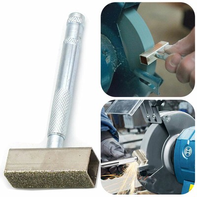

I'm not familiar with what a belt dresser is and how it works, does it bring out new abrasive?

It is a bar of abrasive material that fractures the glazed grits and exposes new sharp edges. The easiest ones are a sintered diamond bar.
You press it firmly against the running belt and let it work on the abrasive. They are used the same way to dress a grinding wheel.
I have been wondering what this tool was called so I could get one. I remember a spinning version from back in shop class. How long do they last?
The wheel type was a stone wheel dresser. The diamond bar type will dress a wheel as well as a belt. They last a pretty long time. At $10 each, if it lasted four belts, it would have paid for itself twice. I think I have used up two or three over the years. I first bough a good one from an industrial supplier for about $50. It was a solid bar with a solid handle. Then I tried the cheap lightweight import one and it is just about as good for what we need.
