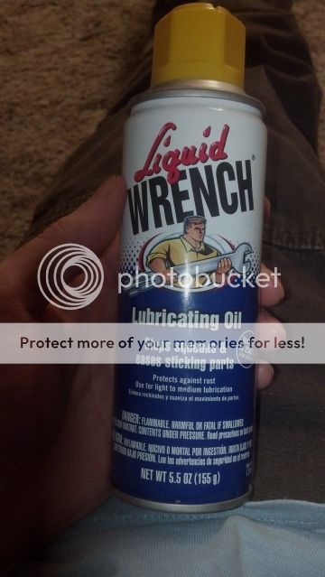

best lube for leatherman?
Yes? No? Maybe so?
go for it. the main concern with using light penetrating lubes, like WD-40 is that they dry out, so if you need a lube there, you'll get wear.
any time you switch oils, there is a risk that you'll get a reaction and gum things up. SCIENCE!
(First Post!)
WD-40 is a lubricant but it is also a solvent and will tend to break down any existing oil on your equipment. If food contact is not a concern, try Fluid Film, a migrating non-solvent, lanolin based protective and lubricating liquid. A little on the end of a Q-Tip is all you need. It works.
