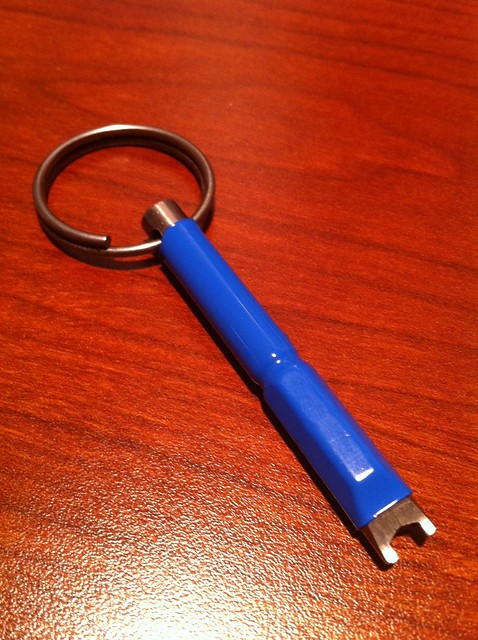

It's different, the hinderer is a lot more narrow. As I mentioned earlier go buy yourself one of these and if you're somewhat handy with a dremel you can make yourself a strider and hinderer tool in one for $5.
Strider side:
Hinderer side:
I padded it with a rubber lining and then wrapped it with tape so I can just hold the tool against the scale while I unscrew the pivot screw.

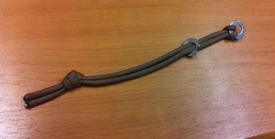

Until the day that I have my hands on the holy grail, an armorers tool, I'll have to make do with this -
A couple of stainless washers and paracord.

That I haven't seen yet and that is really cool, a great idea that I may also have to give a try.
