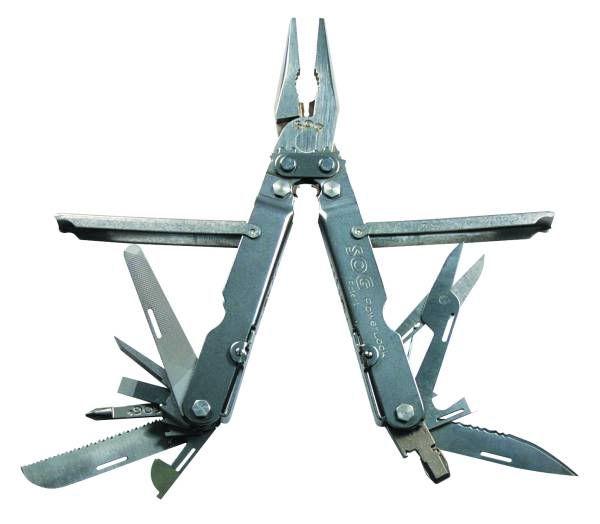

......Seriously, have they checked Powerlock? It is big, heavy and can be flicked open........
Okay, we've got a family get-together planned for Labor Day weekend. Both Mike and Paul will be there. I'll bring these three multi-tools (along with PLENTY of food) and have the guys check them out.

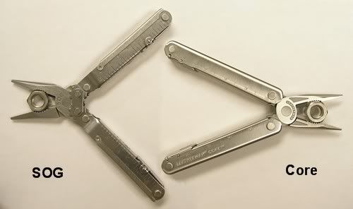

I brought along the three multi tools mentioned above. Mike's new Leatherman Core was hanging at his belt for comparison. In between beer, potato salad, and horseshoes, I had the guys check them out. Making sure not to influence anyone's opinions, I kept my comments to myself. (Not that it mattered; they never listen to me anyhow. :rolleyes: )
So far, Mike is pleased with his Core. At first he didn't like that it was thicker than his old Super Tool, but he's already gotten used to that. On the plus side, he's REALLY happy with the locking mechanism. Now that he can unlock a blade one-handed with his Core, he wonders how he ever made do for so many years with the clumsy Super Tool blade lock.
I showed them my SOG PowerLock, and pointed out how it uses the same principle for a blade lock as the Core. Neither Mike nor Paul liked the flappy handle guards, and one of them pulled both guards off before I could protest. (#&%$!) I've read different reviews before that complained about the sharp gear teeth on SOG multi tools, but neither guy thought they would be a problem. Paul liked the size of the tool, which was the same as his Super Tool 200, and liked that his big fingers could pull the blades out okay. Other than the handle guards, his biggest complaint with the PowerLock was in regards to the jaw opening size. He noted that in order to grab onto an object bigger than about 5/8" diameter, the plier handles would be so far apart that it would be difficult to squeeze them properly. (see photo) He makes a good point.

...I've read different reviews before that complained about the sharp gear teeth on SOG multi tools, but neither guy thought they would be a problem.
I thought that too. I used to think "oh, cry me a river!" when reading of people complaing about the gears. It didn't bother me, until I have to loosen a really rusted screw. I normally open the handles 180º to screw things, but to remove this rusted screw, I closed the handles and tried to put my weight into it. Holy crap! the gears DO hurt!
JOOLIESEWS said:
...his biggest complaint with the PowerLock was in regards to the jaw opening size. He noted that in order to grab onto an object bigger than about 5/8" diameter, the plier handles would be so far apart that it would be difficult to squeeze them properly. (see photo) He makes a good point.
Paul beat me to it. I was actually writing up a review of my tools, and my 2 biggest concern with SOG is that the tools all gang together, and that the compound leverage is only useful for thing or small objects, because if the jaws of the SOG are opened to grab a larger object, the handles are so far apart that it makes it almost impossible to put any real "grip" into it.

Really! I agree. If SOG had non-ganging, OUTSIDE opening tools (this would also eliminate need for the "guard"), and perhaps handles that curved in (like spirit), so that it would alleviate some of the jaw open vs handle travel problem, I think I'd not want any other tools. Oh yeah, and make the base portion of the phillips driver slimmer. Hey, I guess it doesn't end...
