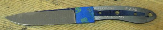

Here's a tip that I figured out on my own:
Use painters tape to designate your desired location of plunge line before starting to grind the bevels. This makes it real easy for me to keep the plunges aligned properly on both sides of the blade. The tape serves as a visual "stop" and an alignment tool while grinding at the plunge line.

Mike, I do that too and even wrap it several times around to form a soft stop in case I bump against it. I probably don't need to do it anymore but I do it every time and my plunges look pretty nice....just like yours. I really like your knives by the way. I think we have similar tastes and I check your site often to see what you have made . Larry

Mike, thanks for this. I put this in play today and got the best plunge lines by far, so far. This really helped me focus more on other things and was a good visual reminder every time I got close to the plunge line to pay attention and straighten up. :)

I'm glad that I could help you a bit. I ground 7 blades this weekend, and the tape trick is my saving grace on each of them.
